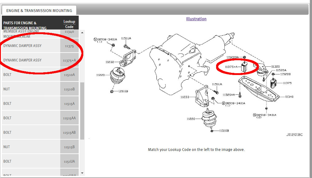

Interesting...
Could that rusted doohickey on the left be one of them?

From: Charlotte, NC
That looks right. I didn't notice one on the passenger side though, and mine wasn't rusted like that.

Now that you're reposting that pic, I'm reminded of the WTF-is-that? reaction I had when you first did this.
I would have to get back under my car to look, but I don't recall seeing anything like that the last few times it was up on the lift. When I saw that picture, I just shut up thinking it was maybe something different between the VQ35 and the VQ37.
That's a damper? Like how? What kind of material is it? You'd think if it was a solid damper, then it would be rubber... like the shot-glass sized rubber dampers on the OEM exhaust.

Adding mass will change vibration frequencies. Can't tell if it's for passenger comfort or trans case longevity.
It's hidden by the transmission crossmember, so it would be easy to miss.
True... My G37 has the "dynamic damper'... this is a steel mass connected to some rubber that is designed to vibrate/oscillate 180 degrees out of phase, which cancels the vibration of our large displacement V6.
