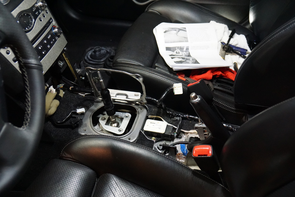

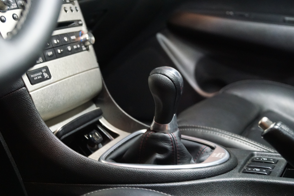

In other news, I installed the TWM STS on Sunday. Took me about 2.5 hours, but that's only because I like to take my sweet time. Here are some pics:

The TWM instructions were spot on. Nothing in the install was difficult, but there were a few items that took longer than expected. Some of them were:
  • Unplugging 3 connectors underneath center console
  • Removing shifter cup from oem shifter pivot ball
  • Removing/reinstalling shifter rod boot under the car
  • Replacing shift boot

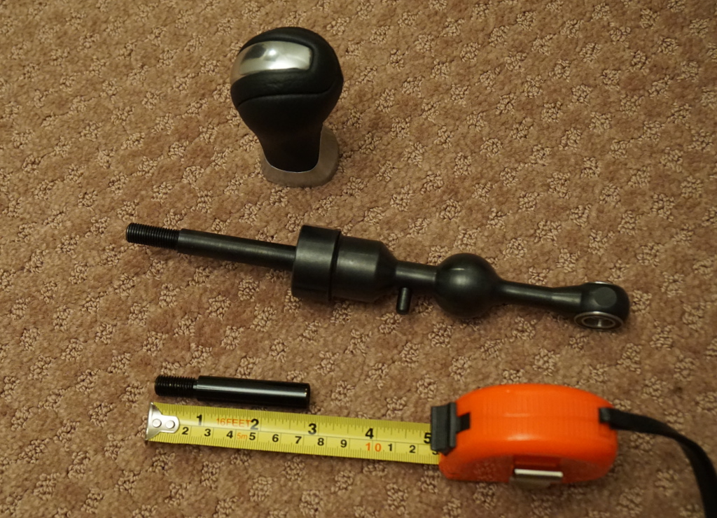

If you've been following this thread, you'll know I purchased a shift **** extension from eBay:

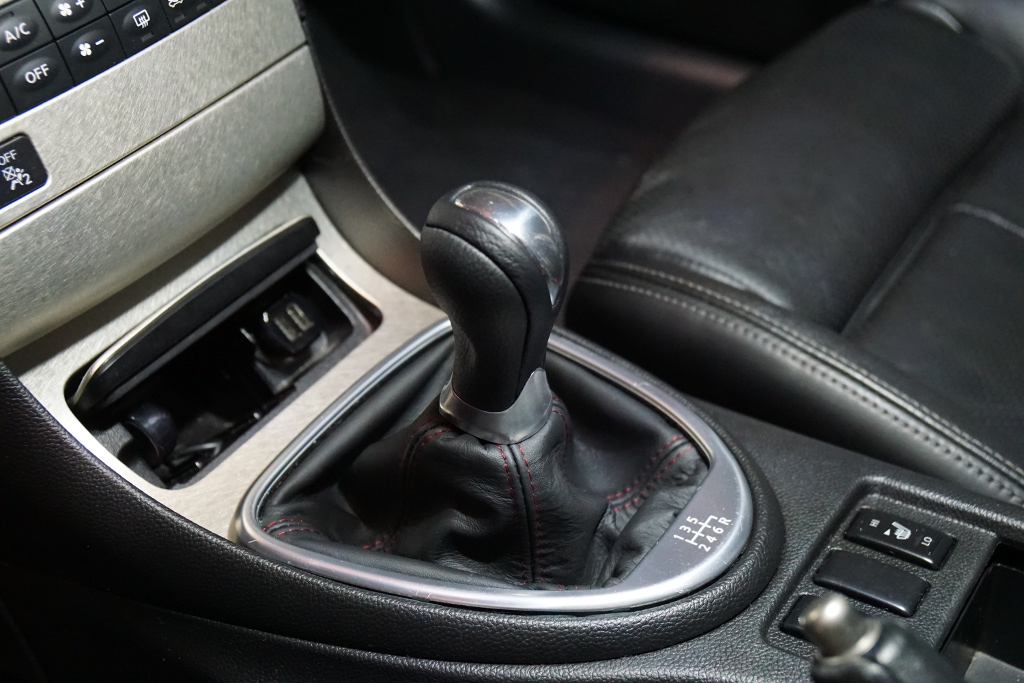

The height is perfect IMO. It's probably higher than stock; I didn't take any before/after pics. But, the throws are still ridiculously short.
I still need to tweak the fitment between the shift **** base and shift boot.
I'm absolutely loving this STS! Throws are short and crisp. Shifting effort definitely increased from stock, though. I need to apply more force when rowing gears, but the short throws don't make it a chore. Now I know what it means when automotive journalists describe a shifter as "snick-snick".
In summary: the combination of the Southbend Stage 2 Daily Clutch, Z1 Nodular Iron Flywheel, RJM Clutch Pedal, Vibra-Technics Transmission Mount and TWM STS equals driving bliss.

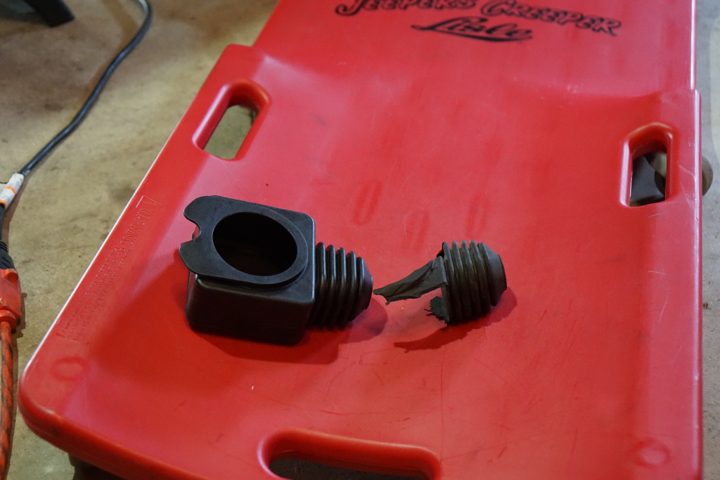

Glad you found some equilibrium on the mount, and are digging the STS. It seems your original linkage boot was trashed too, eh? And yes, a few of those wire harnesses are a b1tch to unclip, even for your dainty little fingers.
I'm kind of surprised you're keeping that standoff at 2" extension. All things like this being subjective, it looks just as goofy 1" higher than stock as it does 1" lower than stock. If you wanted to keep the height, you could use a smaller ****.

You know that plastic disc that came on the shifter? It's supported on the shaft by 3 rubber rings on each side. If put 5 of them under the disc, and one above it, that should be enough to keep it fixed on the shaft and keep the boot pushed up to wherever you want it to be. If not those rubber rings, you can figure something out, I'm sure. I think that's what the disc is for... at least, that's how I'm using it.
I'm impressed by your DIY install on the shifter, without access to a lift. Heck, Liam, I've been impressed by your car all around since I first saw it last year. Only getting better, too, it seems. Looking forward to seeing it again this summer. And you too, I guess.

BTW, with the stand-off that LatheWerks made for me, my ti **** is about 1/4" higher than it was before the STS. However, the titanium **** itself sat about 1/4" to 1/2" shorter than the OEM ****, so everything is back to normal again. Almost perfectly so. You clearly can see the difference in that recent before/after video.
