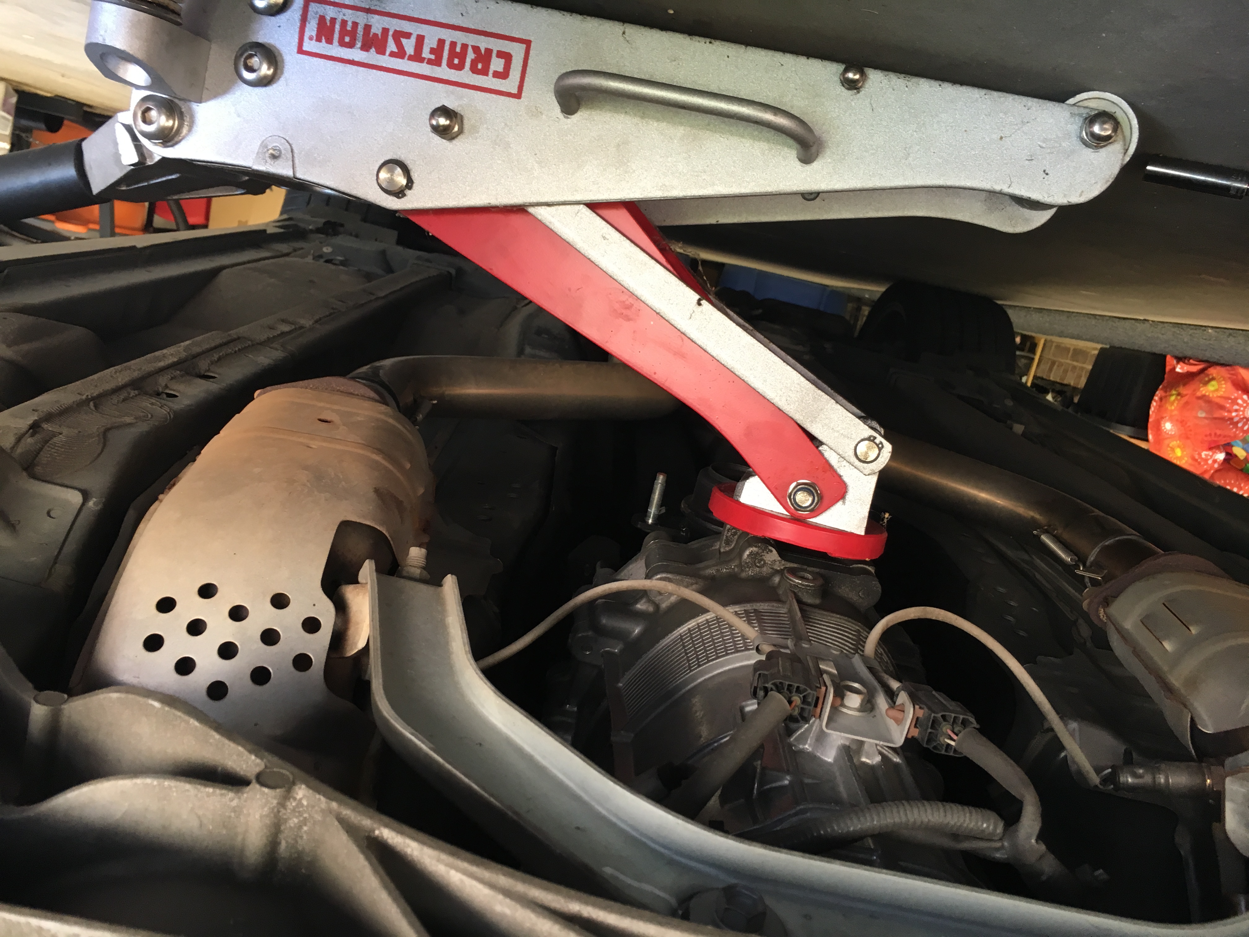

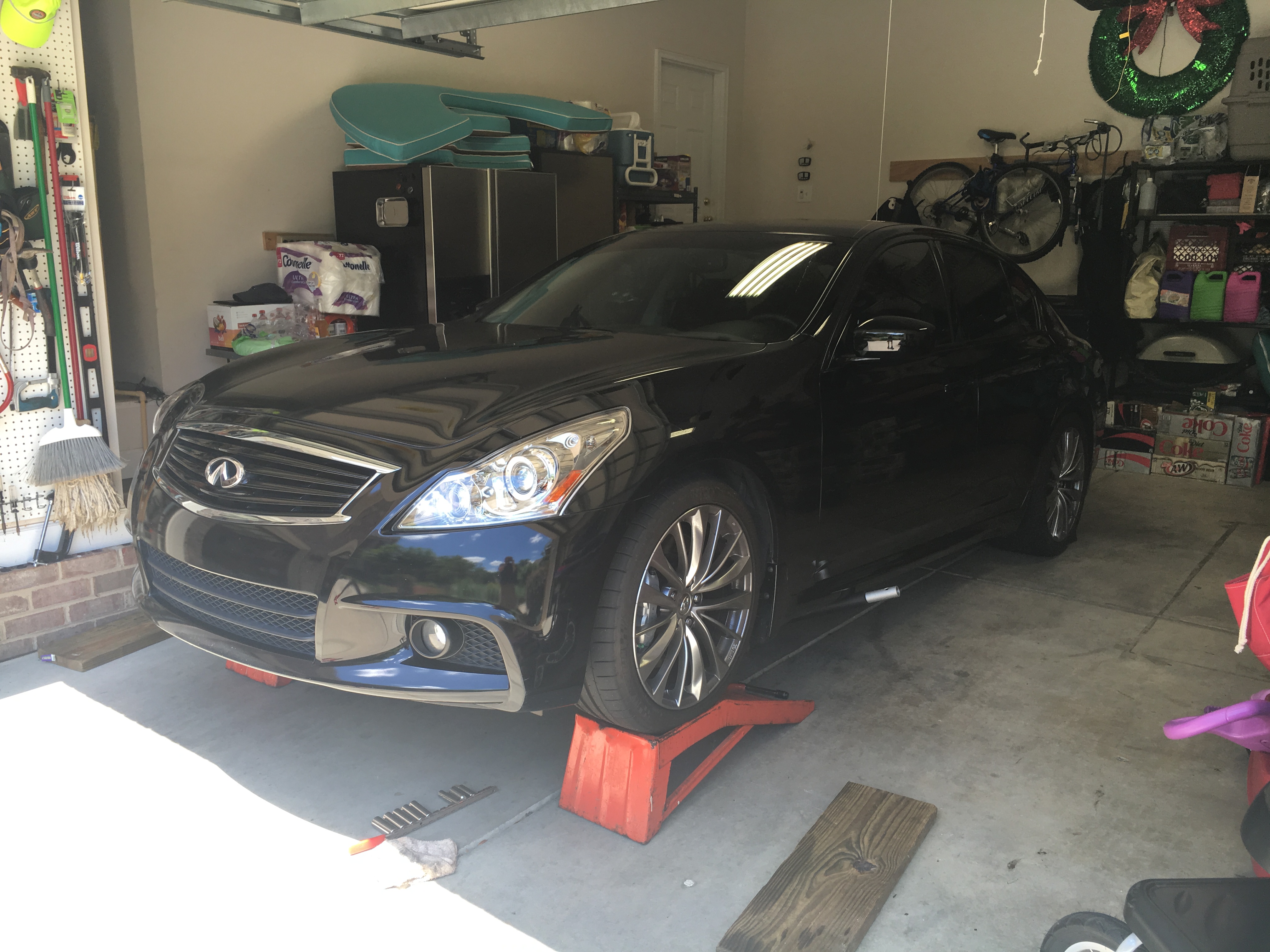

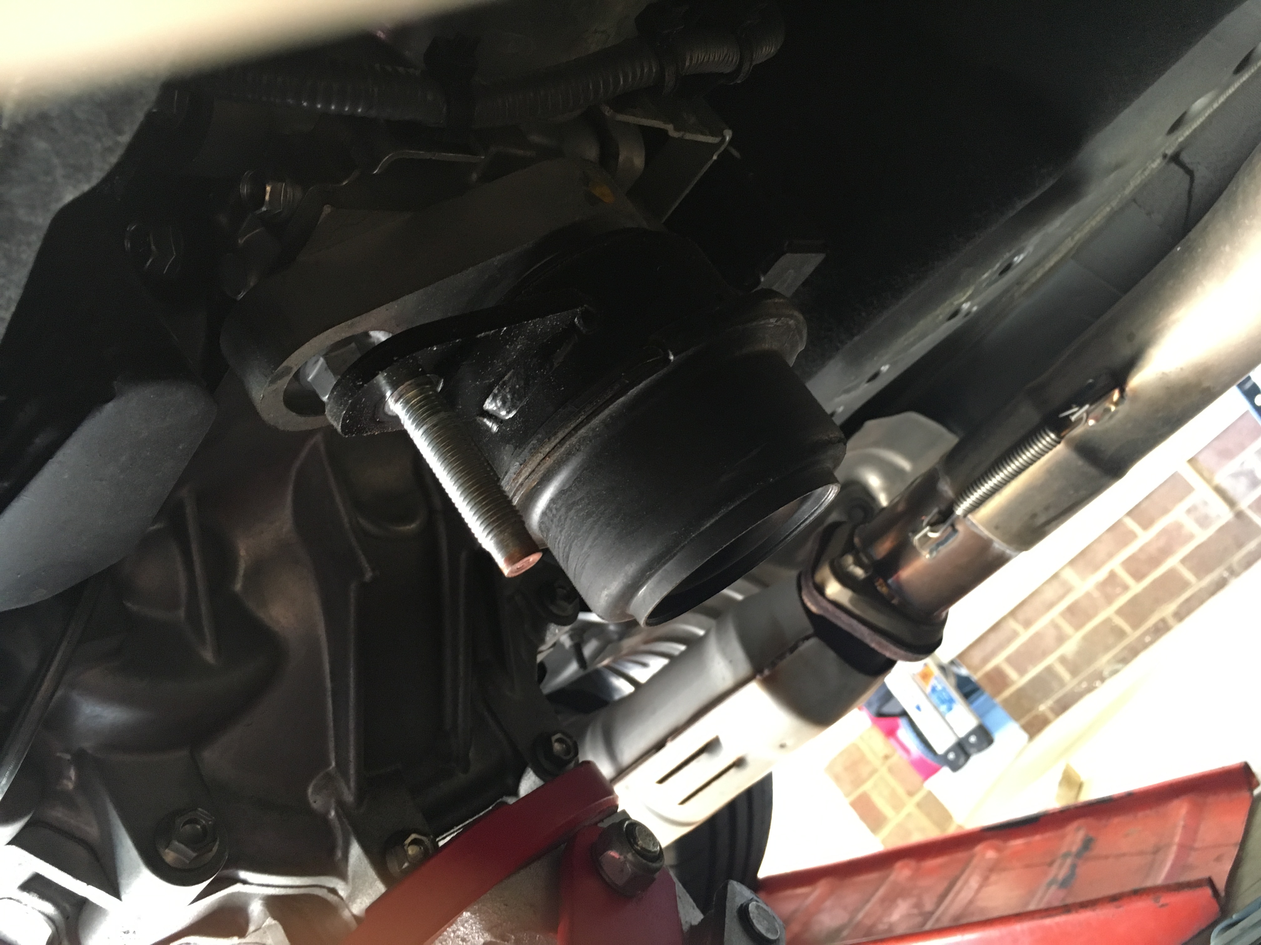

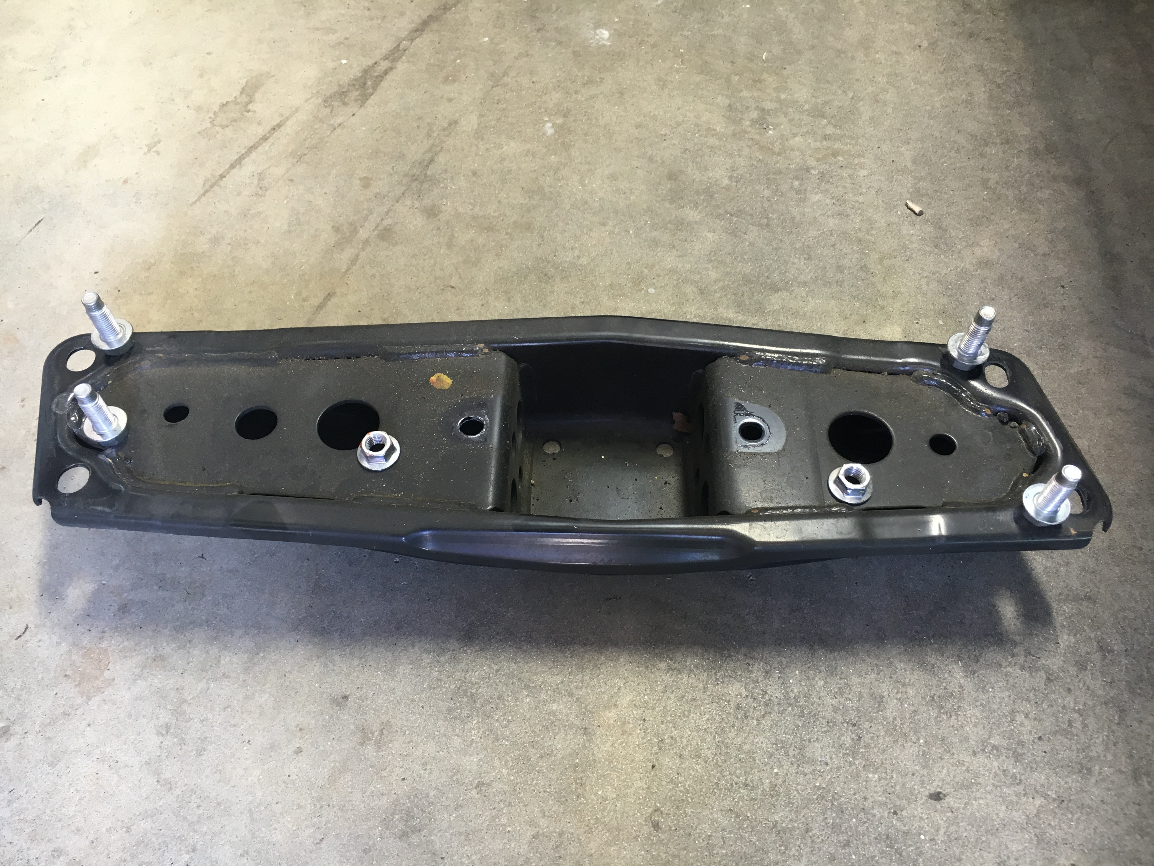

Z1 Mount = Successfully Installed
Install Notes:
  • Everything is 14mm. A 1/2" drive socket set with 6 point standard and deep well was more than sufficient
  • I had adequate access on ramps, although bigger guys might need to get the car higher--I'm 5'10 170
  • Mark the front of the transmission crossmember to avoid any confusion when you put things back together
  • This is an easy install. Up there with changing your oil. It took me ~1 hour
Driving Impressions
  • There is a lot less slop in the drivetrain
  • The shifter doesn't vibrate as much
  • The car is noticeably louder
  • I like
I'll get some more seat time over the next few days. I only drove around for a few miles today since I wanted to mow the grass before our Fathers Day party tomorrow, and because my nanny is taking the kids tonight, so wifey and I have a date night and I'm already tearing into some bourbon

I got some back road seat time yesterday and commuted to work today.
I love how tight everything feels. I can get fully into or out of the throttle at any rpm and there is no slop or movement in the drivetrain. There is surprisingly very little extra vibration.
I'm surprised at how loud it is. Maybe too loud. I'm not sure yet. It's not like an exhaust, where you can get into 6th on the highway and things settle down. It's always loud. 85 on the highway is just loud.
To Rochester's point, it's pretty rare that we use my car for family outings, but I think this might push me over the line such that we never use my car for family outings.
