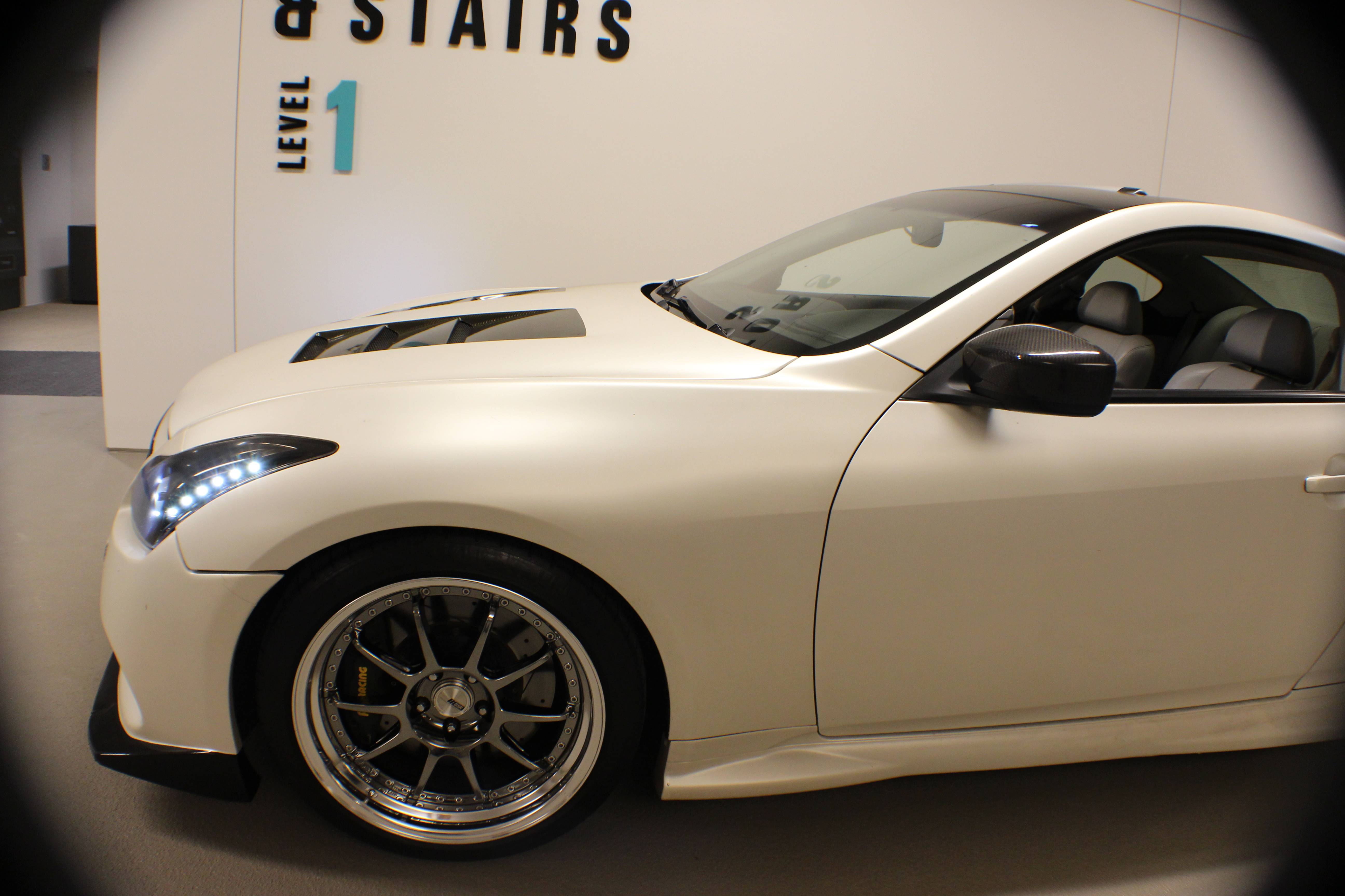

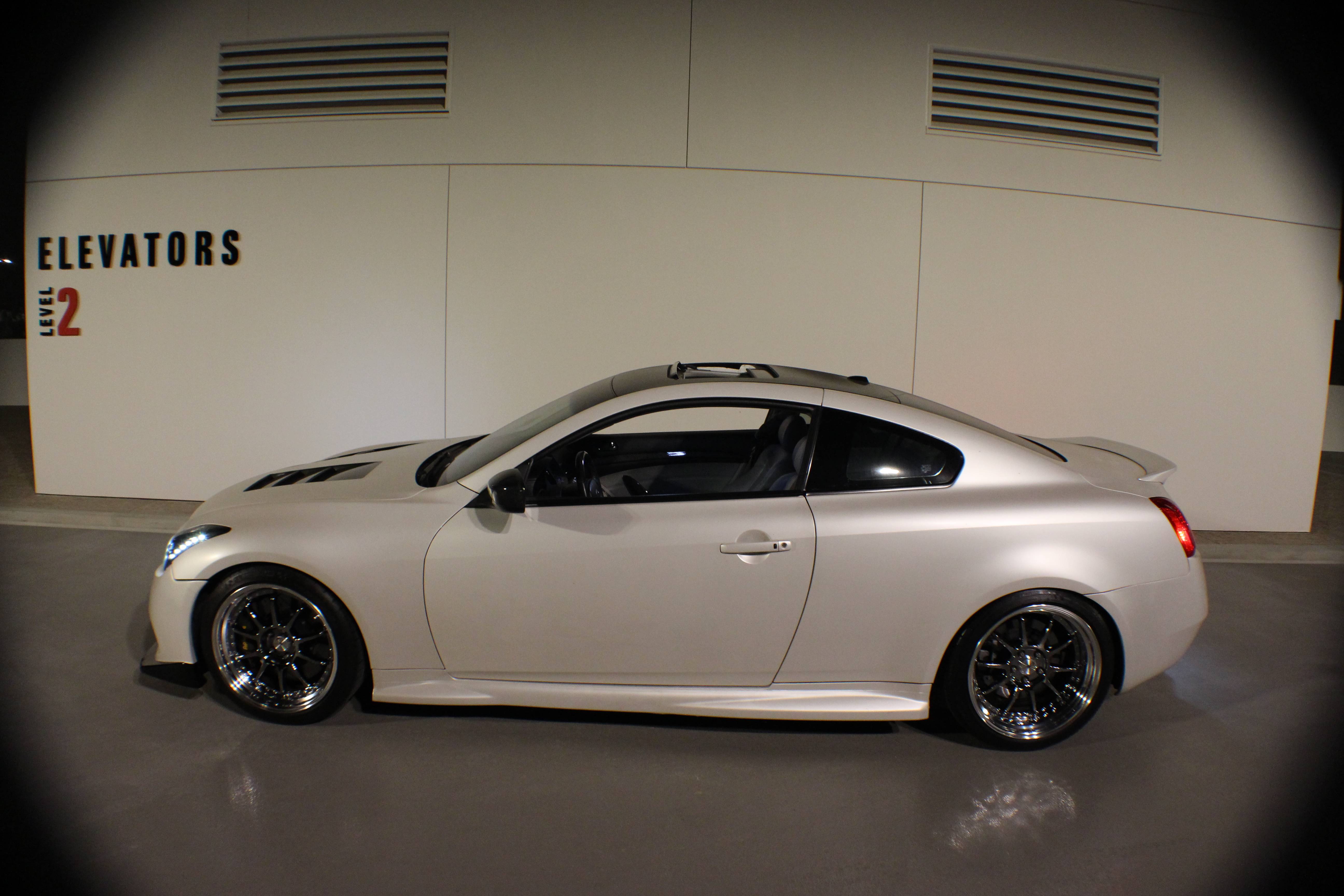

Now, my question: Is there any way to recovery from vinyl with some yellowing/stains? At certain angles it seems that there's a bit of color mismatch. These Vinyl wraps are so sensitive! I some a bit of grime on my car from the tires and it seems to leave little stains. I've been told that Simple Green will do the job.
Thank you for the kind words
Any way you could share some photos of what you're experiencing? Are you referring to stained clear bra?
If so, above surface stains can be cleaned with a variety of chemicals though you should proceed with caution as the film can be quite sensitive if the wrong product is used. If the stain has penetrated the surface, it will require an abrasive (such as a polish or compound) to remove.

Don't have much to provide right now, but there's a stain/yellowing along the edge of the fender lining where the along the door jam closest to the handle. There's dirt stains on the sideskirt that don't seem to come off from handwashing either.
