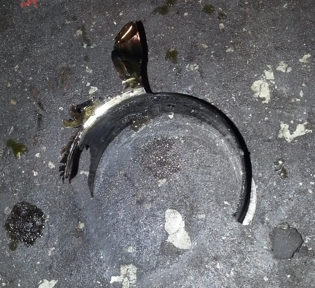

What used to be a crankshaft bearing:
Nice! Your Frankenstein engine has eaten it's first victim. You have to name that monster now.
To keep a very long story short, we couldn’t get any power out of her on the dyno last night. The moment we started touching 5k+ rpm the engine started vibrating and took a dump. It sounded like it was jammed, it wouldn’t crank properly. Car’s at the shop now, waiting on the autopsy report. Looks like I will be going with forged internals and rebuilt engine sooner than expected.
You've barely driven it and not at all hard.
Do you think (I do) that the block was romped from the outset?
This motor should be able to handle 500whp bone stock, no?
How hard was this being pushed. Oil delivery/pressure problems?
Ugghh. Tainted love. I wish you better, but I'm skeptical of spending money on stronger parts when the core problem hasn't been dignosed. The rods didn't bend, right?
Update me.
Thanks Sam.
Haha, I'm guessing it was bound to happen.
Update me.
Thanks Sam.
Coop
You're 100% correct Coop (when are you not? ). Can the engine handle 500whp stock? Probably if it was in OEM condition. I bought my first RB30 block from the scrapyard for $350. The seller had zero idea of the engine's history, all he said was it's "good". The engine didn't even have an A/C compressor (to give you an idea of how old it is). Given its age and past abuse/improper service (engine came off a truck) it was a gamble. We ran a compression test on it (which only tells so much) and it seemed fine, so I decided to throw it in and try it out. The engine started and sounded very rough as you saw in the first video, but with a tune and a little breaking in, it got a lot quieter, drove it around the country and back with no issues what so ever. The bearings then failed on the dyno under heavy load and revs and damaged the crankshaft in the process. I was then left with two options:
1) Gamble with another RB30 for $350 and hope it works and handles 500whp
2) Build an RB30DET the right way, with forged internals, balanced crankshaft, race bearings, bullet proof oil pump and crank collar (RB OEM pumps have weak gears and are known to fail near redline)
I decided to go with option (2) since the engine is opened up anyways and since I plan on upgrading internals down the road for a peace of mind, I do not plan on babying this engine at all
