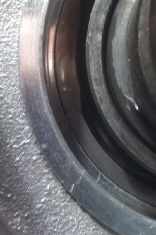

I'm new here and only joined because I have a concern about your catch can setup as it shows in one of you pictures.
It looks like you have both of you valve cover vent hoses going to a catchcan which is good but if that catchcan doesn't have a third port or an air filter/breather then you have closed looped the crankcase and you will pressurize the engine and cause seals to fail.
Which could explain the front crank seal leak you mention earlier.
Also I would like to pass on some personal experience with an oil leak from the front seal.
My engine developed a leak that would keep coming back everytime I wiped it away at idle front the front of the engine.
This lead me to pull the front crank seal and take some picture to see inside.
I found I had cracked the inner oil pump gear on my greddy pump.
I would hate to see all your efforts lost to this so I felt I needed to pass this on.
Good luck with the build and I hope to see some great updates.
