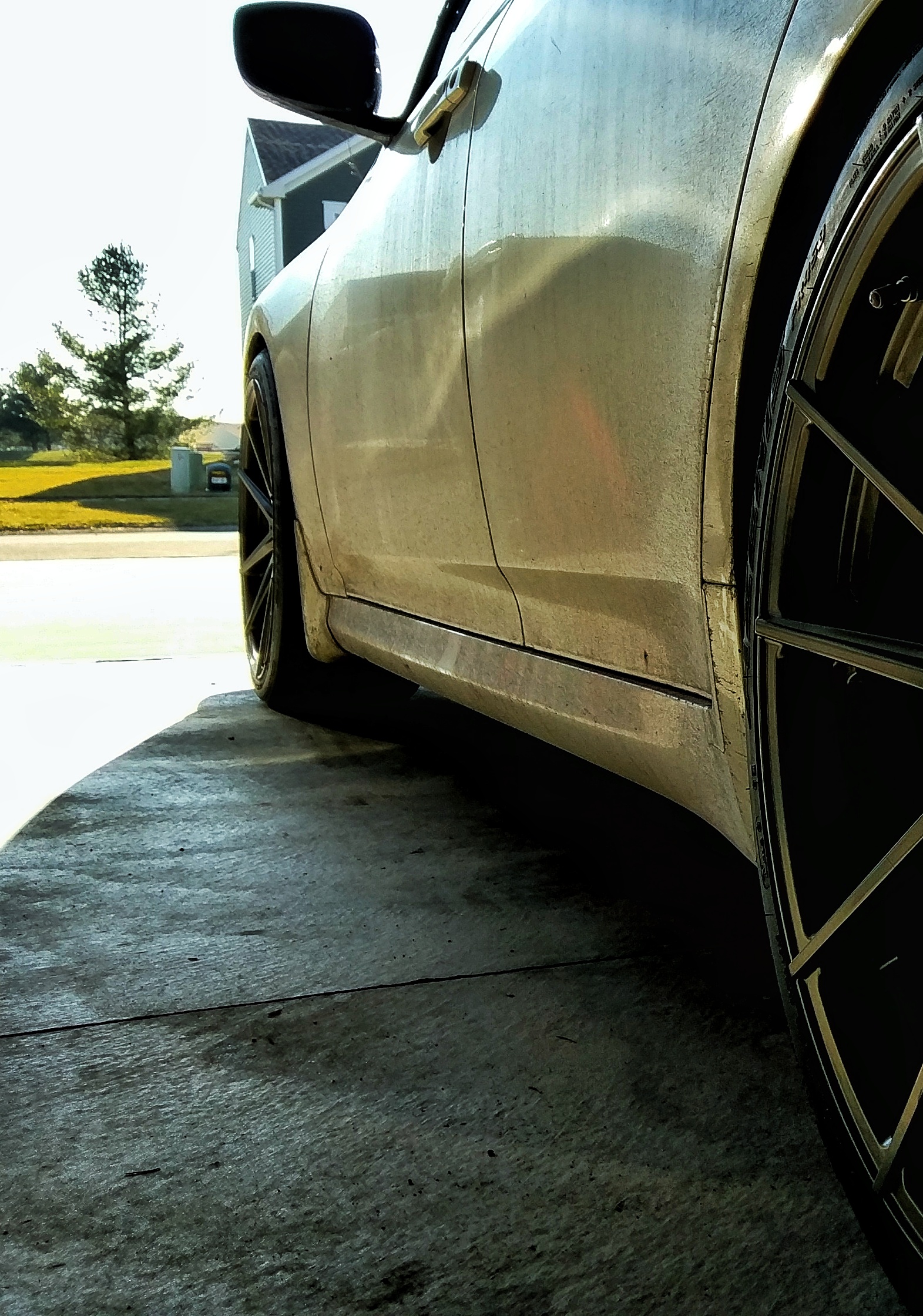

A damn filthy tease. (Because car is filthy). Decided to pull the trigger on some new wheels. Previously had 20x9 +25 all around. Wanted a new style and more concave. These are 20x9.5 +35 255/35/20. I'll post some better pictures when the weather is nice and the car is clean. But for now, a teaser. The choice of wheels I originally had my heart set on before I purchased any wheels was ultimately scrapped due to having swapped my AWD calipers for akebonos. Suffice to say these wheels clear the front calipers with around 4-5mm

C'mon man, don't be such a tease
Looks like you've got a winner there.

20x9.5 +35, 255/35/20, TSW Bathurst Gloss Gunmetal, Rotary Forged ~24lbs no tires, haven't weighed them with the tires yet.

Awesome fitment there sir and a great wheel choice for that white G! Well done.

Beautiful! Perfect combination of aggressive form AND function
