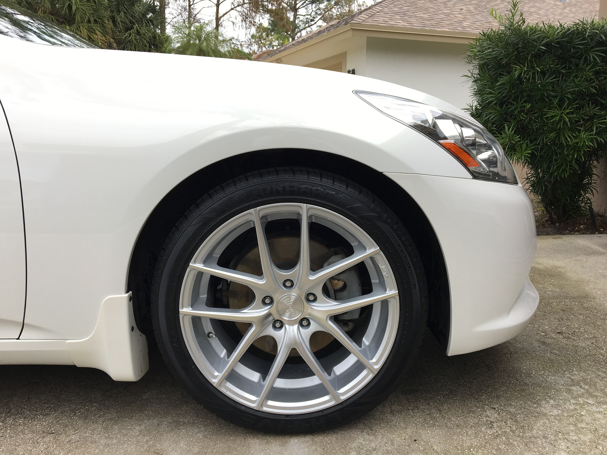

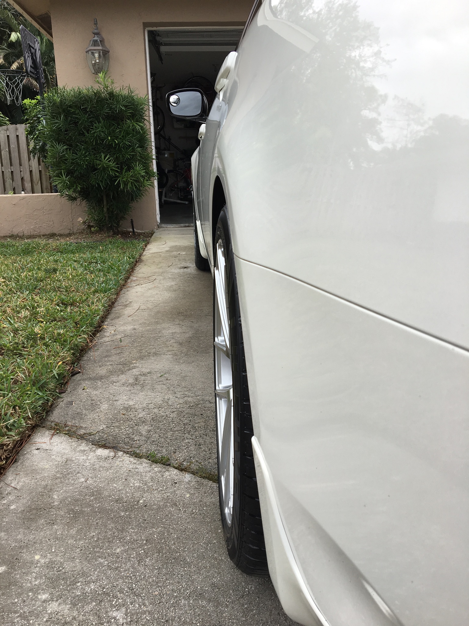

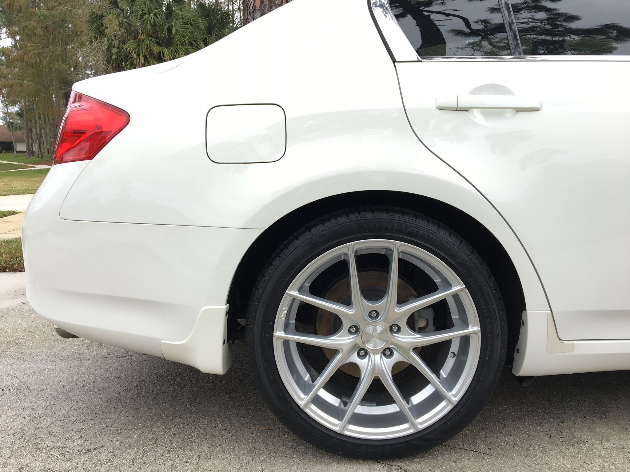

'12 Journey square setup
Niche Targa 19x8.5 +35
245/40 19
Stock suspension
The OEM-ish look
Attached Thumbnails HELP~All squared setups please post here!-img_0162.jpg   HELP~All squared setups please post here!-img_0156.jpg   HELP~All squared setups please post here!-img_0158.jpg   HELP~All squared setups please post here!-img_0161.jpg
245/40 19
Stock suspension
The OEM-ish look
Looks great! It's begging to be lowered

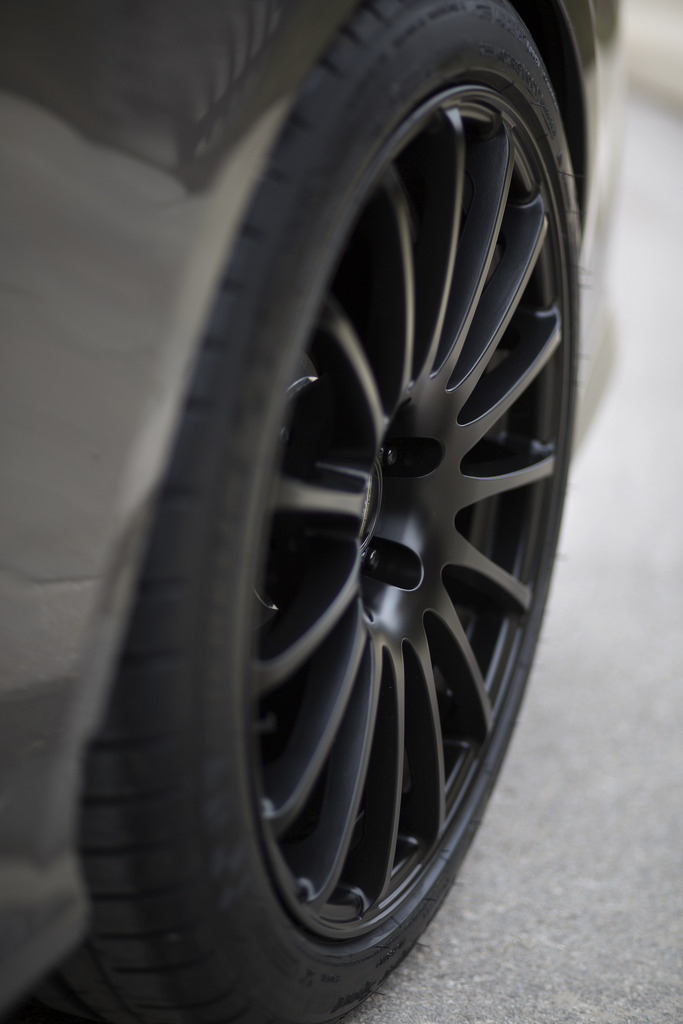

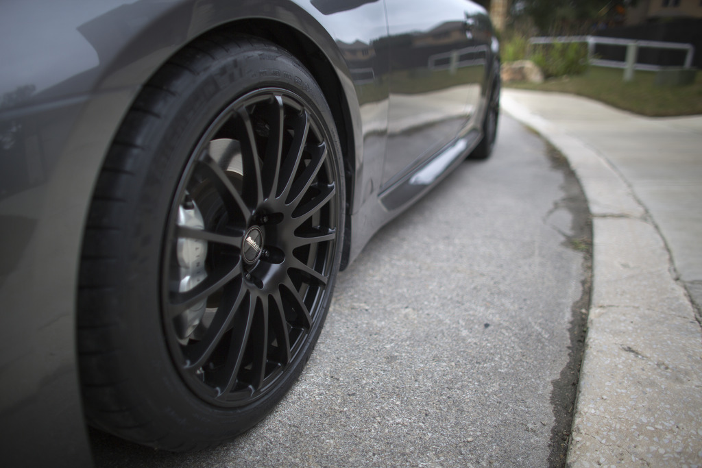

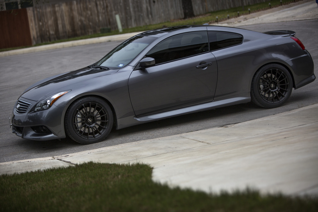

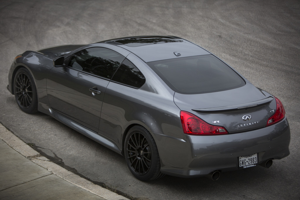

From: San Antonio, Texas
255's on a 9.5" wheel.
