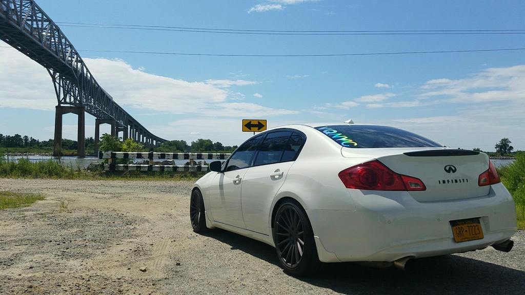

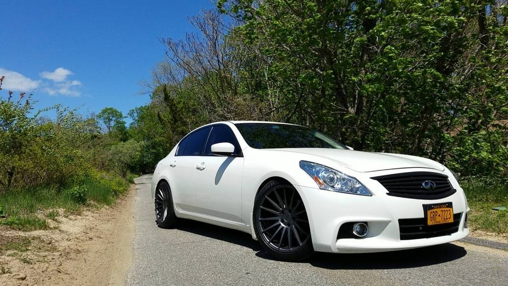

Originally Posted by Twinturbo6
Tire shop didn't think I would be able to fit 245/45 and they didn't carry 245/40
I run that exact same setup lmfao, niche m157 19x9.5 +40 with 245/40/19 Pss. they fit perfectly and they dont rub at all. I actually put 15mm spacers up front and 5mm in the rear.
w/ spacers
w/o
