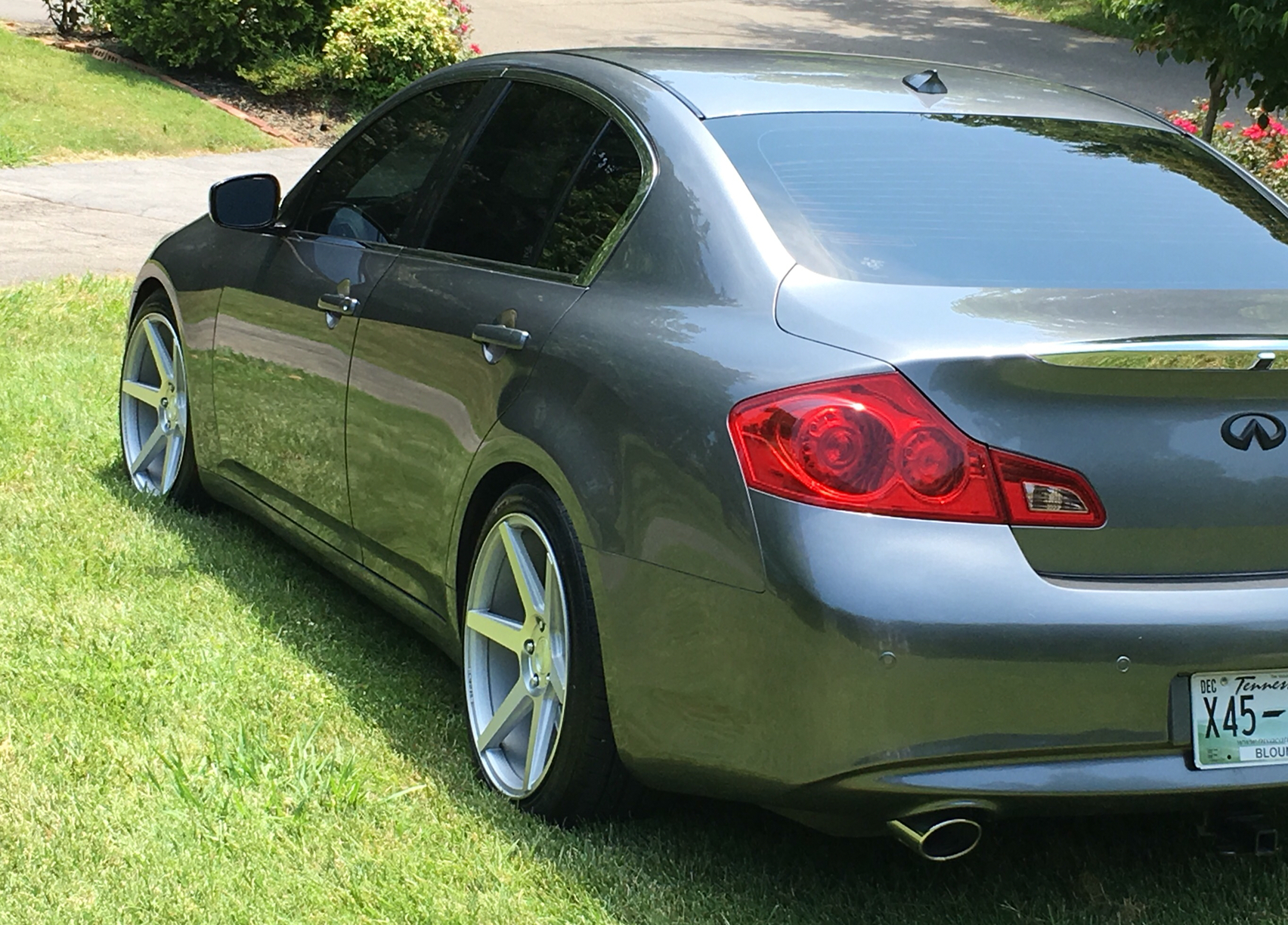

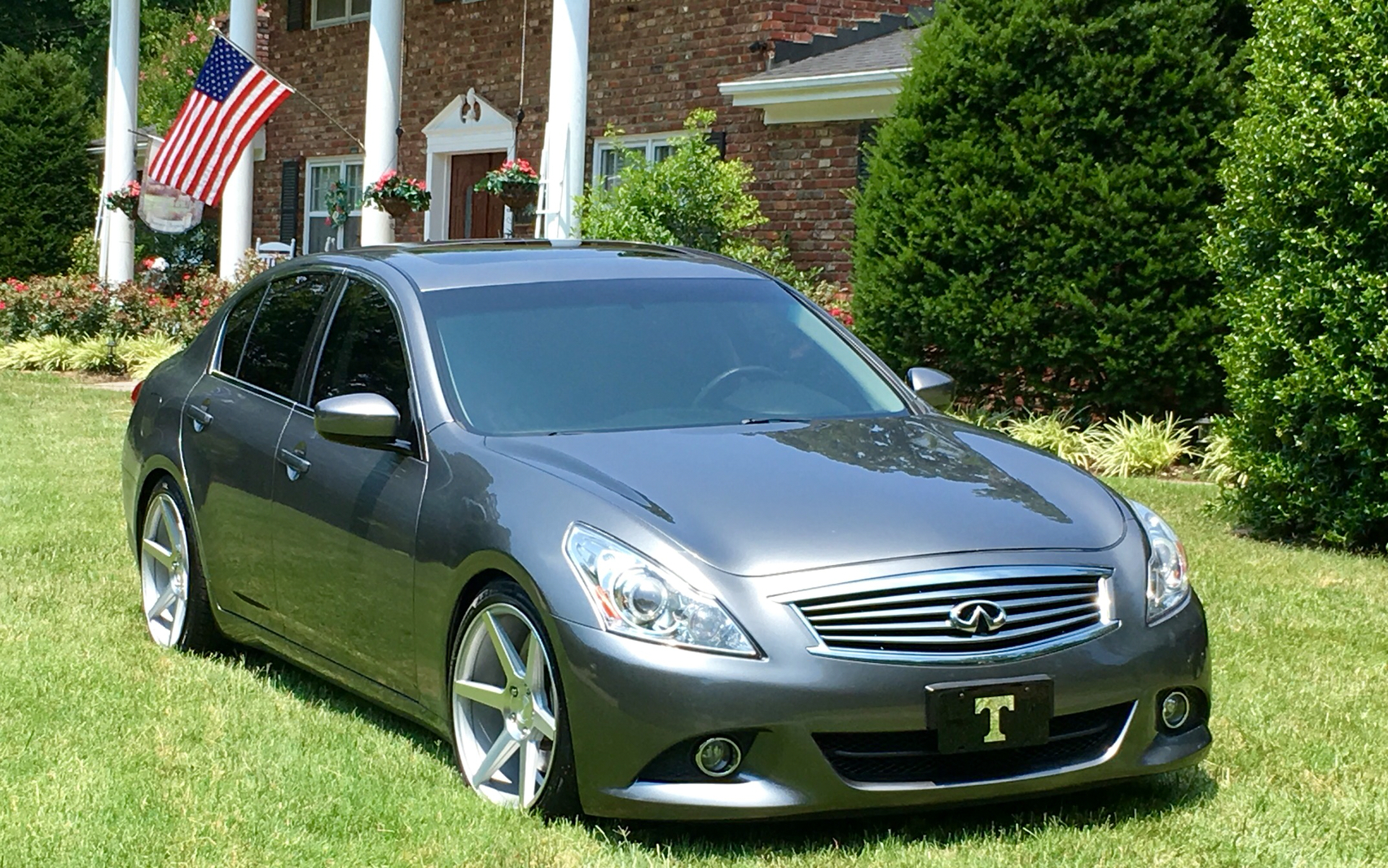

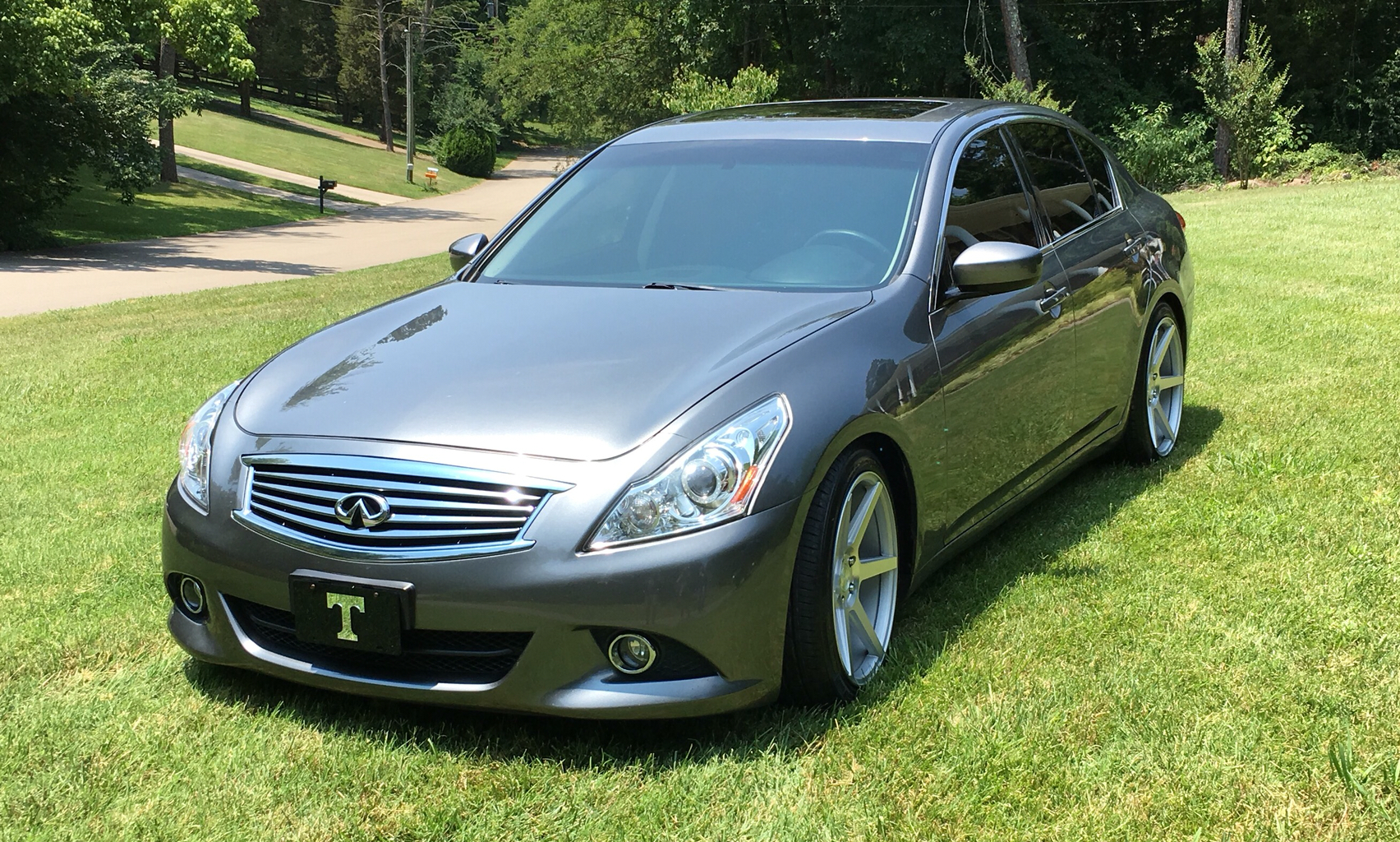

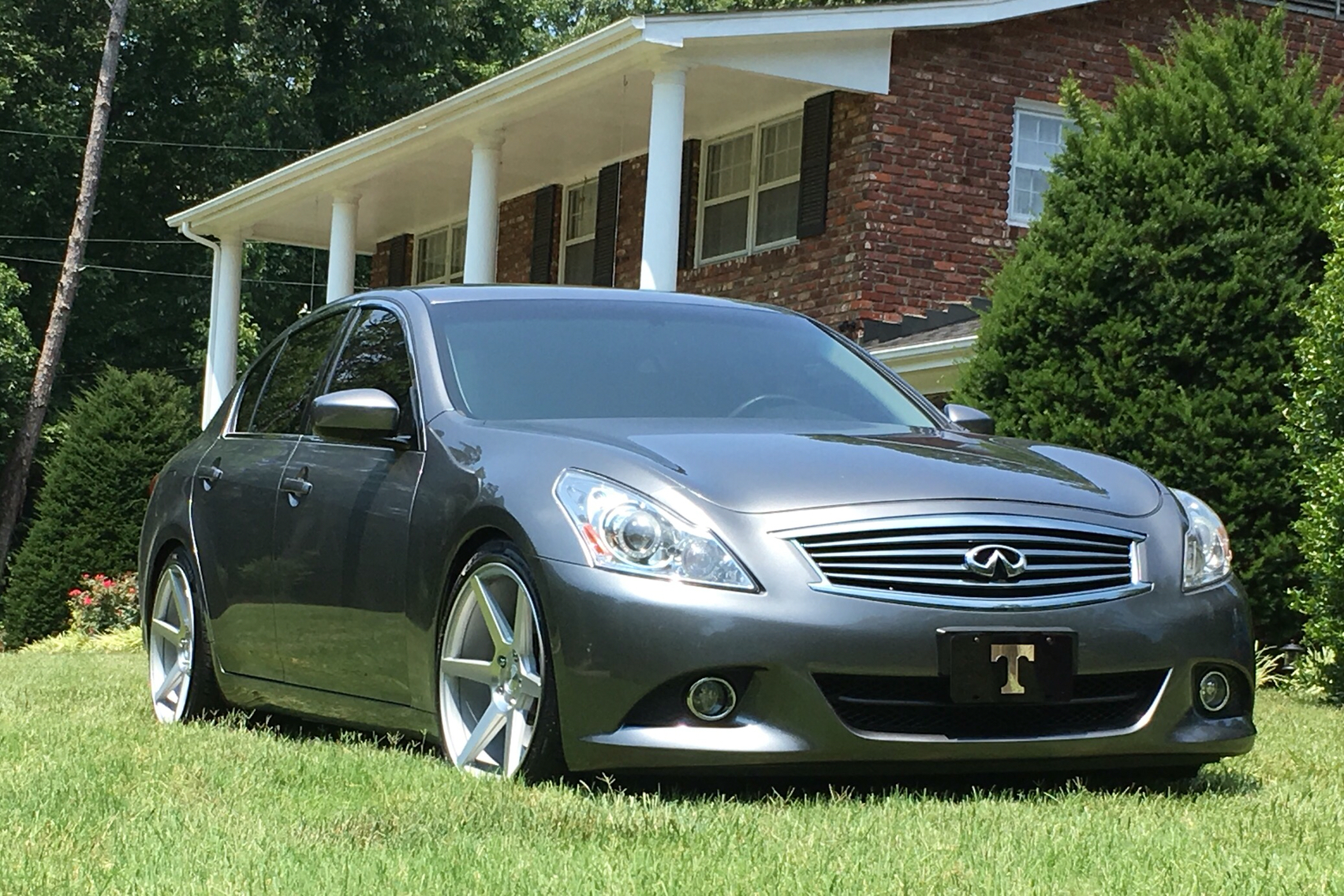

Attached Thumbnails HELP~All squared setups please post here!-photo294.jpg   HELP~All squared setups please post here!-photo689.jpg   HELP~All squared setups please post here!-photo722.jpg   HELP~All squared setups please post here!-photo564.jpg
Old Jul 3, 2016 | 03:54 PM
  #621
Nice job JB, looks like you have that height dialed in well on the KSports and wheel/tire fit looks good. Did you end up w/ 245s or 255s?

Thanks! I chose the 245s to start but I am still considering the 255s for my next set. I installed the coils myself after calling several shops around here and not being satisfied with the prices or the inexperience I could here in their voices. I am still dialing in the KSports to get the damper settings to the best possible ride. I've learned a lot and enjoyed every minute of this project.
Old Jul 3, 2016 | 05:13 PM
  #625
lol, I also have 245s but will probably go 255s next set.
Always nice to DIY those kind of installs, much better to know firsthand how your parts are assembled as long as you have the time, patience, & tools.
Post up some reviews when you get some time w/ them.
