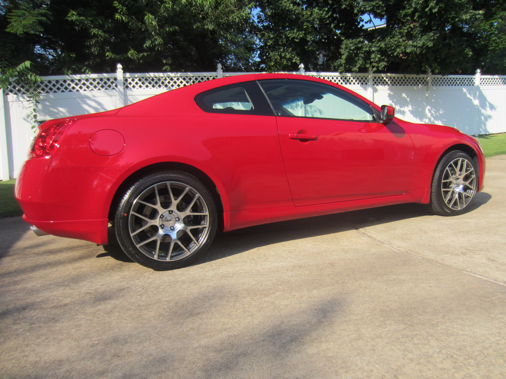

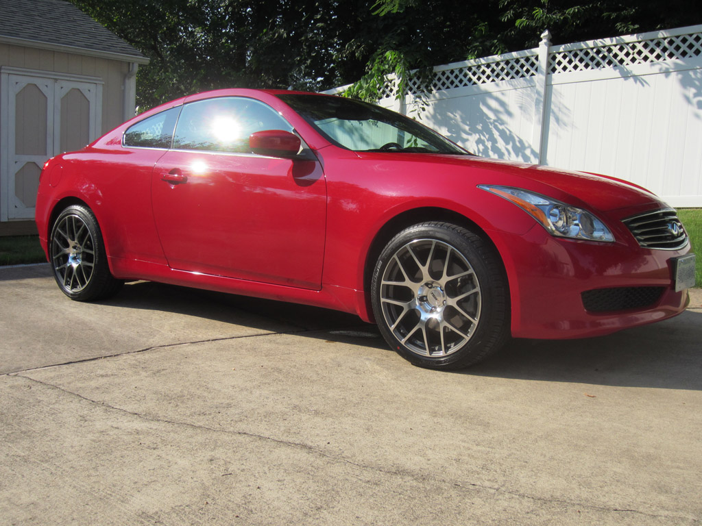

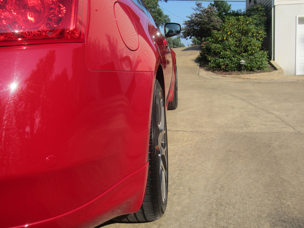

Just installed my new TSW Nurburgring 19x9 +30mm wheels w/Michelin MXM4 245/40-VR19 tires:
Still looking into a 1" drop via coilovers, but gotta find some that are quiet.
curious what made you go with the Michelin MXM4's?

I drive it year-round, so I wanted tires with good cold-weather grip, ride comfort, and low noise, so after a lot of research I went with the Michelin MXM4s (this is actually my second set). I don't drive it in heavy snow (I have a Ford Explorer for that), but based on previous experience I don't like driving with summer tires in really cold temperatures -- they get hard as a rock. If I lived in a warmer climate I'd have gone with Michelin Pilot Super Sports.

And you won't have to buy another set for a long time too
New wheels look very nice

x9 +30 is best for stock height
