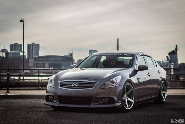

I wanted to be flush in the rear. I'm currently running 19x9.5 +40 squared and it's not flush so I was thinking a 10mm spacer would make it more flush. Don't know if 10.5 +42 is gonna look the same as 9.5 +40.
Hey man. Would it be to much trouble to ask you to upload a photo of how your car sits? Preferably down the side so I can see how flush they sit? Thank you

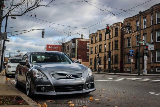

sorry man...don't have any pics like that, this is the best I can do till later. I'm guessing I would need a 10mm in the rear to be flush with fender. The front looks like a 15mm-20mm would be needed to be flush. I'll get pics showing how tucked it is. I'll also measure the height so you can get a better idea of how it sits.
Wow. Very clean looking sedan bro! That's 9.5 +40 all the way around right? I like the set up a lot. I'll just do some good extended studs in the front with some 10mm spacers if I'm not happy. Looks like they're good to me though. Thank you for the pictures as well, sir.
