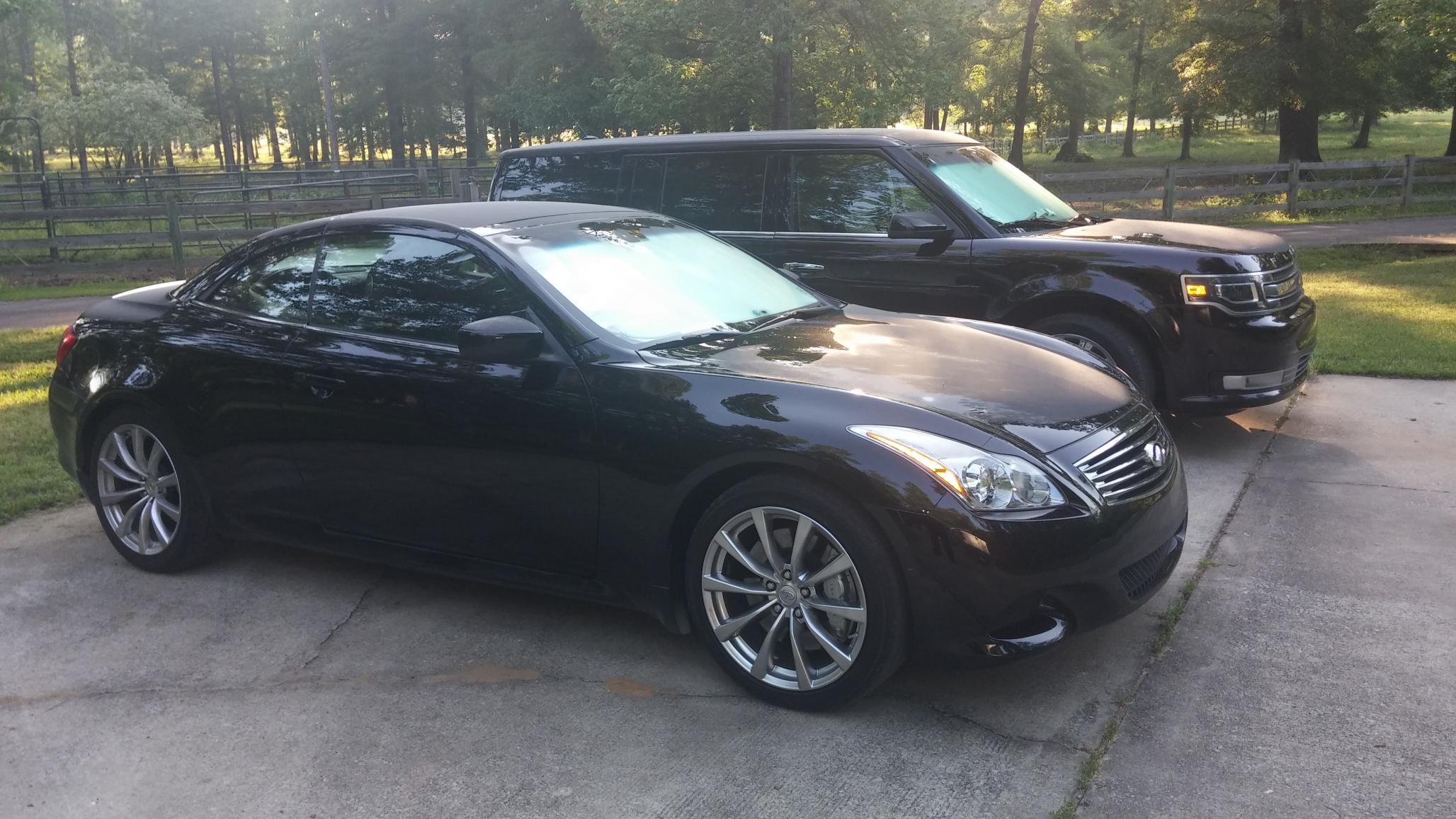

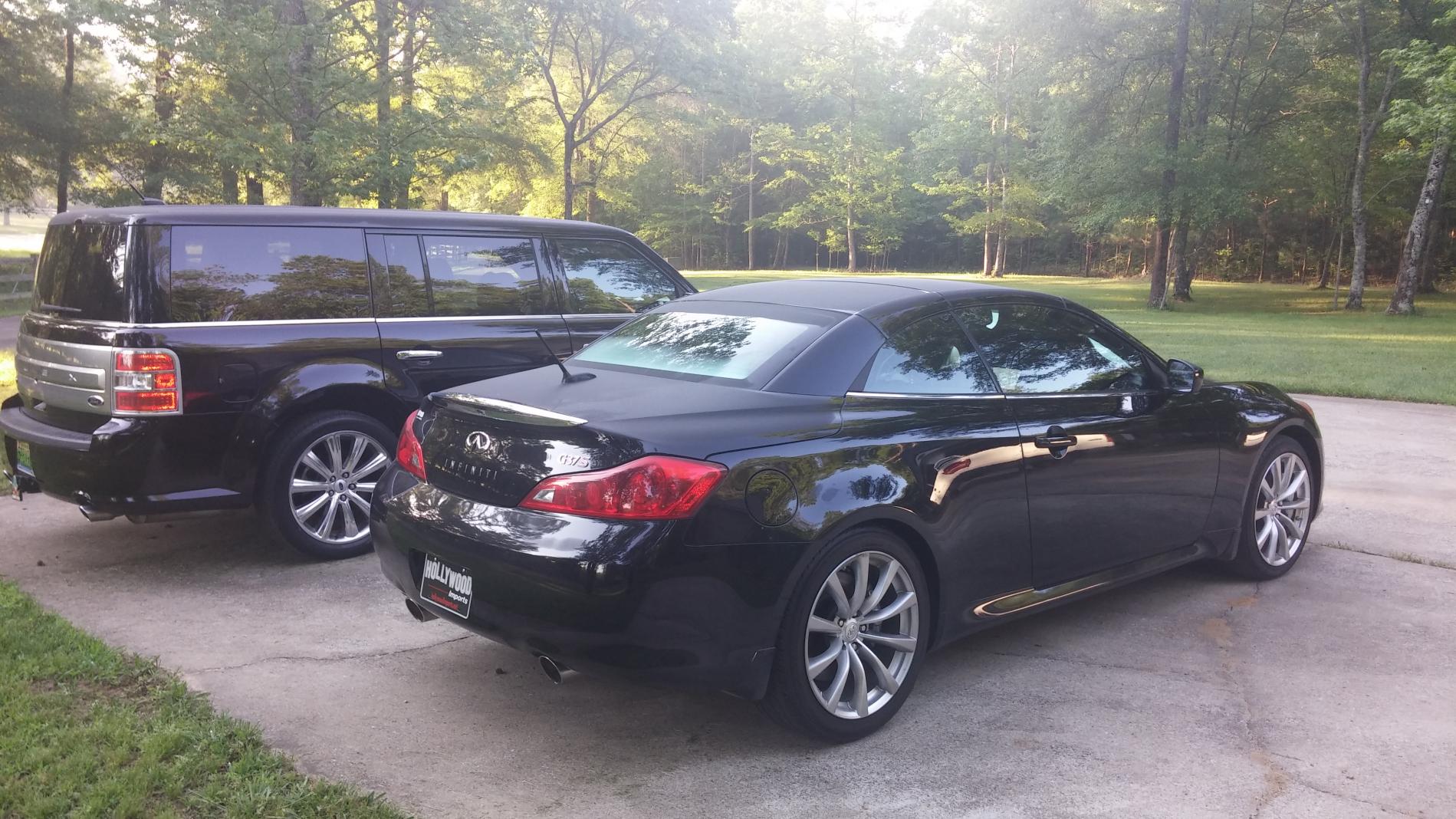

Old May 16, 2015 | 10:26 AM
  #755
jbosey's Avatar
jbosey
Joined: May 2015
Posts: 35
From: Near Birmingham, Alabama
Pretty boring post but any suggestions would help
What tires should I be looking at to replace the miss-matched set that is on the car from the used dealer (they are the correct size according to the sticker in the door)? Here are my requirements:
  • I am not racing my 2009 G37S convertible.
  • I live in the south so do not worry about snow.
  • I am very much into less road noise
  • I want to stay with my stock 19" wheels.
  • I do not really like space I see between the sidewall and the wheel (looks like the tire should be slightly wider to me)
  • I just signed up for the extended tire and wheel warranty for 48 months and do not want to jeopardize any coverage
  • I do not know if this car has TPMS (how can I tell?)
  • I would like my speedometer to be correct.
  • This is a weekend only car for enjoyment (top down, enjoying the weather and scenery).
  • I am relatively cheap but do not mind paying for quality and long life.
Any suggestions on what would best fit my requirements?
Attached Thumbnails The OFFICIAL "I have a wheel offset / tire fitment question!" thread-infiniti-pair-1.jpg   The OFFICIAL "I have a wheel offset / tire fitment question!" thread-infiniti-pair-3.jpg
Old May 16, 2015 | 02:07 PM
  #756
Likes: 4,952
The stock tire sizes should be 225/45/19 front 245/40 19 rear. If you want a bit wider to get closer to the fender edge and keep your speedometer in range I'd look at 235/40/19 front 275/35/19 rear this will keep yo0ur speedometer reading just a minimal 0.67% slower and will give you a bit wider, planted feel. Summer tires are all going to wear pretty quick unless you really want to open your wallet and get the Michelin Pilot Super Sports.
These have great wet & dry grip and wear pretty well for a summer tire, 25,000 miles should be about what to expect. For about 40% less the Toyo Proxes T1 Sports have great wet & dry grip but will be well worn at 20k miles. Andrew over at Treadepot.com is a good guy to talk to, mention the site for good deals. Also Neal @ Tirerack is also very helpful to us.
Old May 16, 2015 | 02:42 PM
  #757
jbosey's Avatar
jbosey
Joined: May 2015
Posts: 35
I guess with these 19" wheels there is no chance of getting the old 40K to 50K miles we used to get with the smaller wheels? I have these 19" wheels on the 2013 flex Limited as well. Looks like I will be spending more on tires than I ever have in my life!
