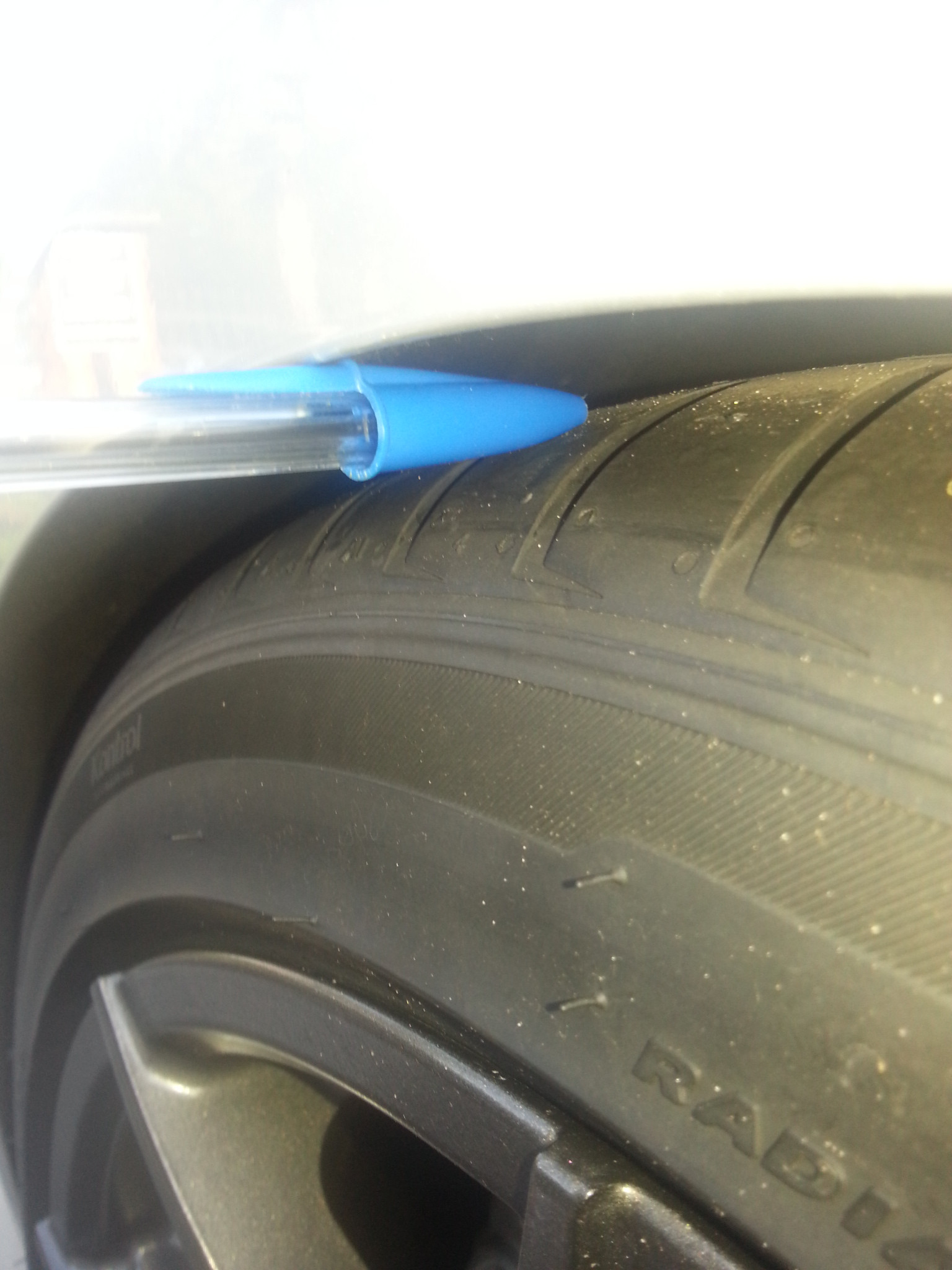

I have 19x9.5 +23 in the front with 245/40/19 (or is it 245/35 i forget, essentially oem sized though just wider) and not even close to rubbing the outside. I have an fairly decent drop, bout 1.5" in the front and -1.6* camber. Eventually i'll get a camber kit and it will make the wheel and fender pretty tight if I can reduce the negative camber and bring the wheel out towards the fender again
by not even close I mean there is room, but I cannot fit my infiniti key between my fender and wheel, I can fit a pen cap though. PM me if you want pics and more info.
edit; actually heres the pic:
once i get a camber kit and reduce the camber to -.5 or 0*, the tip of that pen cap will not fit anymore. don't think i'll have to roll the front fenders, but who knows...
The OFFICIAL "I have a wheel offset / tire fitment question!" thread-wrvwymd.jpg
