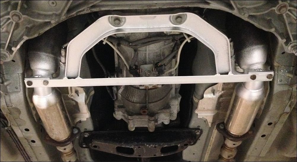

Welp, after 8 hours total this weekend, my friend and I removed all the SPL arms, rethreaded them properly, readjusted my preoload and tightened down all the collars.. along with putting the suspension under load and checking tie rods, ball joints, compression rods and lower control arms, we finally got rid of the "clunk/knock" noise I was getting. It was either loose collars or not enough preload on the coilovers. Drove the car for nearly 70 miles and haven't heard a single noise. I'm super happy again, also got the car realigned. -1 camber up front and -1.5 in the rear.
Now to stop my exhaust hanger from squeaking, also playing with the idea of getting the bracket welded to my HFC, similar to what Rochester did.
I thought that pic looked familiar.
That hardware is very rusty two years later. Although every time the mechanic has the car on the lift, he inspects that bar, cleans it up, makes sure the welds, nuts & bolts are all still sound. So far so good.
