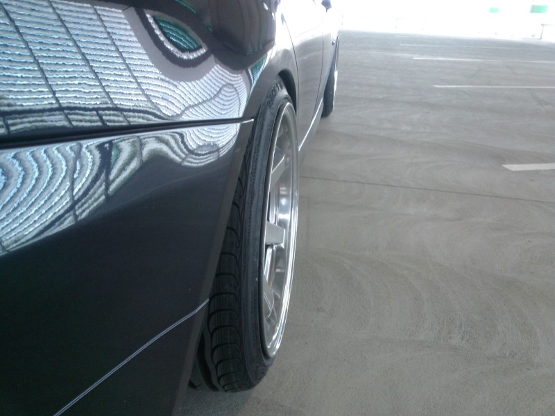

Hey guys just a question as I am confused
a 255/35/20 tire on a 20X10.5 offset = 30 rim
How stretched will this be? Confused here just trying to get a visual or measurable definition.
Old Apr 5, 2017 | 11:30 AM
  #1924
I assume you meant +30 offset. A 255 on a 10.5 will be quite stretched but is very common. Your sidewalls instead of going straight up w/ a standard mount will angle out from the tread block to the wheels edge, this also leaves the wheels edge unprotected by any tire protection rib. Here's a pic of a 255 on a 18x10.5
thank you. What would be a tire size to run so that the outer rim will not stick out ?
If you are planning on running that 10.5 +30 offset on a sedan that's about the widest tire you can run without running extra camber. If you are in a coupe you could run a 275 width tire and this would offer a more standard mount w/ better wheel protection.
But that little rib of rubber offers just minimal protection, better than nothing, but the best thing to do is avoid curbs at all costs. I don't park at the end of the line where there's curbs, I go a bit wider around curbed corners, etc and the wife is also following suit
