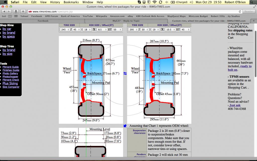

u think i can push a 295/30 rear with +45
Base on the calculator (see attached) a 19x10.5 +45 with a 295/30 would net;
Suspension Clearance: 20 mm (0.8'') closer to suspension/brakes components.
Fender Clearance: stick out 30 mm (1.2'') farther.
Wheelwell Clearance: 100% clear.
Speedometer: When speedometer reads 60mph (96.6km/h) actual speed will be 58.6mph (94.3km/h): 2.3% slower.
FYI: Same set-up with a 295/35 would; Fill the wheel well 6mm and the speedometer would reads 60mph (96.6km/h) actual speed will be 61.1mph (98.4km/h): 1.8% faster.
I have heard on the Vossen thread owners running a 305 tire. However I think this is too aggressive for the G37 sedan.
Attached Thumbnails Official~Best offsets for running FAT tires!-screen-shot-2012-10-29-at-7.50.10-pm.jpg

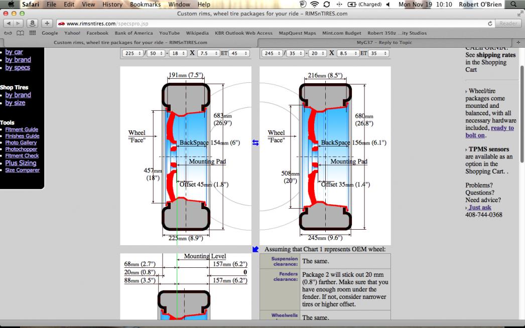

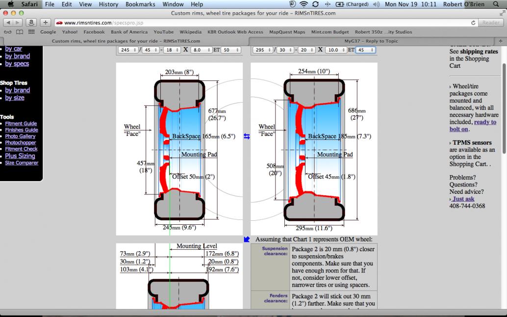

Perfect timing to find this thread, just about ready to become a "fat-tire" member
Got the tires coming tomorrow and the wheels are getting machined later this week. That rimsntires calculator is a great resource. My 09 sedan is going to run 245/35/20 on a 8.5"+35 and 295/30/20 on a 10 or 10.5" +45.
This bracket everyone talks about that may require trimming, where is it specifically and do you think it's a concern on the sedans? Also are the rear offsets safely within the fender lip, don't want a tucked camber. BTW, lowered almost 2" on Megan coils.
Thanks for any help, can't wait to join the club!
What bracket???
As far as your 20x8.5 +35 w/ 245/35:
Suspension & Wheelwell clearances are the same.
Fender Clearance: It will stick out 20mm (.8").
Speedometer: 60mph actual speed will be 59.7mph; 0.5% slower.
And for your 20x10.0 +45 w/ 295/30:
Suspension Clearance: 20mm (0.8'') closer to suspension/brakes components.
Fender Clearance: will stick out 30 mm (1.2'') farther.
Wheelwell Clearance: Will fill out the wheelwell by extra 5 mm.
Speedometer: 60mph actual speed will be 60.8mph : 1.3% faster.
See attached pictures.

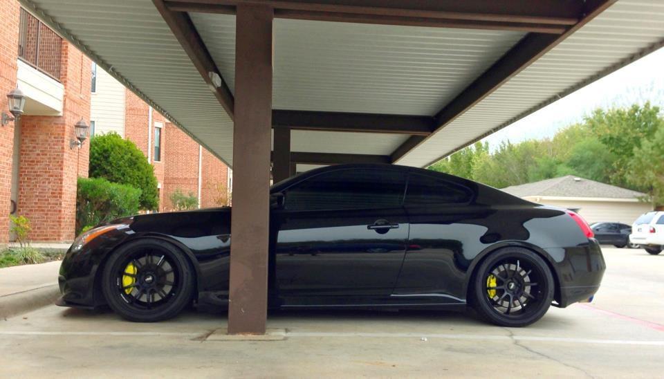

Thanks.. here she is not too long ago.. Asked soundmike to photoshop my brakes.
Front is a bit higher now though since I was scraping bad going to work garage. Might drop it again just a little bit once my coils settle some more.
Meaty doesn't mean you can't look good..

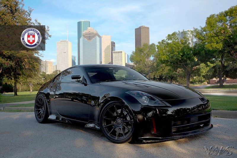

Gonna share another pic of my Z...
HRE P43SC 19x9.5 +20 & 19x11 +25
Toyo R888 265/30 & 305/30
