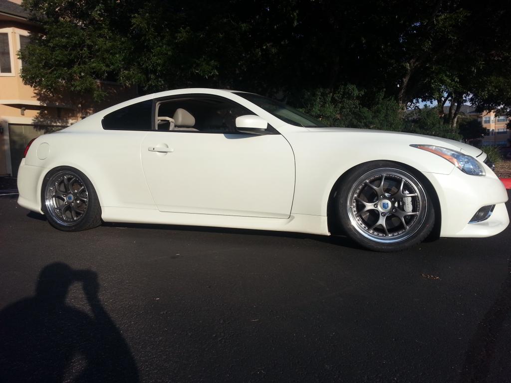

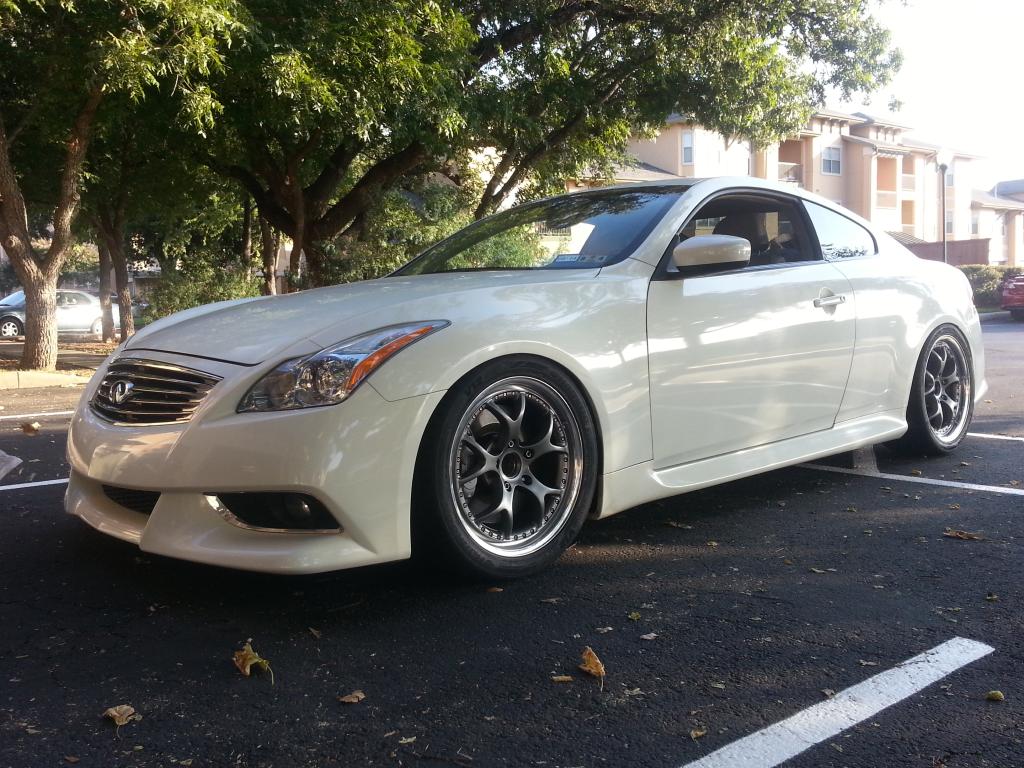

Well, here you go. I ended up getting the 255/275 combo. Starting to think I should have done the 285 instead. I just put the coils on today as well. I need to raise them up a tad once I figure out the best way (that rear spring setup is new to me). I also have the legit Racing Dynamics caps on their way. I'll get better pics later. Either way, I hope you enjoy.
Attached Thumbnails Official~Best offsets for running FAT tires!-20140731_191452_zpsal0we1l9.jpg   Official~Best offsets for running FAT tires!-20140731_190829_zpss71jief1.jpg
Old Jul 31, 2014 | 10:16 PM
  #830
Likes: 4,949
Looks great, pretty slammed, maybe a 1/2" higher
Looks like the 275s fit pretty tight, you think there's another 5mm back there for 285s?

I should be able to get another 5mm once I remove the temporary 5mm spacer that's in there (my OEM studs were a little long for the wheel/adapter). That's the max rear setting for the Megan's but I found a way to raise it just a hair. I was too tired at the end of the day to keep going at it. And I still need to get my camber set and all that jazz. Slowly but surely...
