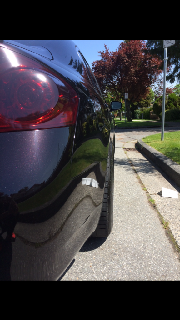

19x10+30 with 275/35/19 just barely clears the fender by couple millimeters still on stock camber
Whew! Thats a close fit.

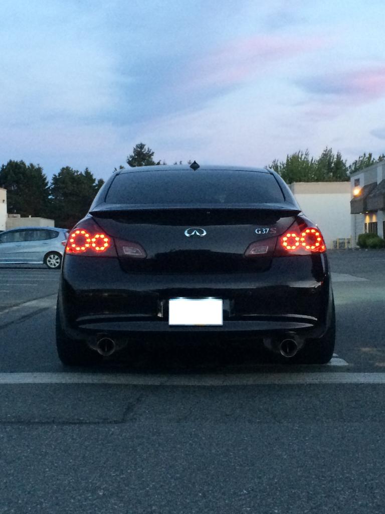

Raised the car a quarter inch (fender arches are 25.75" now) and did my own alignment for less negative camber (from -3.2 to -2.7).
I think the fender might be hitting the tire..
Tony, your car looks great! Love the fitment on that beast.
