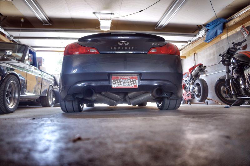

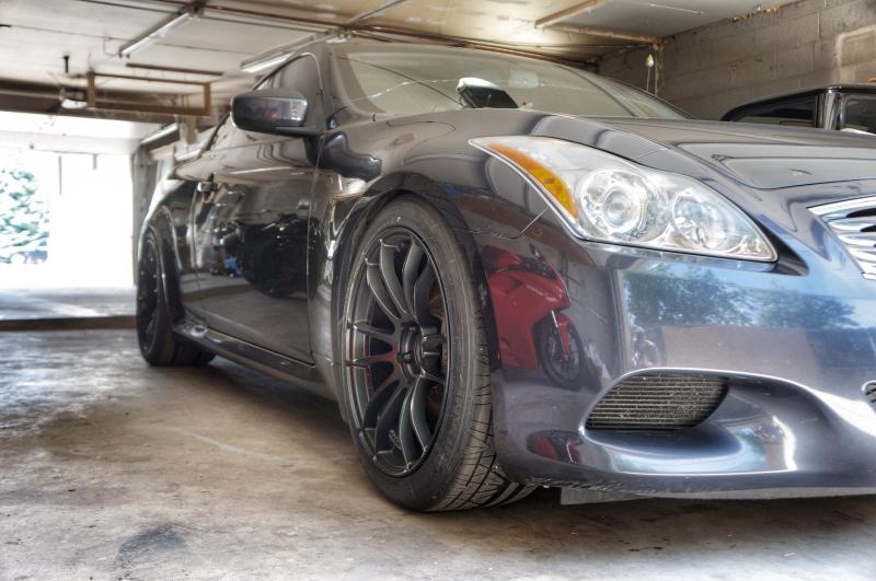

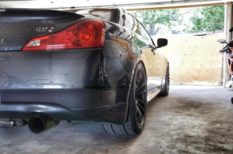

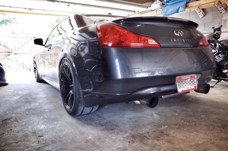

Figured I'd post up.
Gram Light 57xtreme's
19x10.5 +43 305/35 R19
19x9 +35 255/40 R19
Tires:
Rear - Nitto NT05R
Front - Nitto Invo
No rubbing, no grinding. Just bolt and go. You'd probably have to cut down the rear bumper mounting bracket if you haven't already.
Camber is within spec at all four corners.
Old Jun 30, 2014 | 04:40 PM
  #798
Likes: 4,949
Thats pretty balla!^^^^
Big 'ol drag radials too, nice job!
Rear fenders rolled?
How much clearance do you have from the inner lower arm to the tire?
Old Jun 30, 2014 | 05:29 PM
  #799
FrozenBloodPump's Avatar
FrozenBloodPump
Joined: Jan 2011
Posts: 25
Likes: 17
Just the factory roll. plenty of clearance from the lower arm. The bolt however is closer. There is about 3MM of clearance. I drove it hard around some tight bends and the tire didn't flex enough to rub.
If you want to run 305's, this is the setup you want. +43 on the offset and no wider than 10.5.
Are the 37 coupes' flat-rolled like the sedan in the back? I know the 35 coupes weren't so that's what I was going by.
Awesome combo, bet that bad boy sticks like roofing tar
