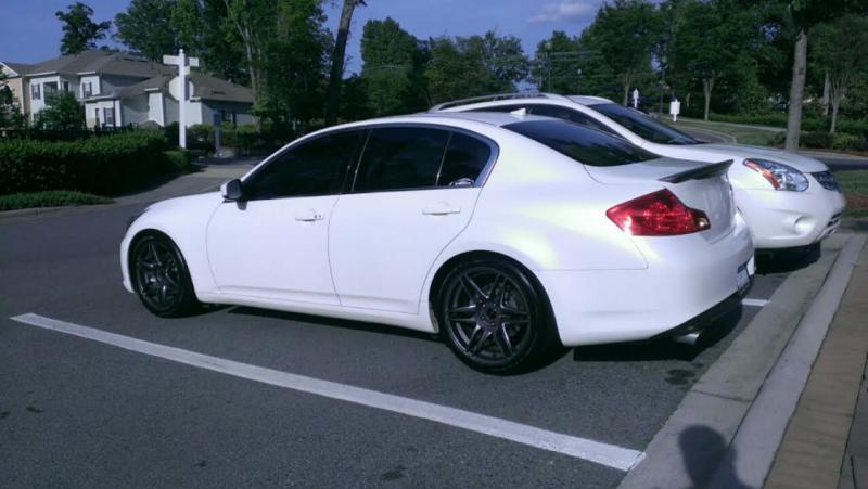

Not sure why I never posted in here, I'm running avant garde m368's:
Fr 245/40/19 (19x8.5)
Rr 275/35/19 (19x9.5)
Sorry for the crappy cellphone pics, I will be putting together a build thread in a few months.
Lowered on eibach springs that are coupe part number specific.

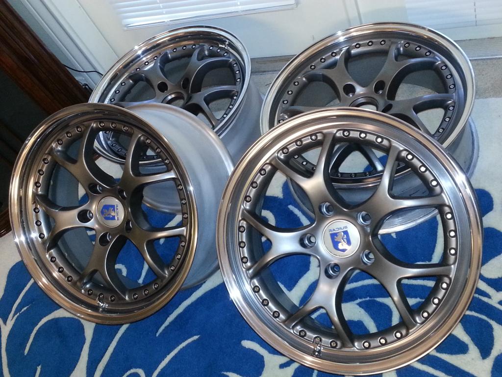

Hi guys, I could use your help getting my odd wheel specs into the fat boys club. I was given some 3 piece wheels with a Porsche pattern that I am running adapters for. After the adapters, I will have the below specs:
19x8.5 +21 Fronts
19x9.5 +31 Rears
I'd like to get a set of tires with a somewhat square profile. My coupe will be on coils with camber arms. I figure I could possibly get a 285/30 or bigger rear, but not sure about the fronts. Any help is greatly appreciated.
FWIW, Here is what is going on.
