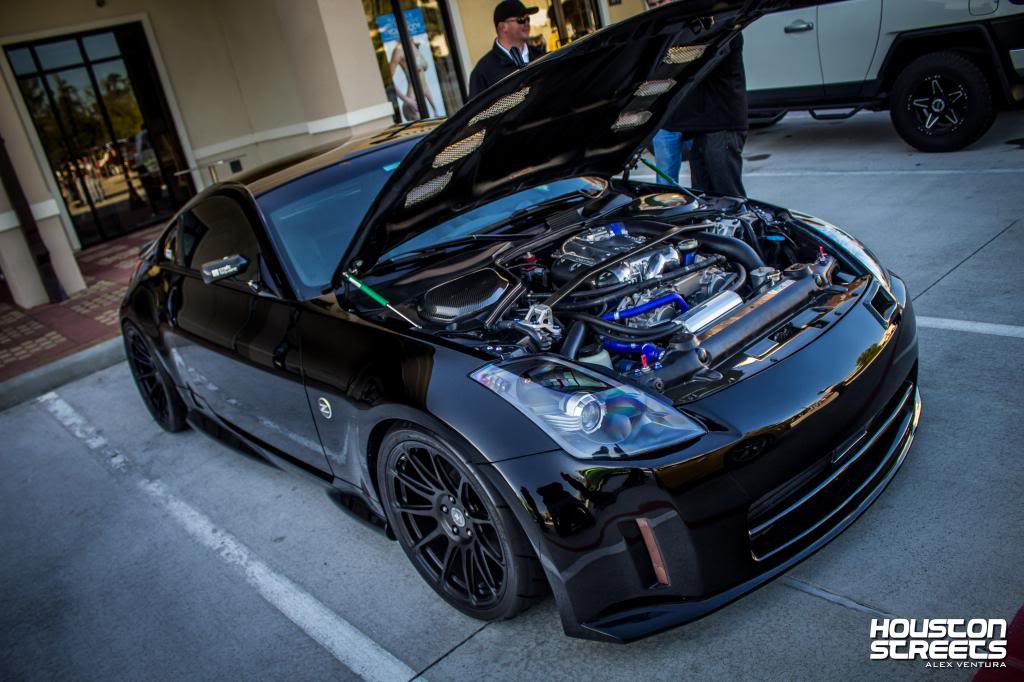

from my Z...

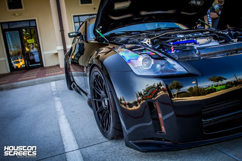

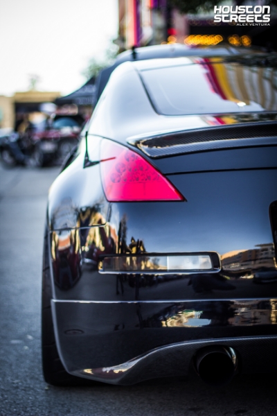

Sneak peak for the G...

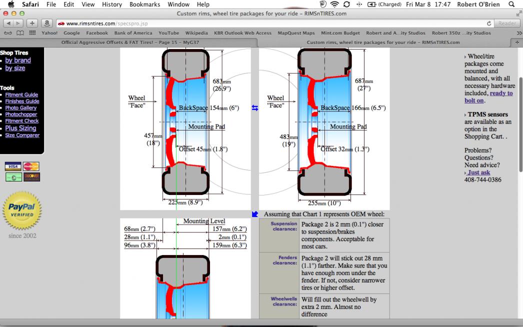

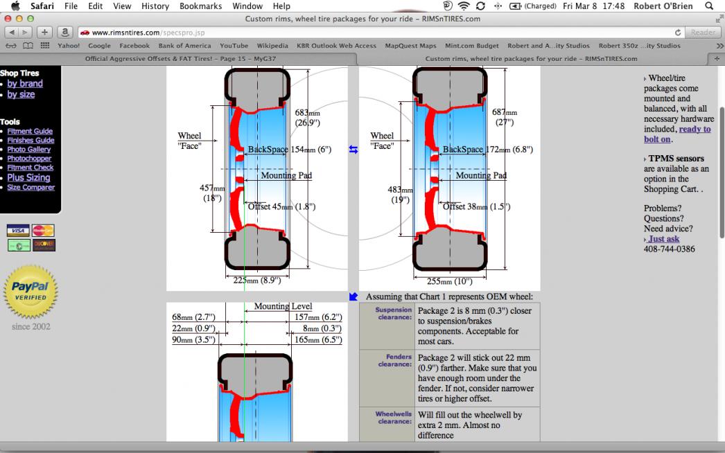

Originally Posted by soundmike
Those specs are very close to my old Rennen set-up, Rob, with dagon's fronts inset a mere 2mm from what i had mine on.
I do believe dagon has a bit more negative camber in the rear, though. I'm also on Swifts now, and with camber very well within OEM specs, my 9.5+38 rim is already extending a bit beyond the fenders.
I'd love to see some pics Mike.
EDIT: See attached. The +32 will net a larger lip, and 1.1" (28mm) further from the outside of the OEM 18" and 2mm closer to the inside suspension.
The +38 will have a 6mm smaller lip than above. It will be 0.9" (22mm) from the outside of the OEM 18" and 8mm closer to the inside suspension.
I'm still leaning towards the +32. Really want to see additional pictures.
Attached Thumbnails Official~Best offsets for running FAT tires!-screen-shot-2013-03-08-at-5.47.42-pm.jpg   Official~Best offsets for running FAT tires!-screen-shot-2013-03-08-at-5.48.09-pm.jpg
