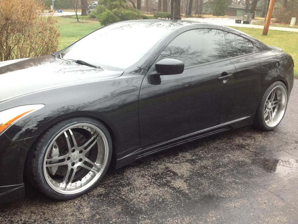

Hi would this fit in this thread?
Specs are front = 20 X 9.5 +13 R-Disk / rear = 20 X 10.5 +16 O-Disk
Work Gnosis -Gs2 in BKB (burning black)
Tires are Hankook V12's 245/35-20 and 285/30-20 my car is AWD. Rear Fenders were pulled about 1/2 cm and running -1.5 camber front and -2.00 camber rear. May lower and camber rears more but I am happy with the setup right now.
Car runs nice - ride is actually smoother that my winter setup on Blizzak's and stock 18's I'm also dropped on BC coils (for the time being - looking into a custom coil/cup kit in the future).
Sorry car was a bit dirty but it is all washed up now!

Nice ride man, sweet rims too
Since Robert K is the threads' originator (and current president of the fatty club) he's going to be running 285s out back so I'd say your G definitely would get into the club. You get my vote

How'd you clear the back brakes with an O disk . Is your offset including spacer specs?

That sure is quite aggressive for the coupe without stretching.. Nice!

nice super aggressive coupe looking good post more pics different views
wish i could put something aggressive like that on my sedan.

No spacers. I worked with Ming @ Fizz autosports -Chicago to get the prefect offsets with the ability to run a fat tire and give a somewhat aggressive stance. He assured me that these would fit and they do. He did assure me to run a 265 max but since I am in an AWD car I went with the "safest" rolling diameter choice.
I will be able to post more pictures probably later this week once it stop raining. I will also be adding hubcentric rings sometime down the road so I'll see if I can get my installer to take a picture of the sticker with the size/offsets/disc on the rim if you would like proof as well.

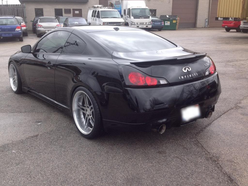

Before Fender Pull

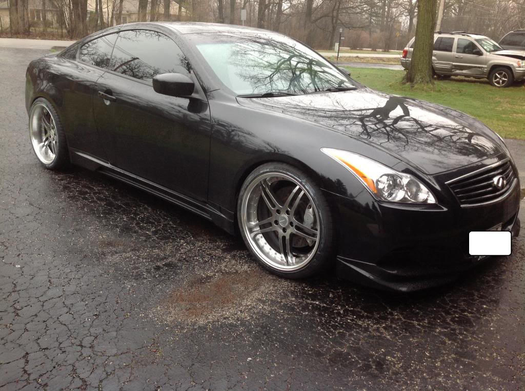

After Fender Pull
Posted the same side of the car to show the difference sorry they weren't at the same angles.

It's cool man, no proof necessary. I was just wondering how that could possibly fit with such a beefy tire haha. So the answer is fender pull ?
