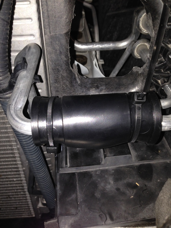

Re-installed the intake and zip tied a piece of 1 1/2" rubber around the A/C lines. Like PongSanity said, make sure to dremel the top of the radiator support hole and not the middle/bottom (like I did). With the rubber insulating the lines, the drivers side sits very tight and shouldn't be a problem.

Hey guys, I'm an aircraft mechanic, let me suggest you wrap the AC line with
Spiral Wrap Abrasion Protection and Heat Shrink.
It's a hard heat resistant plastic coil that winds around any tube that prevents chaffing that we use on aircraft. Also If you are going to use the rubber hose to insulate instead let me suggest that you do not zip tie it to the pipe as the plastic zipties harden with heat and then will simply shatter/crack and fall off.
If I were to put the hose there I would more than likely Use .032 stainless steel safety wire to secure it.
Another alternative would be some decent small hose clamps.
Zip ties are a bad idea when it comes to any areas subject to heat exposure.

Hey guys, I'm an aircraft mechanic, let me suggest you wrap the AC line with Spiral Wrap Abrasion Protection and Heat Shrink. It's a hard heat resistant plastic coil that winds around any tube that prevents chaffing that we use on aircraft. Also If you are going to use the rubber hose to insulate instead let me suggest that you do not zip tie it to the pipe as the plastic zipties harden with heat and then will simply shatter/crack and fall off. If I were to put the hose there I would more than likely Use .032 stainless steel safety wire to secure it. Another alternative would be some decent small hose clamps. Zip ties are a bad idea when it comes to any areas subject to heat exposure.
That's a good tip, also, anyone who installs these and protects their AC lines should add a visual inspection to their regimen.
