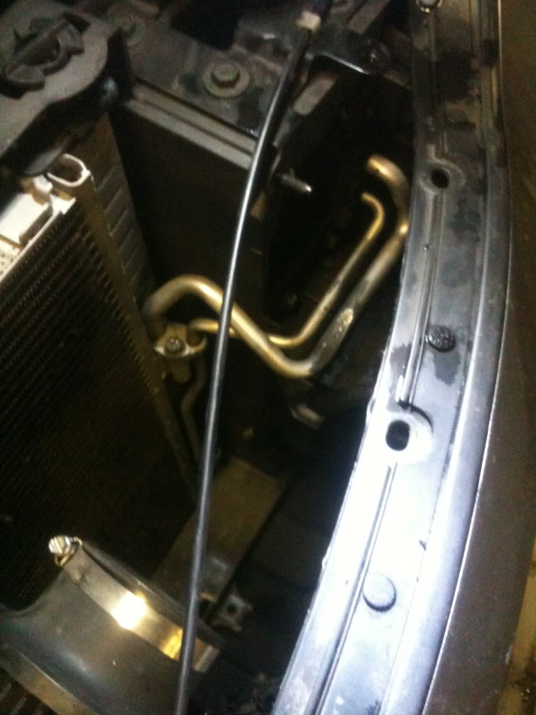

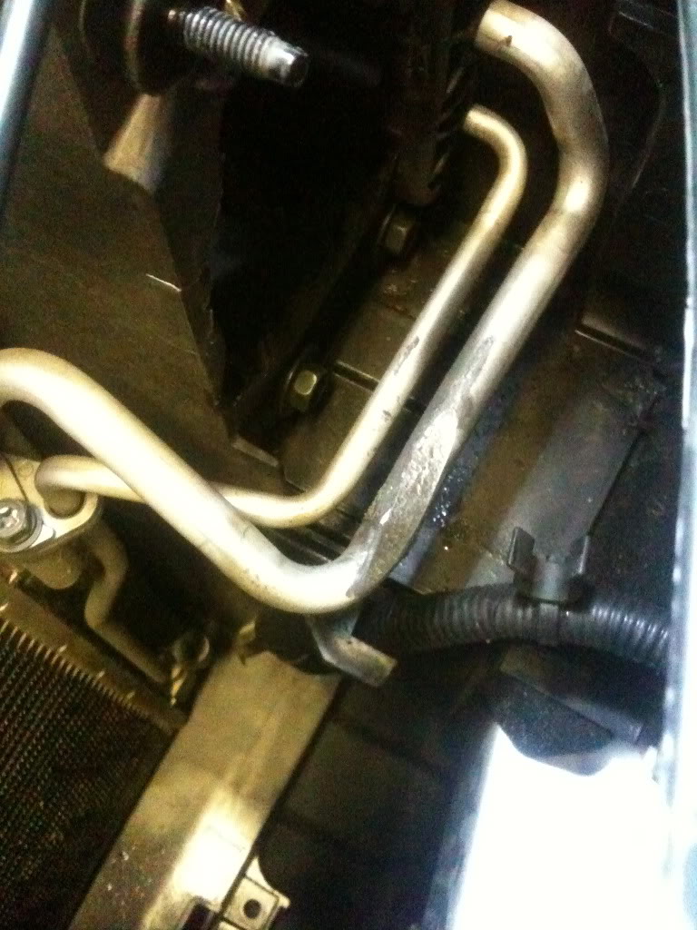

This was mine with my stillen. I was told to pay $117 for the part from infiniti. I called my nissan dealer and got the ac line for $23 for a 370z and it it myself. Advance sells ac line wrench kits you just have to get it filled then by a reputable place
This is exactly the line that they sold me to replace. I'm going to get out there today to see what I can figure out. Hopefully it's an easy swap and won't take too much time, but we'll see. I'll take some pictures of the job too and post them up here.

Update.
I just took apart my car, took as much of the intake off as possible without taking off the front bumper and found this. I originally had a piece of rubber ziptied to the area, but the zipties must have broken off because the rubber is still there hanging loosely around the ac line. Looks like a long days work and it's about to rain...silver lining is that it looks like I only have to replace the larger of the two lines.
