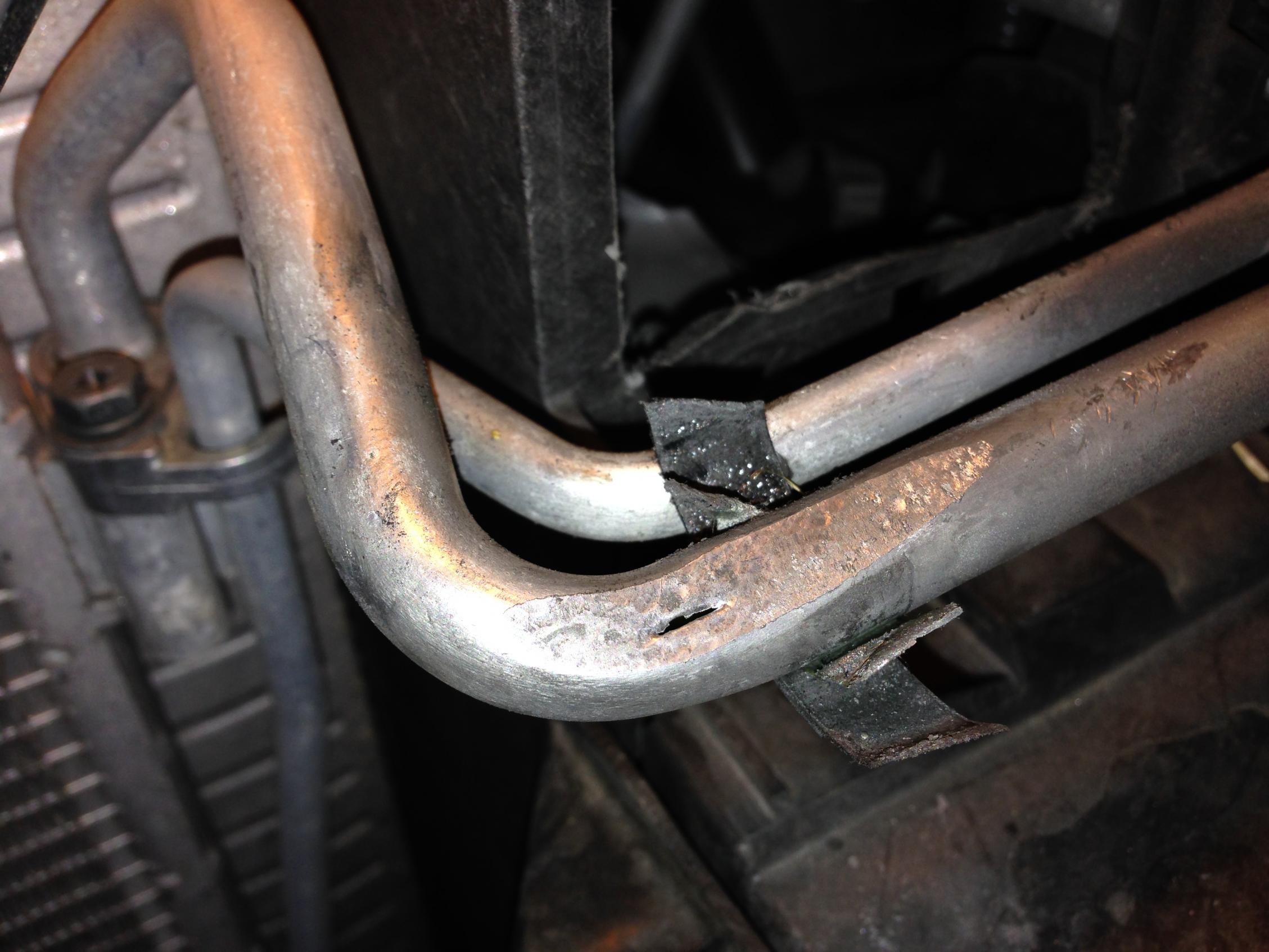

Old Nov 27, 2013 | 02:30 PM
binny408's Avatar
binny408
Posts: 6

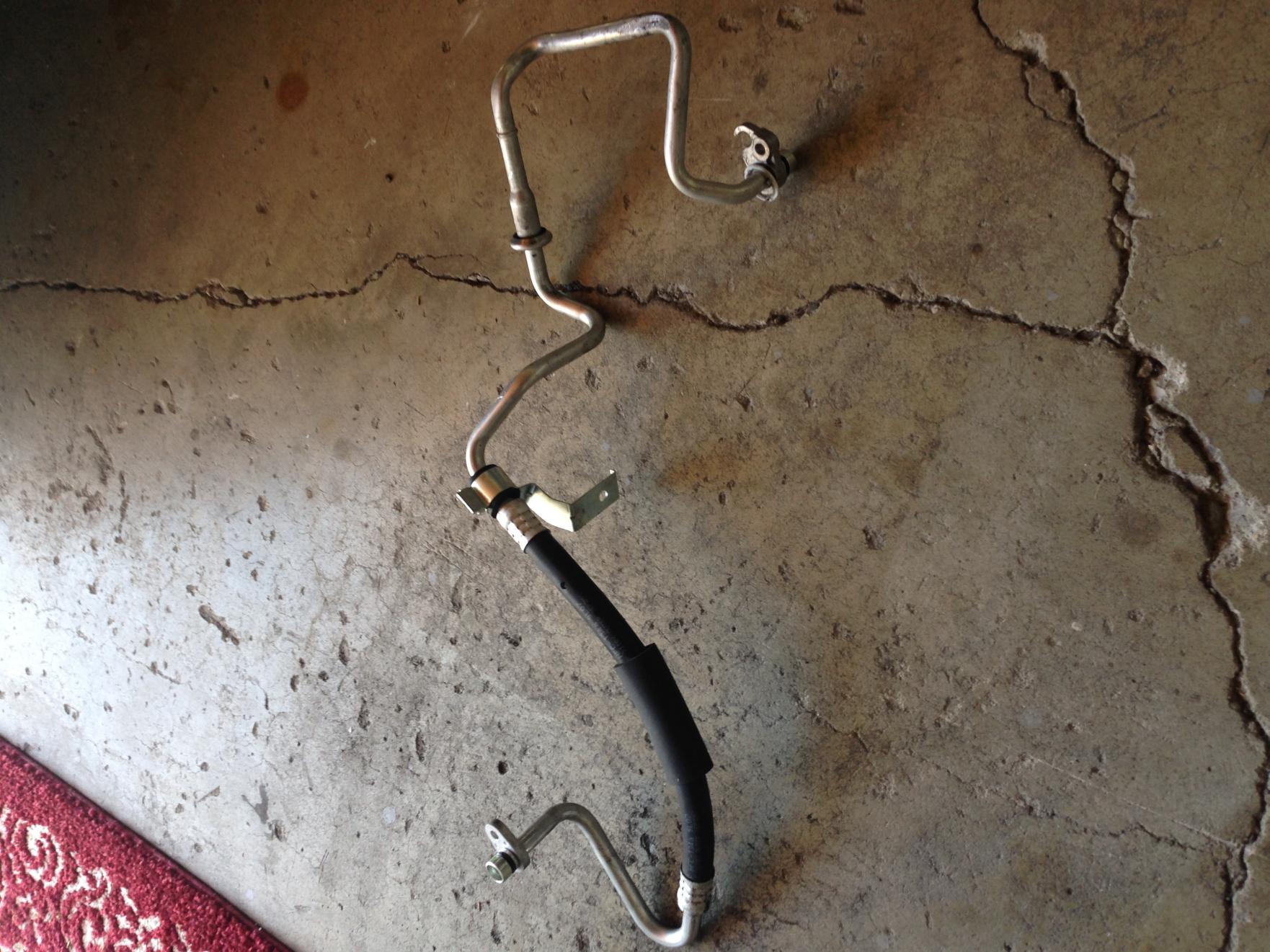

I just ran into the same exact problem and Infiniti quoted me $850 to replace this!
So what I did was took out my Gen 3 intake, took out the line (super easy), and replaced it. I bought the replacement part for 60 bucks on ebay. The part number for this specific pipe is 924403WK0A.
924403WK0A | eBay
Let me know if you have any questions, this is a super easy DIY fix!

you paid way to much for that part... its only 34 bucks at the dealer

There is a hose included with the Gen 3 Intake Kit. It says in the Instructions to wrap the A/C Line with it. We haven't heard of any issues with the Gen 3's rattling but not everyone reports small problems like that.

@mpegripper The Intake kit comes with directions on how to install the Gen 3 intakes so this doesn't happen. People just don't read them and use all the parts in the kit. None of the kits that have been installed correctly have had this problem.

I've had Stillen 3s installed over a year with no issues. If you install yourself pay attention to detail. If you let someone else install check behind them. Simple stuff. The mod is worth it IMO.
