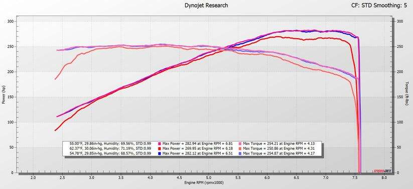

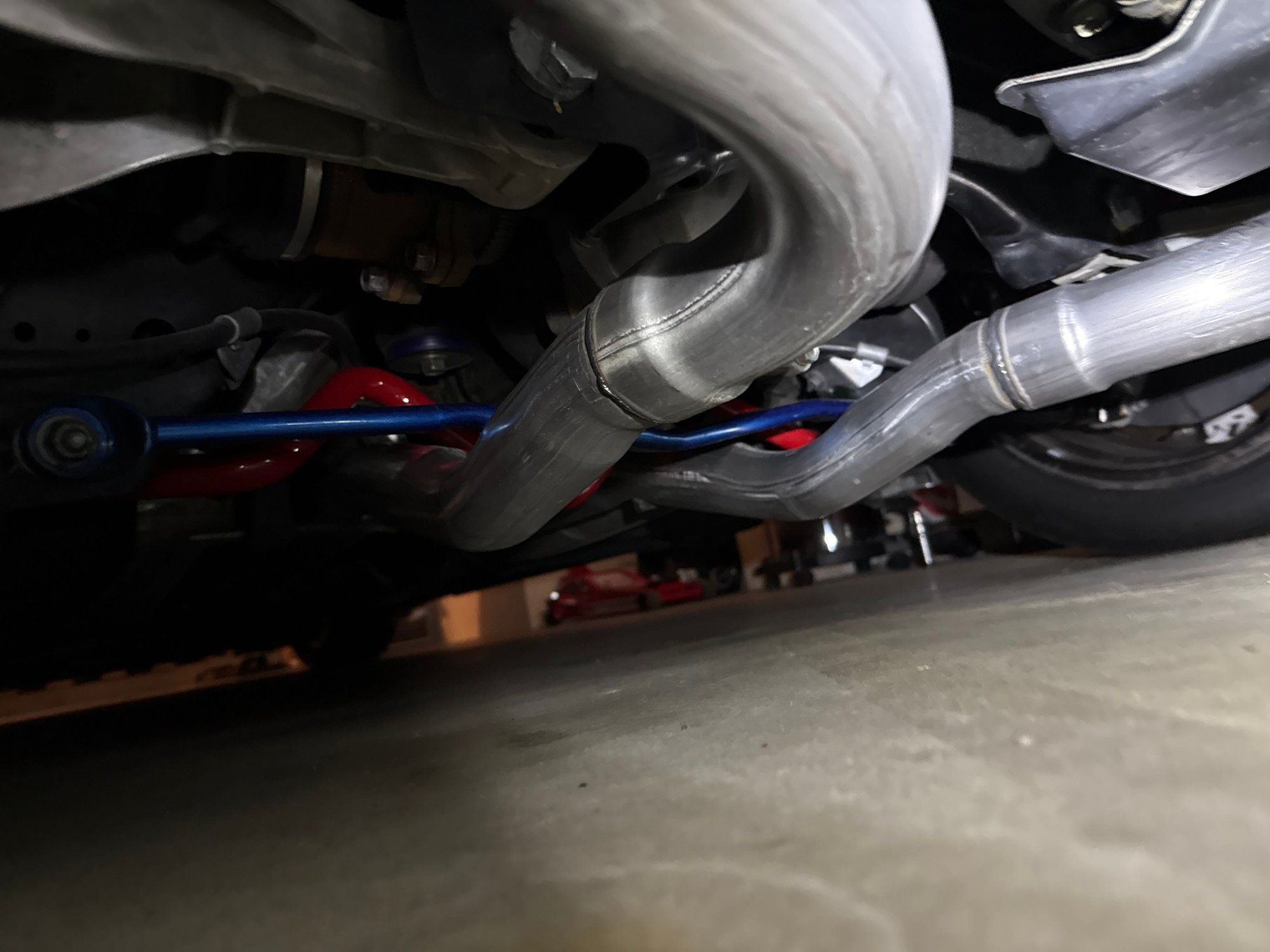

That's a lot of things all at once. Customized exhaust and a tune... awesome. Those Sebring cans and tips are gorgeous.
Thanks John. The exhaust was supposed to happen earlier this month, but I struck out at the two shops I normally use as many seem to shy away from brainstorming style custom work.
Note in the second picture that the midpipe needed to be reconfigured and bent inward to make it through that rear tunnel or otherwise it would have rattled.
Also, I had to use the ST 17A-22B mufflers without the tips already added because the version with the tips (shown in a few of the pics) was not long enough to sit in the hanger and extend to the edge of the diffuser cutout. James from Sebring Tuning provided a set of both mufflers, so we could verify. He brought this up because he recalled Fast Intentions ran into this issue as well when they build their catback around the same mufflers.
I always thought that there would be alot of tradeoffs moving to larger tubing (1.8" to 2.5"), but really the only one I notice is the added noise as car seems to behave much better across the entire powerband.
Looking forward to the tune as I have already learned a ton from Eugene.
Hard to believe that he can get these numbers from a stock setup and still maintain CARB/Emissions compliance (orange/red are the stock ECU flash):
Don't just look at the peak numbers, but first at the beginning of the curve and where the HP/TQ starts with the tune in place, then look to the right at 5500 RPM where the car is making more power past where the rev limiter normally cuts in.

I've never had the car on a dyno. And while it would be a fascinating event, I wouldn't have any before/after scenario to compare, so the whole point would be peak number bragging rights and comparison to other people's runs. All that being said, I'll probably never do it now.
I know I'm a noob about dynos (I'm not proud), but I think it's a fair statement that peak numbers aren't worth squat for a daily driver. We live in two places: response off the line, and midrange as you climb the gears. Going WOT in a high gear means nothing if you're just rowing up the highway ramp. And even though I don't have dyno proof, I clearly recall my butt-dyno reaction of a fatter midrange after working with Eugene. You're going to love it.
I'm honestly not interested in the dyno either. My interest lies more in how he manages AFR, knock sensor sensitivity and timing to make improvements over the tradeoffs Nissan had to make when they created the stock tune. 7AT shift quality is also an interest.

Man, I really wanted to add that Cusco Power Brace. My Stillen catback doesn't have that bend at the axle so it won't work for my setup.

He spent a lot of time (and curse words) on the angle needed to clear that power brace. The factory 1.7-1.8” midpipe (smallest diameter is near the axle) cleared it with ease, but the 2.5" piping needed work.
