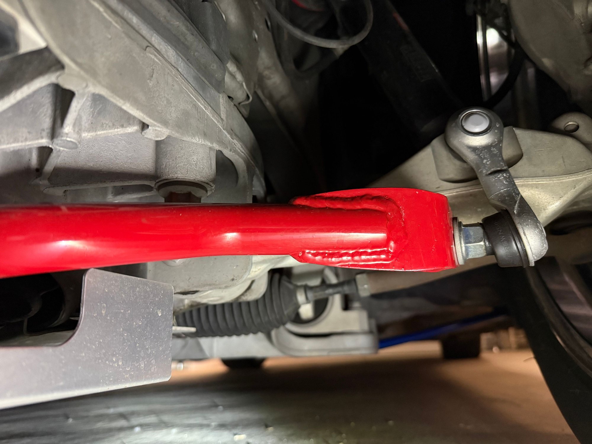

All of us that are lowered experience bump steer as the tie rods should be approximately parallel to the lower control arms to minimize bump steer. My understanding is that when they are not parallel with one another, random changes in toe occur, which is that feeling you get when you hit a bump and it feels like the car is directing itself to the left or right.
The adjustable ones allow you to stack washers and change the height of the HEIM joint, creating a levelling effect: https://conceptzperformance.com/spl-...35_p_28787.php
A few other companies make these and I am thinking about adding a set when I upgrade my dampers in 2026 as both changes require an alignment.

While installing the coilovers and arms I also went ahead and threw on a GKTech angle kit which relocated the outer tie rod pickup point. Luckily this also seems to have kept my geometry pretty standard as the arms are essentially parallel with the chassis. Not sure you'd have the same outcome at this height with the stock stuff.
Can you link to the kit that was installed? Also, any possibility that you could snap a pic of the install and include the lower control arm? I'm curious as to how badly mine is off. I can reciprocate and try to get a pic on my side so we can compare. Not sure though if a pic taken with the car jacked up and the wheel unsupported is the best way to compare though...

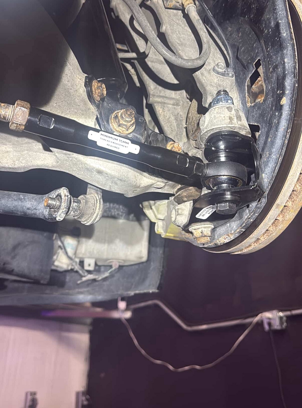

https://us.gktech.com/products/z34-3...lock-angle-kit
That's the only photo I have from the install, I'll try to snap another one today with the car on the ground.

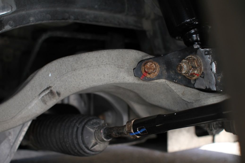

Still a bit of an upward angle, but not too severe (plus a bonus shot of where my tire rubs the arm at lock).

I owe you a pic of my current setup. Was able to squeeze my arm under there with no ramps, so this is how it sits naturally.
In the first pic, I see that the tie rod is not parallel with the LCA (angle looks similar to yours), but when I go to the rear of the wheel, it almost looks parallel.

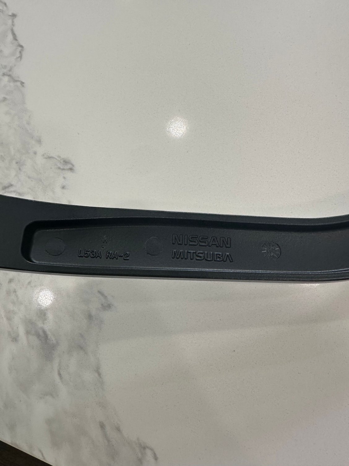

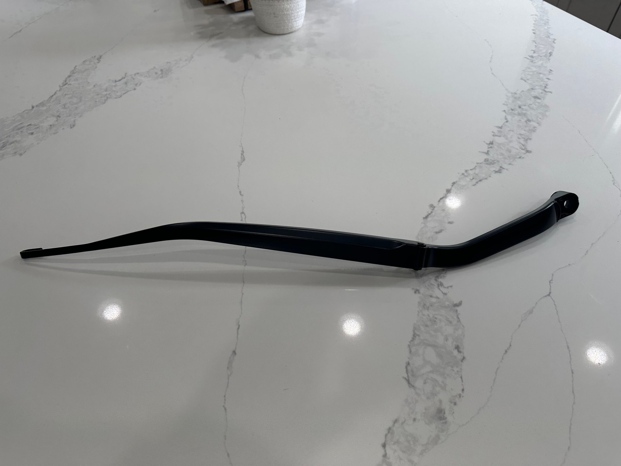

Received new OEM wiper arms. Originals were faded so figured this was an easy update.
To be installed….
To be installed….
Part number? Price?
Old Oct 27, 2025 | 07:38 PM
  #10585
JZ39's Avatar
JZ39
20 Year Member
Joined: Jan 2005
Posts: 181
Likes: 110
Originally Posted by RobC7
Part number? Price?
28881JU51A
28886JK000
$42 each plus shipping and tariffs on Amayama. Be sure to get new covers as well for the bolts.
28881JU51A
28886JK000
Walking this one back with corrected information.
28886JK000 is the right (drivers) arm for a RHD G37. It is bizarre because it is a quite different shape and longer than the US drivers arm, yet it fit perfectly and all wiper coverage is good.... I really can't explain this, as the two have very different geometries, yet it works. I should have taken a picture side by side before I installed it. Hard to get a good picture with them aligned while on the car.
28881JU51A is either not available or would potentially take months to get, so I canceled this one. Not enough bang for the buck to wait and the tariffs are making these parts more expensive. I am SO glad that I got all of my parts from Amayama before the tariffs hit.
Looks like the correct US numbers are:
28886-JK65A for right arm
28881-JK600 for left arm
Both are $159 in the US, so, pricey for minor gain.
