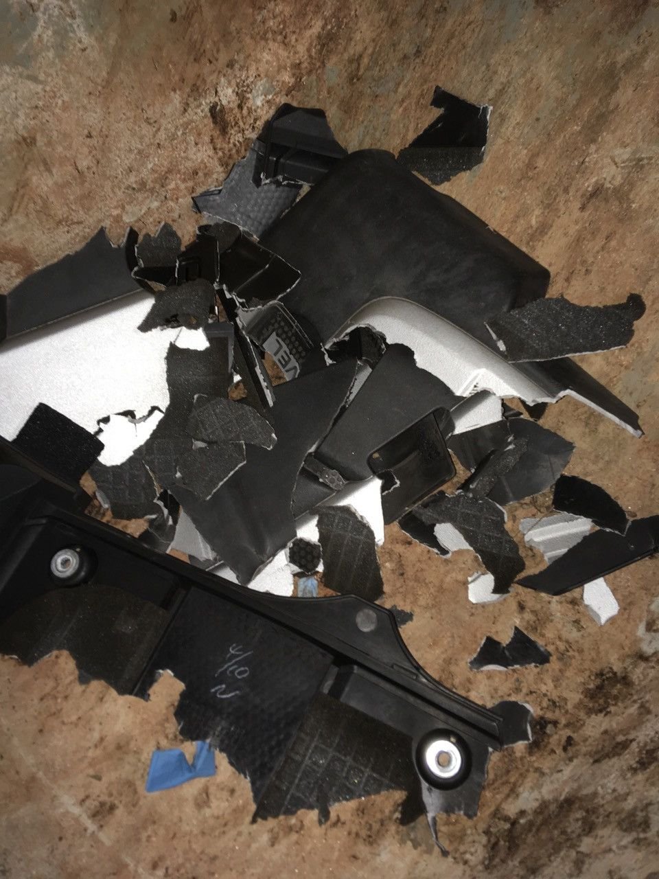

When I tightened my engine cover yesterday, all except the rear bolts never seemed to get tight. I'm guessing I used about 15 ft-lbs of torque or so when I tightened them. When I subsequently tried to remove them, they just spun indefinitely without backing out, even when pulling upward while unscrewing via vise-grip. I'm kicking myself, as those bolts were basically the only bolts for which I didn't use a torque wrench. To my belated understanding, the only bolt that really matters is the center one, as that's the one that can compromise the plastic upper intake manifold/plenum.

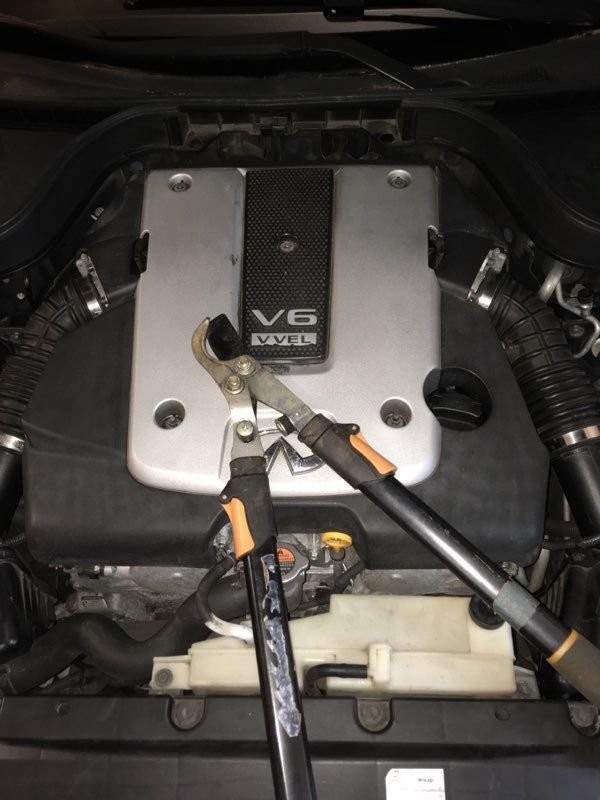

To remedy the situation, I recommend the OEM engine cover remover. If your dealer doesn't know to what you refer, let them know it looks just like a Friskars, and that should let them know how best to provide service to you.

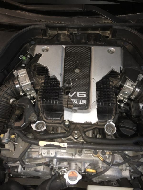

After encouraging the engine cover's removal, I cut away at the center bolt's o-ring-esque rubber, and was able to get just enough of bight via vise-grip on the engine cover's washer-like metal backer that otherwise spun freely with the bolt while unscrewing the bolt with a socket....
...that inexplicably worked in allowing me to remove the bolt, which doesn't make sense to me since that wouldn't hold up the bolt I wouldn't think.
Vise-grip is biting on the engine cover's washer-like metal backer, not as it may perhaps seem on simply the bolt's washer.

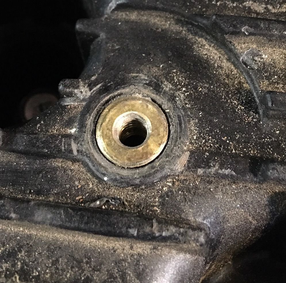

Once ACE Hardware is open this morning, I plan to get a replacement center bolt at half the length of the OEM one, add some blue threadlocker, and see if that's sufficient to salvage the plenum. I'm concerned the entire metal insert in plenum may be compromised though, so I'll likely add silicone sealer around it.
In the bolt pic, center bolt is in the foreground. The two bolts in the upper area of the photo are the two rear bolts that were removable without issue. You can see the vise-grip markings on the engine cover's metal backer. The center bolt does not appear be stripped. I'm concerned the plenum's entire metal insert may be what was spinning freely, since why else would an unstripped bolt spin freely without being removable? (Perhaps when I vise-gripped the metal backer perhaps just a tiny amount gripped on the plenum's entire metal insert to resolve the situation. But I don't see any vise-grip markings on the insert.)

Got back from the hardware store. Used the shorter of the two options I bought, added some blue threadlocker, and lightly hand tightening with a just a socket showed that indeed the metal insert in the plenum spun rather readily. Accordingly, with the bolt only half inserted, I surrounded it with what I had on hand (Zap-a-dap-a-goo), very lightly tightened down with a readily cleanable open end wrench, and then rather liberally slathered additional goop around the bolt head edge / metal insert edge area.
