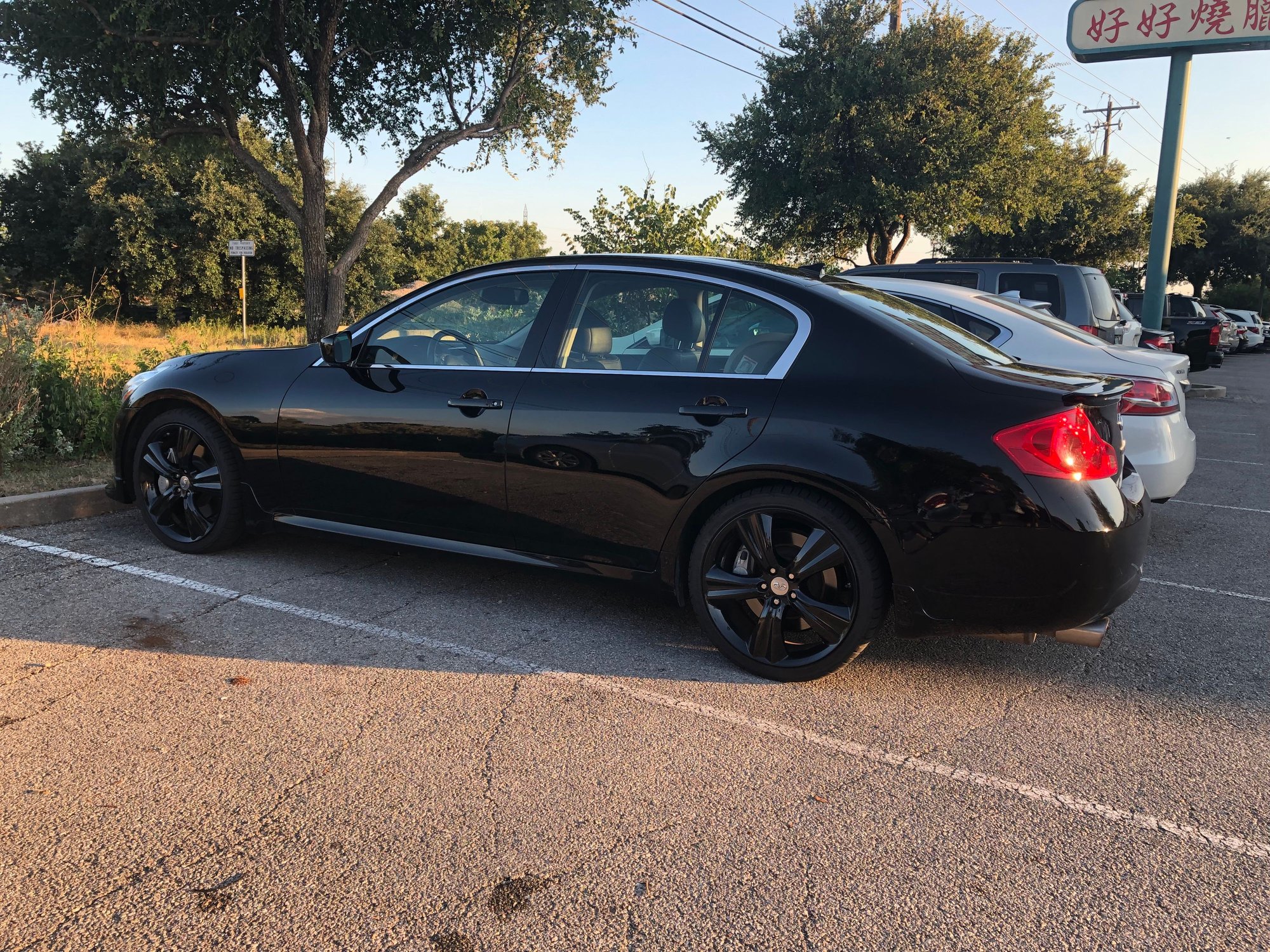

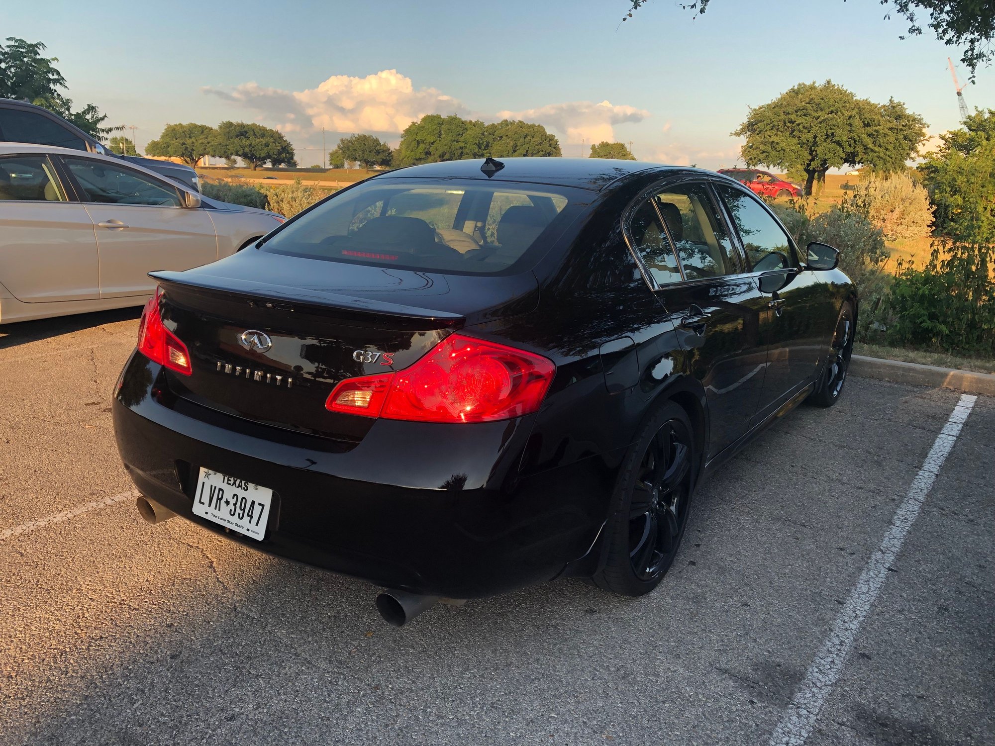

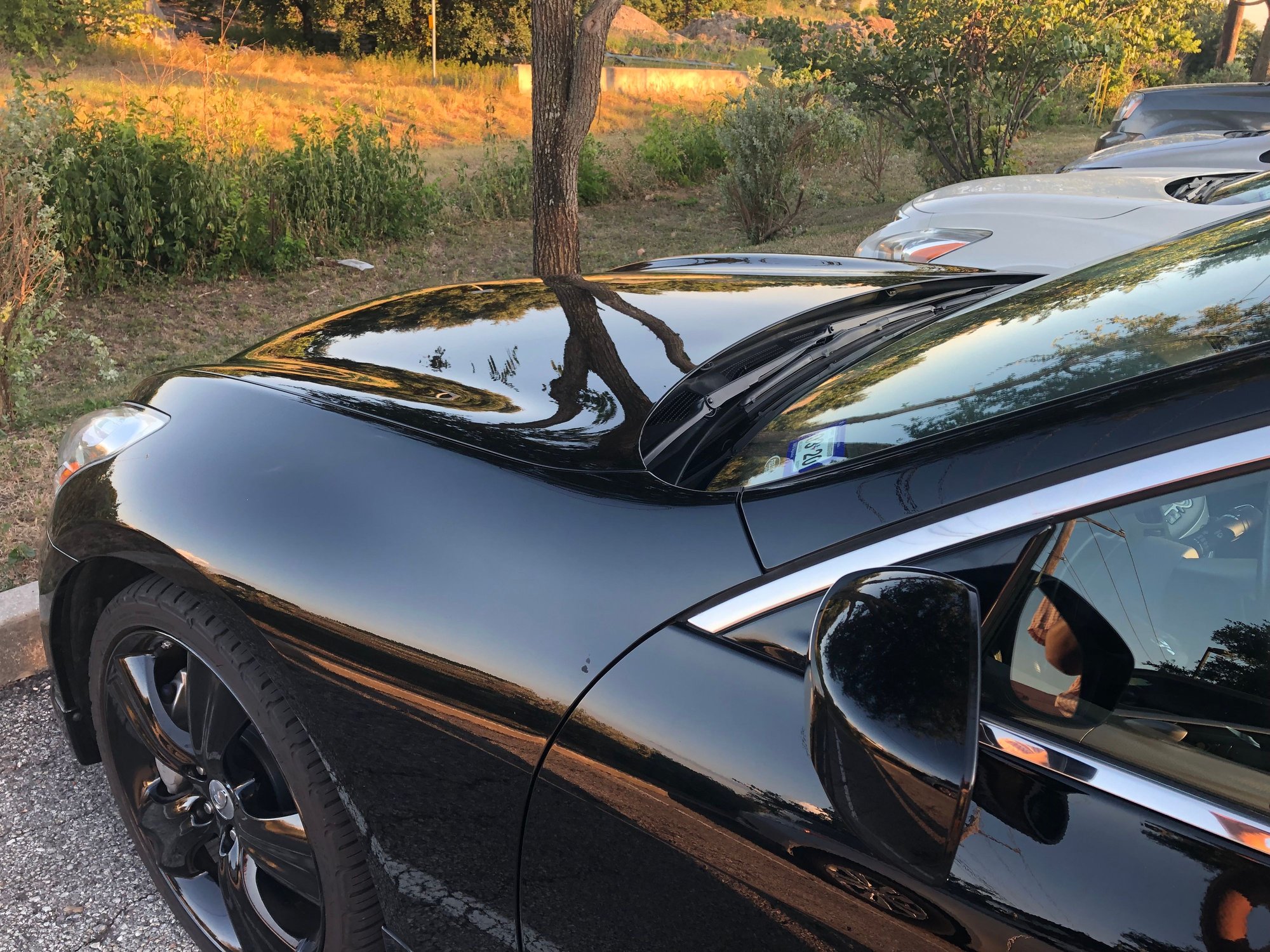

Washed clayed and sealed with ultima paint guard plus. Still need to polish exhaust tips.
