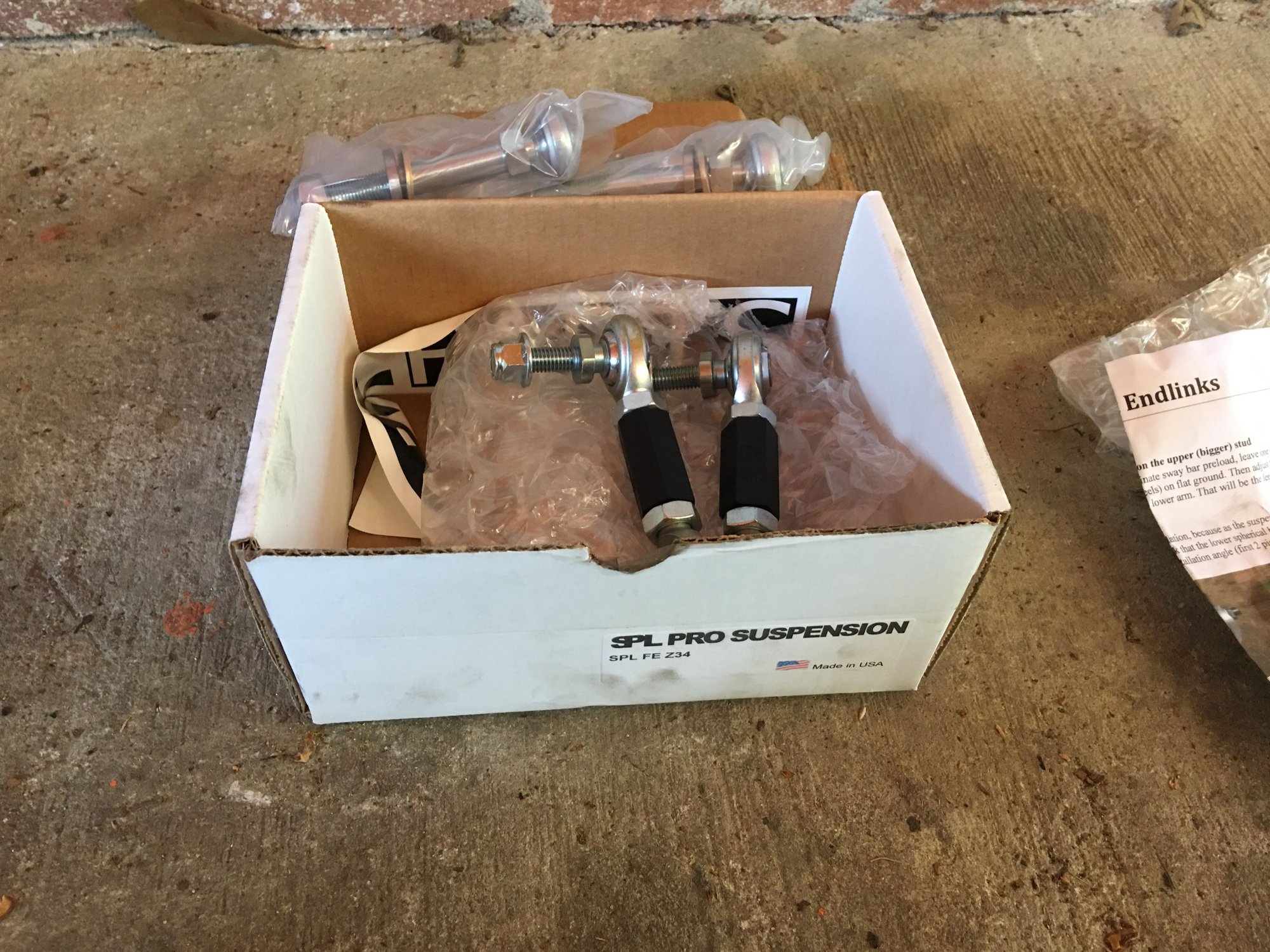

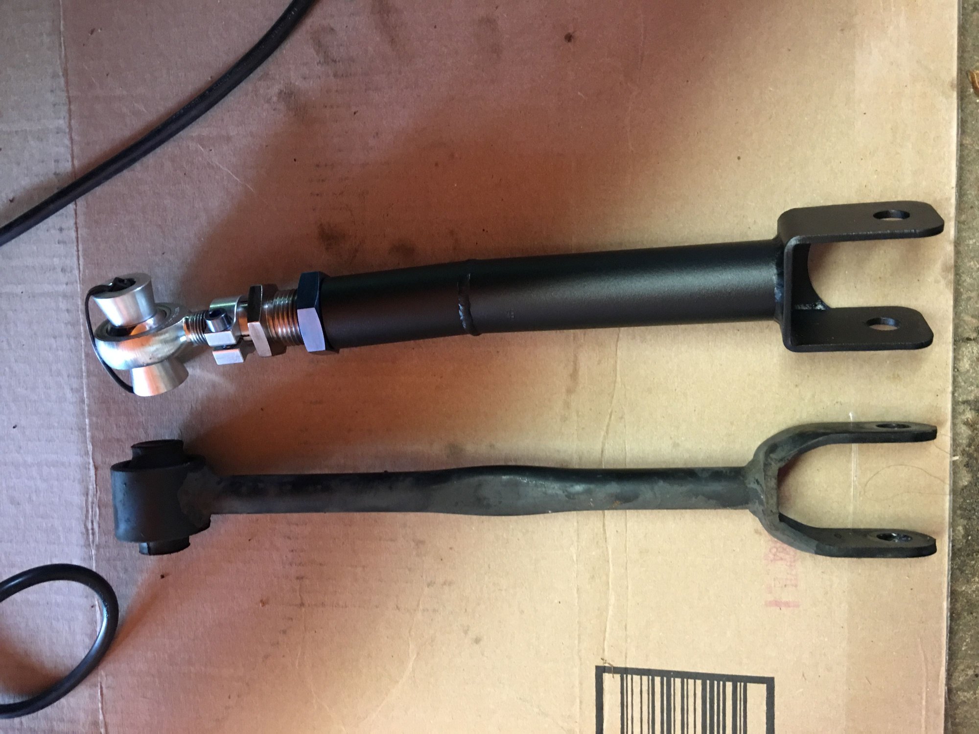

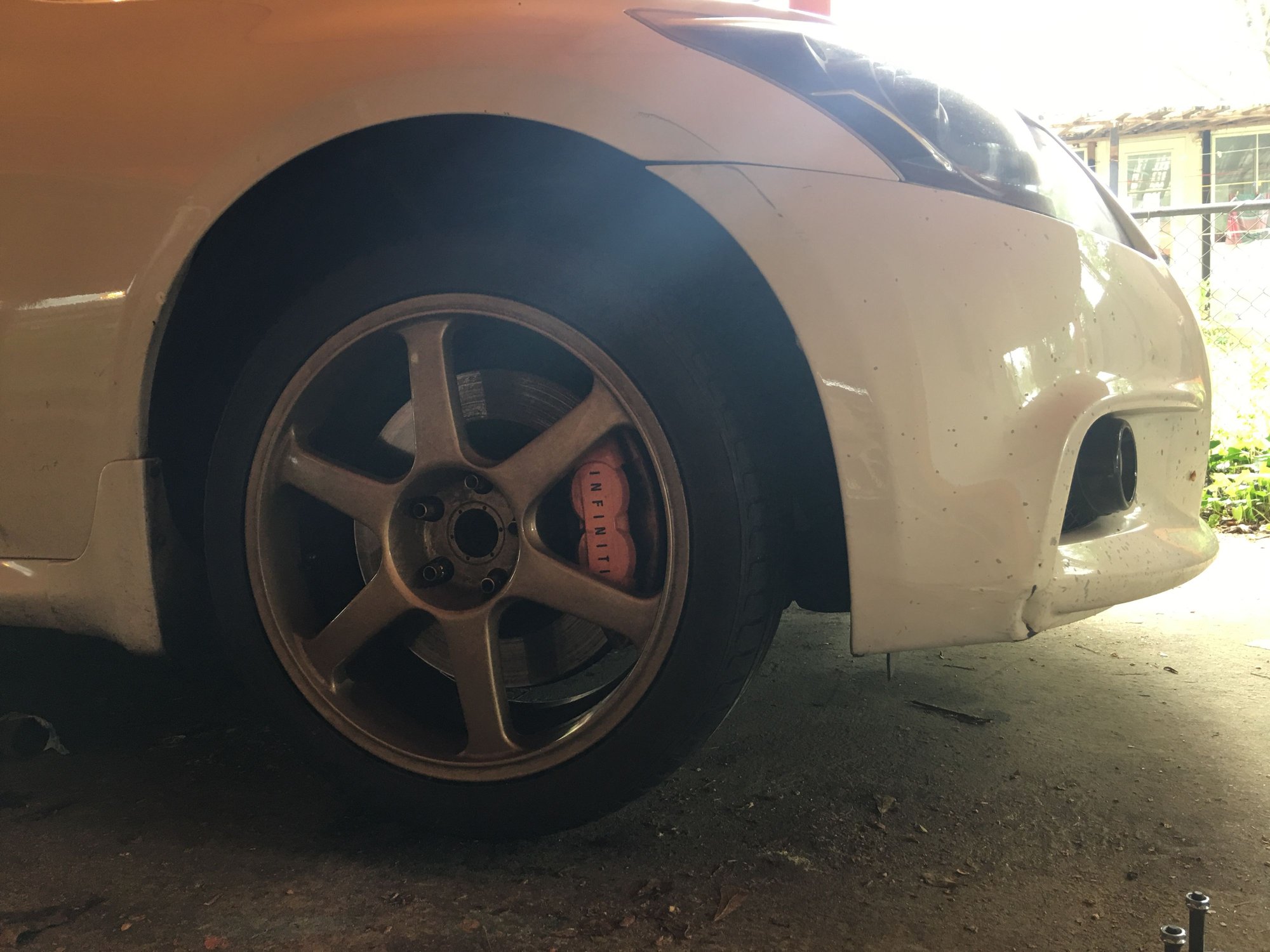

My long distance commute and alignment killed my tires. Going to have to temporarily run my spare wheels up front and move the current front wheels to the back.

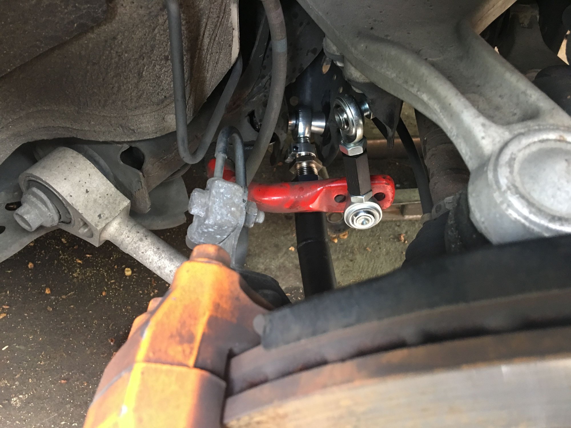

I also went ahead and installed my SPL rear camber and rear end links. I haven’t had enough time to finish installing the front upper control arms. Maybe I’ll finish today.

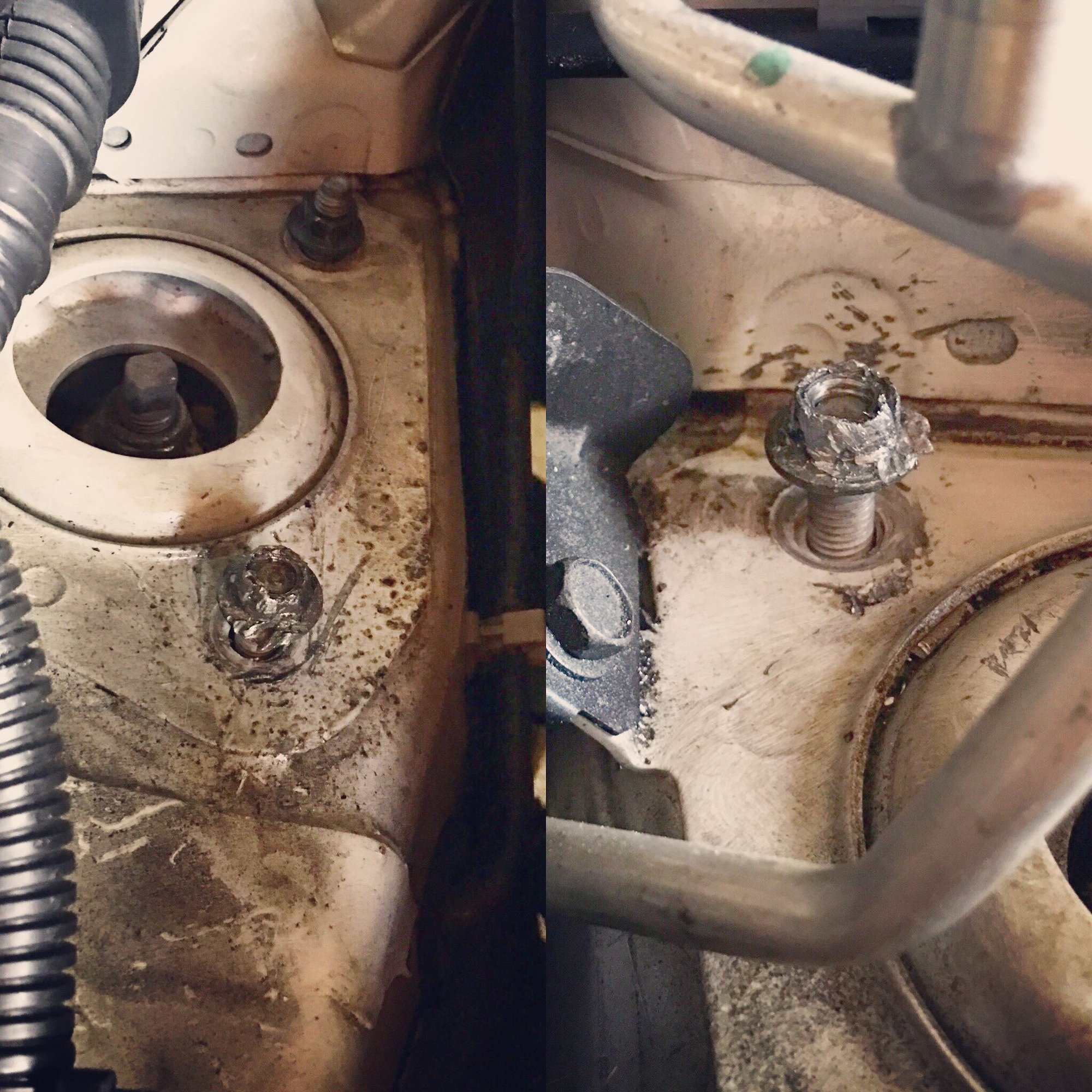

I’m currently lowered on H&R springs and just wanted the peace of mind knowing that I can adjust the camber and caster as I need. But I want to run a bit of camber in the front for sure though maybe -1.5 to -2 degrees.
I was struggling to remove the last nuts on each side.

oh no! The wrath of the vise-grip.
Next time spray PB blaster, heat, and applying blunt trauma to the nut via a socket to protect the 6 pt nut.

The previous owner had partially rounded the nut off and didn't leave much for the socket to grab. I heated the driver side up to get it off. I am sad at how scratched up the shock tower is. Would have a 6 pt socket impact work? I wonder if that could have saved my time and effort?
