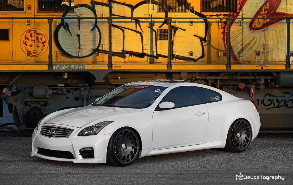

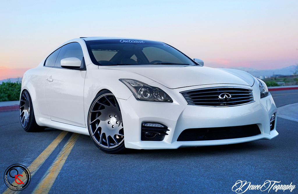

I mounted these up a few weeks ago

Old Feb 20, 2017 | 07:23 PM
  #2195
hotdawwgman's Avatar
hotdawwgman
Joined: Jul 2008
Posts: 491
From: Garden Grove
Old Feb 20, 2017 | 08:32 PM
  #2196
Likes: 4,952
93owner, hopefully your tires didn't get too worn w/ that toe being out, how long were you driving it that way? Specs look great now
hotdawg, wow, quite a dramatic setup you've got there, those wheels are tight!
Lookin' REALLY good, Mark! Really liking those wheels. They are very different but suit the car perfectly.
