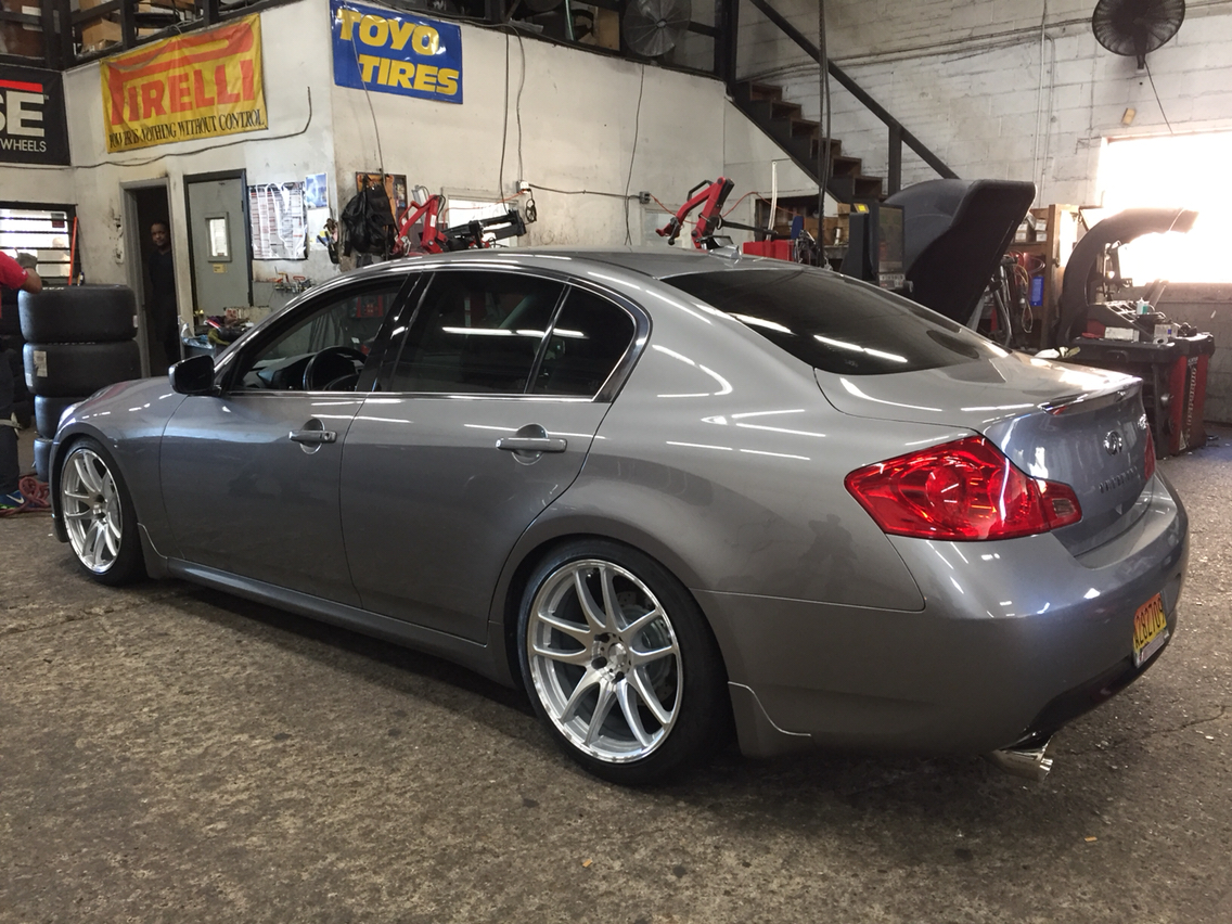

New shoes installed for me as well! Love this setup way more than the last one, but still got to dial in the perfect fitment.

^Looks great! What wheels are those? Specs?

ESR SR08 silver machined, 19x9.5 +35 all around

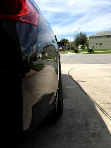

You guys are right. I just need to get it aligned before doing anything. The mild camber is making the top of the wheel tuck into the fender and that's not what I was aiming for.

You might want to leave some camber in there, otherwise you could rub or hit the fender on bumps

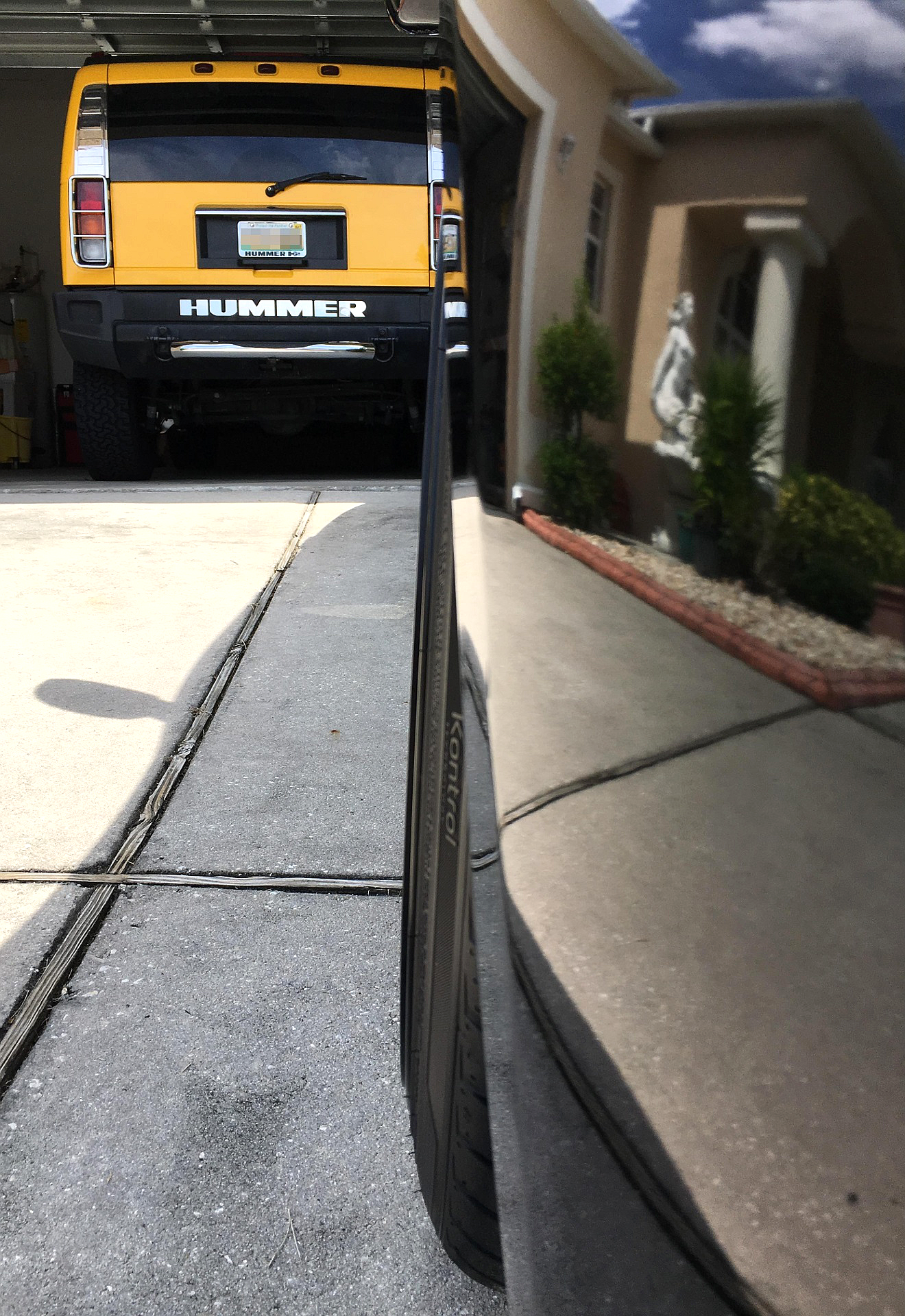

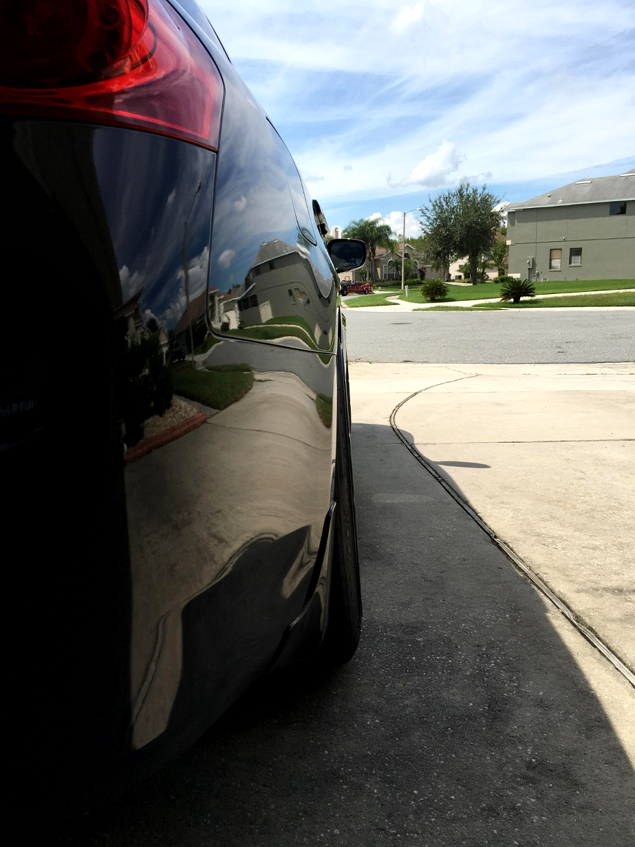

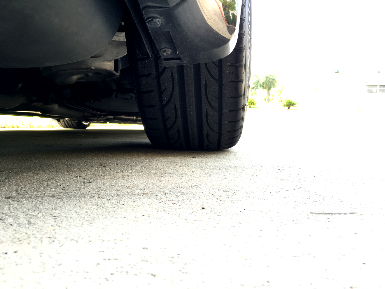

Don't think it's too much?

Get it aligned before doing anything else. I don't have camber kits and my camber went from like -3 to -2.3... which doesn't seem like a lot but it actually made a big difference.
As far as the spacer, i measured from the outer edge of the tire to the inner edge of the fender

Hard to say just from those pics but I'm guessing you're in the -2.5 range, getting it around -1.5 should get the top edge of those tires about a 1/4" closer to the fender and should get your fit just about spot-on.
