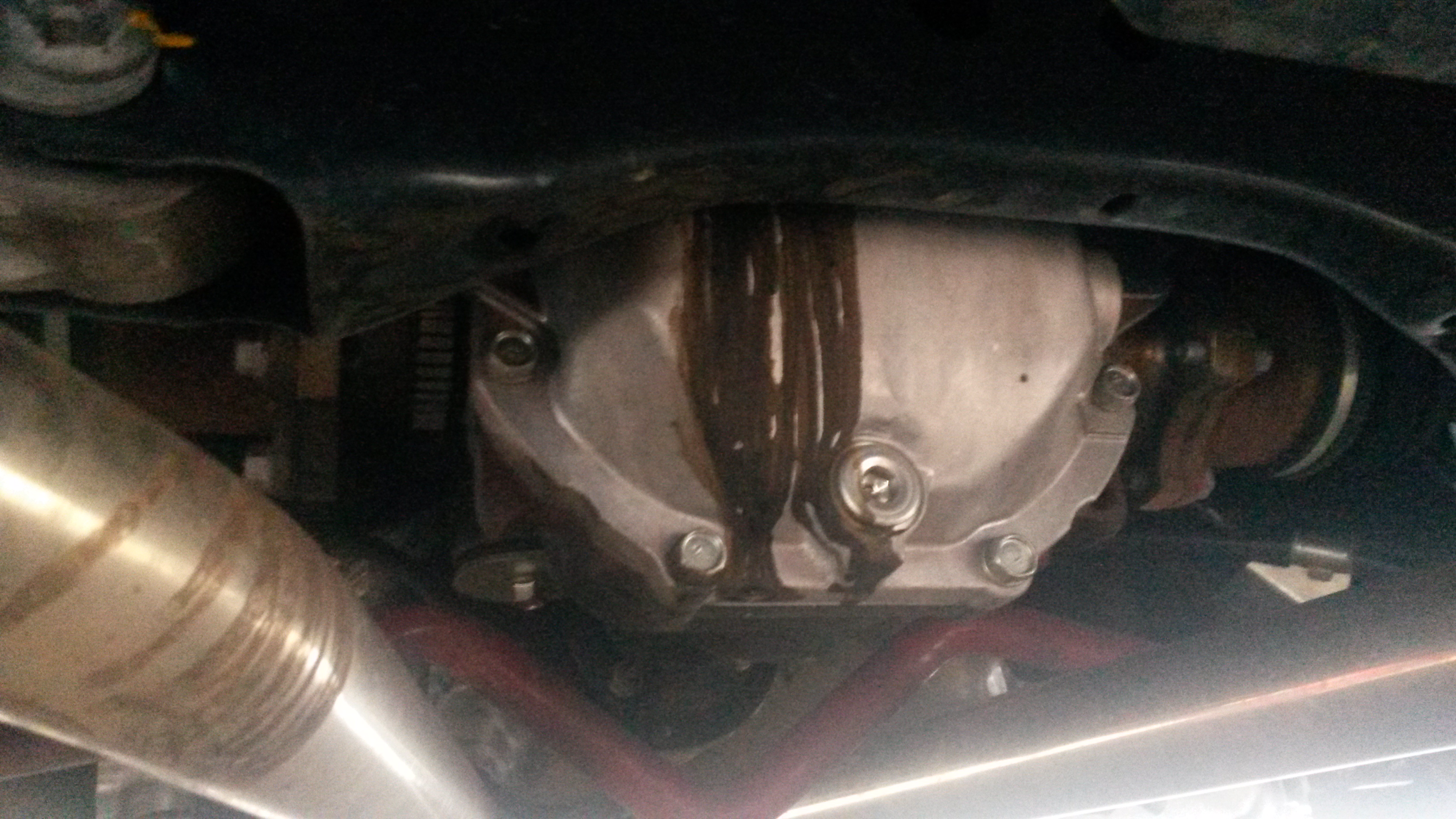

Lego_Maniac's Avatar
Lego_Maniac
Posts: 4,042
Likes: 528
From: Charlotte, NC
Originally Posted by Jsolo
^^Appears your bush is leaking. Still got warranty on that thing?
Yeah, I have the elite extended warranty.

Sure looks like it. I didn't know that was a known problem, or common enough to be dreaded. Damn.
It's kinda like that damn CSC
Doesn't Energy Suspension make a solid poly replacement? That's been on my list for whenever I get the rear gear swap going. Wait, here it is:
https://www.z1motorsports.com/suspen...et-p-5229.html
A little added NVH, but a more responsive application of power to the rear axle. In other words, this failure and repair is an upgrade opportunity, Lego.
Yeah, I'm aware of that, and I can see the appeal in it. I have a local Z/G shop, and talked to them about it when I got the clutch bleed. $700 to swap it out. Plus the part.
Unless you just take it to Infiniti under warranty. There's that approach, too.
And that's just it. I ended up getting the Elite Warranty when I bought out my lease, so taking it back for warranty coverage is going to cost me the $100.
If I was going to suddenly add $600 to my mod budget, IDK that a poly bushing is how I want to spend it. Hard time justifying the differences in cost.
*Bushing!!!, not bush.
Side benefit of the full subframe replacement is you get all new subframe bushings too. Well worth the $50/100 deductible and you maintain your ride quality.
That's another consideration, there is already a lot of NVH in the motor/trans, and I'm not committed to adding more.
Find out if they replace other bushings of the differential when doing this. If not, I'd pay for the parts/partial labor to do 'em since the rear end will already be out.
I only have 28K, but it's worth asking. I can always get the rest of the bushings when I blow it again @60k

Posts: 19,829
Likes: 5,137
Well then... what if you decided on 4.083 gears now? How would that affect your decision?

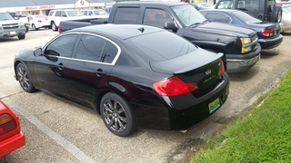

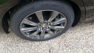

Camfantasy's Avatar
Camfantasy
Joined: Aug 2015
Posts: 16
Did you get it and hopefully it was a manual!
going this Friday to give it a test drive...trying to work out a price right now. Owner is wanting a little much at $25,700. It is a really nice G though.
Anyone know what rims these are that it has though? I'm not seeing them on other Sport sedans.
If I decided on 4.083 gears I would definitely do a poly bushing. But, I'm not.
It was a last minute decision for me to get the Elite Warranty, and only because my dealer came really close to the online quote I had got, and was willing to waive the vehicle inspection.
If I didn't have the extended warranty, I'd probably try and DIY the poly bushing. Or I'd pay the $700 at Motion Lab. And maybe I'd see if I could work 4.083 gears into the equation.

nelledge's Avatar
nelledge
n00b
Joined: Jun 2015
Posts: 195
Likes: 42
From: GA
Sure looks like it. I didn't know that was a known problem, or common enough to be dreaded. Damn. Doesn't Energy Suspension make a solid poly replacement? ...
Yes. Pretty common for the bushings to leak. Thus, the bushing is essentially junk.
No,no,no on the Energy Suspension. Consensus seems to be Whiteline across the G and Z platforms.

  #7410
Baby Jumpman's Avatar
Baby Jumpman
iTrader: (18)
Joined: Jun 2014
Posts: 510
Likes: 66
From: Long Island
Camfantasy those wheels came with my limited edition xs sedan. Although it appears the owner might've powder coated them graphite as the original color is hyper silver.
