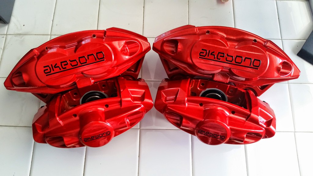

Here are mine done in metallic base with cherry red mid and gloss clear top. Costed me $400 or so with sandblast, powder and rebuild locally done.
Very nice! I need to find a local resource like youve found there in Miami.
Wow this color is so vivid and vibrant! I guess I need some DSLR pics of my Orange BBK because the pictures on my Sony Xperia Z2 don't reflect the actual color even though the camera is really great!
But I guess that's because yours were painted and mine were powdercoated so it's harder to achieve a desired color

Believe it or not this was taken with a galaxy s5 and google photos enhanced to try and show it how I see them. They were powdered coated by www.powder-coated.com
On car they look like the typical brembo red you see on srt8's.
John, the price was not for removal or reinstall. I had to do that part myself which is pretty easy...unless you drain all the brake fluid and get air in the system like me
