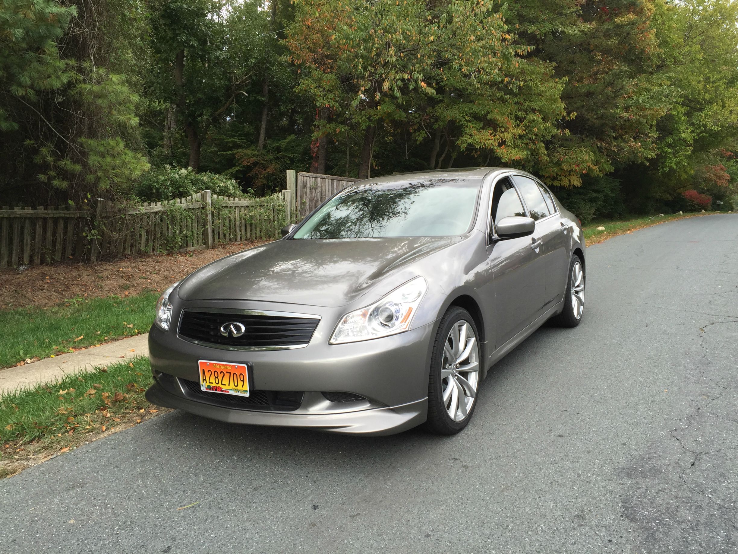

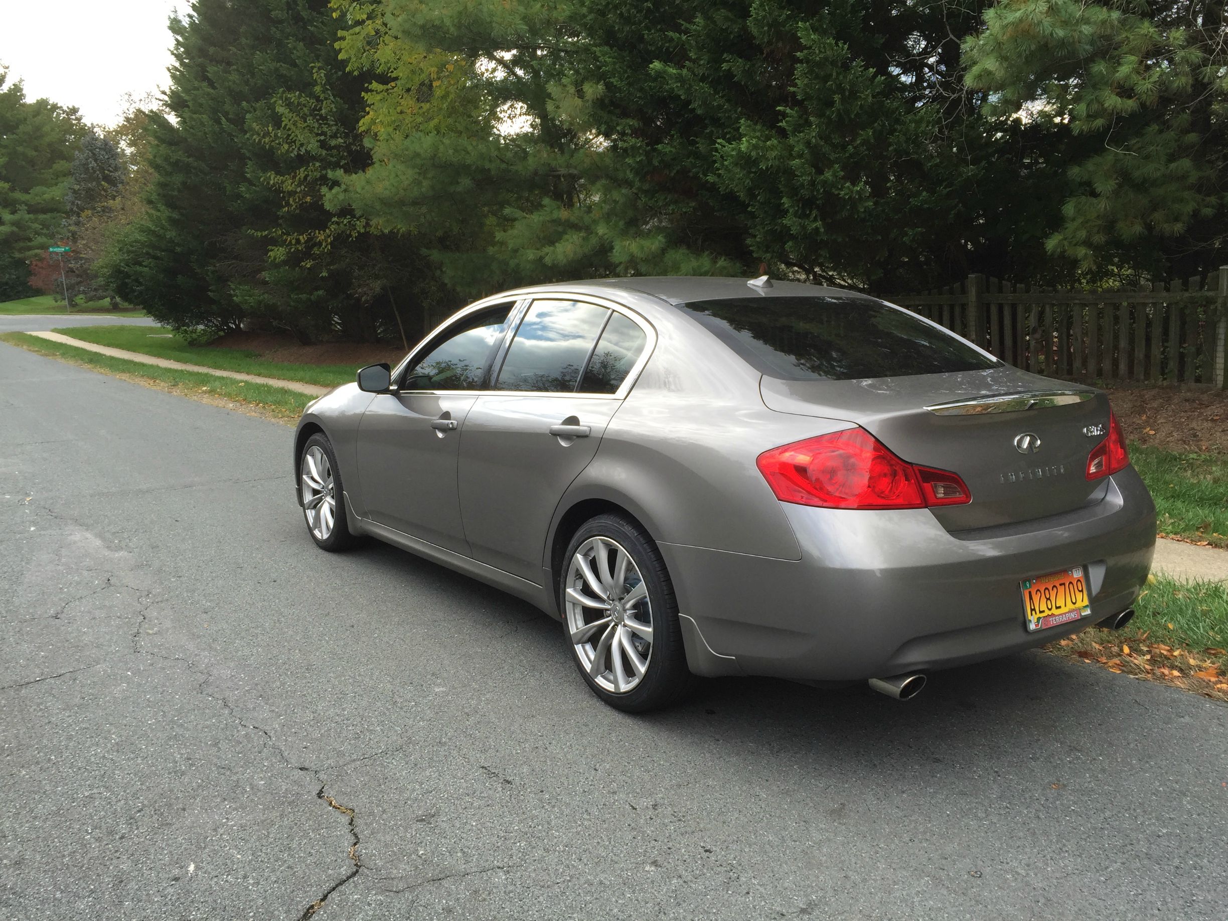

Finally got the wheels on today. It's a G37xS sedan. Staggered coupe wheels (19x8.5 F & 19x9 R) with 245/40/19 all around (didn't want to mess with VDC/AWD). This is at 100% stock setting, but coilovers & spacers will be going on tomorrow so I will update with the new look.
Unfortunately it's not a square set, but hopefully this helps out the poster above me and anyone else wondering what it looks like on a stock AWD sport sedan. To be honest, it's flush enough if you were to stay at stock height, but if you dropped the car you'd probably want spacers since the wheels will naturally sink inwards due to the camber from lowering.

it's flush enough if you were to stay at stock height, but if you dropped the car you'd probably want spacers...
Or aftermarket camber arms, if you'd like to be in spec again.

Nice job! Running 245s all around won't look wrong at all since the stagger is so minimal, and good choice for AWD.
What coilovers are you running? Look forward to pics & reviews when you get it all together.

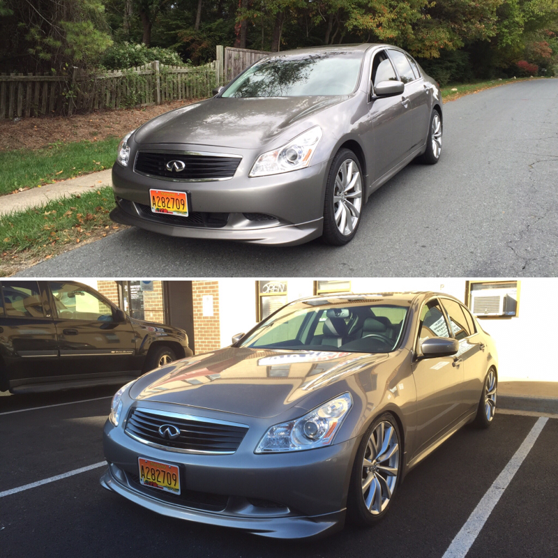

Here's a pic for now, going to raise the front a little and then get it aligned. But so far it's looking great!

Very nice, it always takes a little tweak or two to get things dialed in just right but you're already close.

You're right it does look great.
Two questions:
What size and type of spacers did you go with?

Spacers are from B2Designs. I used them on my G35 coupe and they gave me no issues at all. Hubcentric and everything, bolt right up for Nissan/Infiniti fitment. I went with 20mm front and 15mm rear; keep in mind my set is staggered so that explains the difference. When I roll my front fenders (eventually), I could probably go an extra 5mm all around and play with more camber, but at that point I'd probably just get a set of aftermarket wheels now that I have an idea of what specs go with my setup.

Also, wanted to see a side view with the 19s to see how it looked but missed out on that oh well
the oem 19s do not sit flush with the rest of the car like the stock 18s
