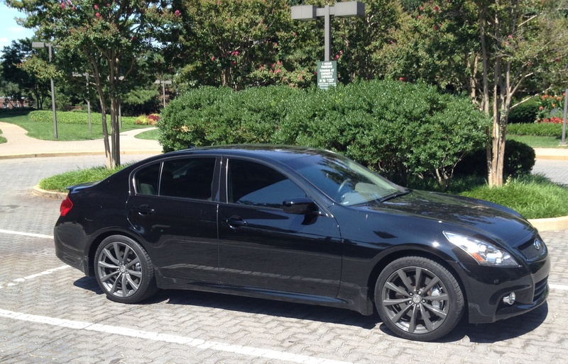

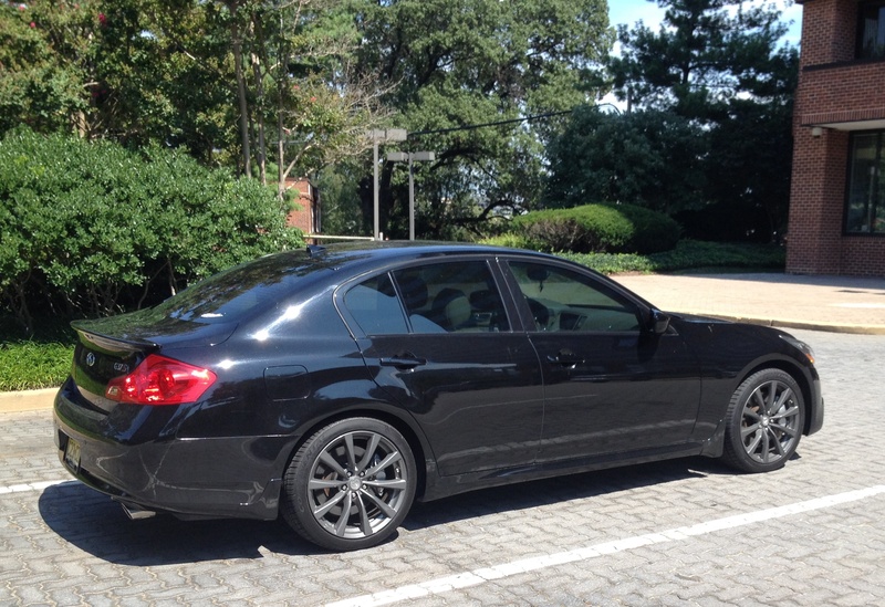

Few new pics to add to the archive.
For reference, tires are 245/40/19 all around, no spacers, OEM sport suspension, staggered sport coupe wheels powdercoated "ultra black chrome" (gloss gunmetal)
Alright, I've been looking up and down this thread and have yet to find a solid answer. Two questions:
1. Running a square tire setup on the staggered set of wheels is okay, right? I'll be using 245/40/19 all around. I am AWD.
2. What spacers are ideal to achieve a flush look? I'll be lowered on coilovers and don't mind running a bit of negative camber. 20mm front and 15mm rear sound about right? Again, this is for the staggered set.
Feedback is welcome, thanks!
