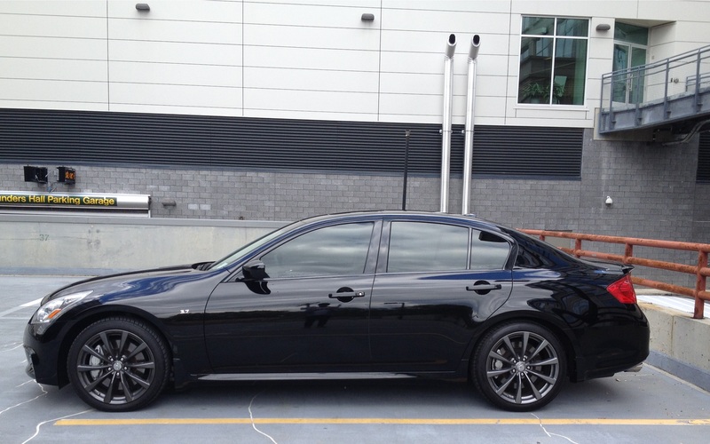

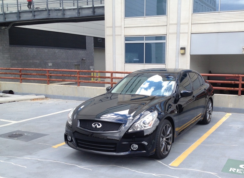

Anyone have spacers on just the front wheels? I'm thinking 5-10mm (tops), would be great to see pics
Totally fine with how the rear wheels look/fit, but the fronts are sunken in a bit, so visually it gives off the effect that the front wheels are a darker color than the rears (guess because the fender hangs over the fronts more):
Extra pic for giggles...

STownSaint, that is the 19" coupe with out spacers? That does not look sunken in at all, to me at least.
"blnewt" or others. If I put 19" coupe wheels on my XS, will that change the geometry of the vehicle and how Infiniti intended the XS to drive (other than 18" vs 19")?
I ask, as I am sure Infiniti, like all car manufactures, put in a lot of thought of the exact wheels to put on the XS. The exact inches, diameter and offset. If I change that, then will the suspension, etc work and move different than intended by Infiniti (other than the 18" vs 19" difference)?
