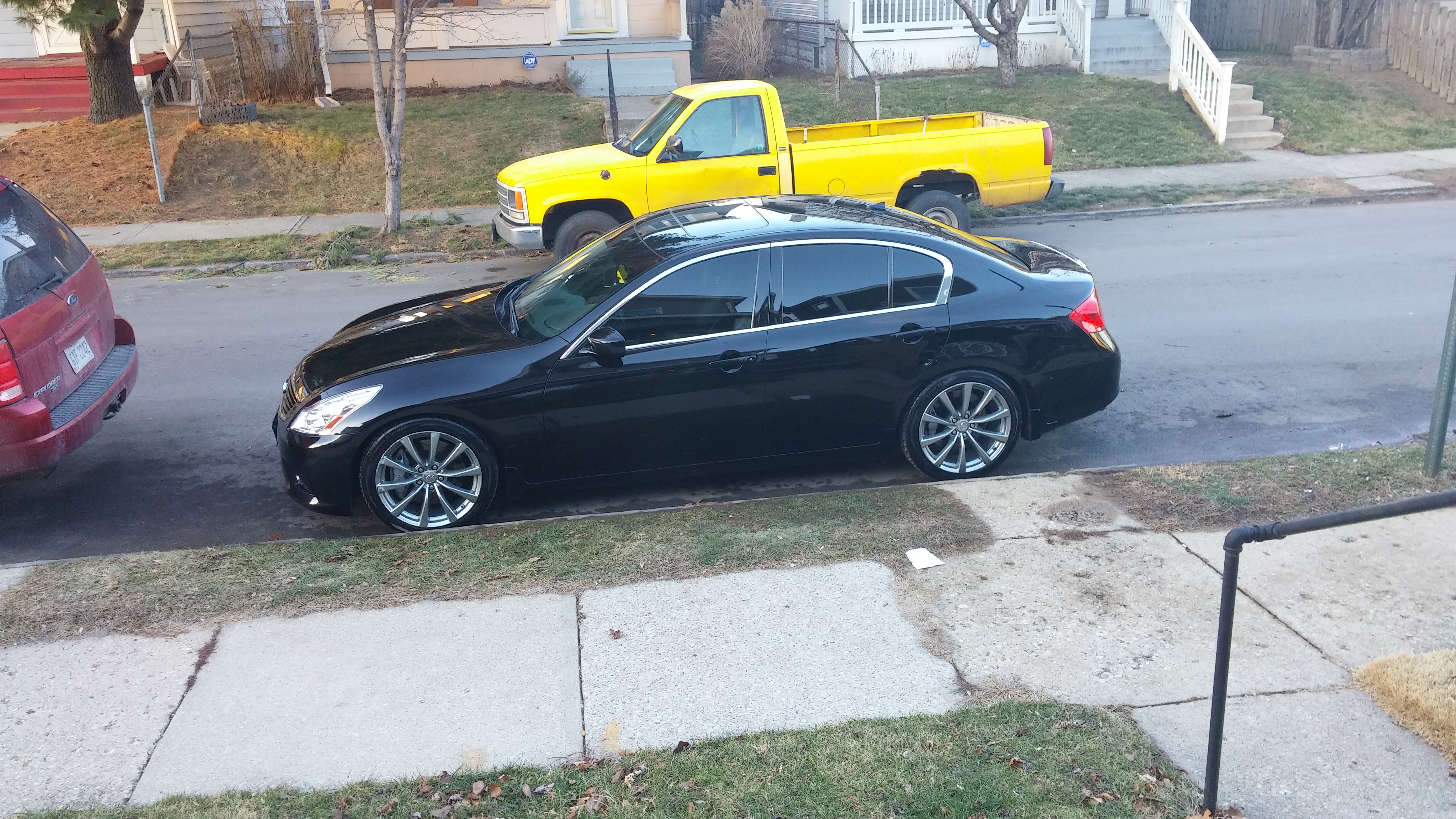

Btw someone asked me to post this a while ago but I got busy at work as usual. 19" square all around, swifts,20mm spacers all around and camber kit on the back. I will re finish the wheels next week and fix the cars paint the week after but unfortunately we decided we will not keep it when we move to Brooklyn.

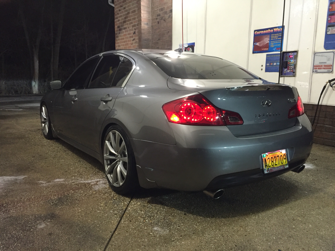

Im running 20 in the front and 15 in the back. Perfectly flush with no rubbing.
