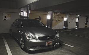

Finally made all of my adjustments and I'm beyond satisfied with the result. Only thing is I'm maxed out in terms of toe adjustment, so in order to reduce my rear camber I need additional toe adjustment (adjusting toe affects your camber and vice versa). I may get toe arms in the future but for now I don't think -3 is that bad. Here's a list of all my specs. Hope this helps!
  • Staggered 19" coupe wheels (19x8.5 F 19x9 R)
  • 245/40/19 tires all around
  • Ksport true type coilovers
  • SPC front & rear camber kits
  • 20mm front & 15mm rear spacers
  • Front camber: -1 degrees
  • Rear camber: -3 degrees
As far as the drop goes, I'm about 25.8" from the ground on my front fenders. I didn't measure the rear but I assume it's something similar.
I think once you tip over -2* it becomes something you can easily eyeball as noticeable negative camber. However once you approach -3*, it starts to look pretty darn silly. If you're under 26" floor to fender, then you're probably at zero gap.
To each his own, but... yikes!
There's no way you should have that much camber if you have the SPC rear kit, unless the SPC Toe bolt slots weren't elongated, or you only had the rear camber arms w/ OEM toe bolts. I've been that low in back and got my camber at -1.0 w/ toe well in spec, something is amiss.
Here's the SPC link (click on installation link for that info) in case you had a shop do this and the toe slot wasn't elongated.
http://www.spcalignment.com/componen...AFrom&to=USATo
Or...
  • It's intentional, for subjective looks.
  • It's necessary because of offset, for a zero-gap tire to compress *behind* the fender.
  • It's unavoidable, because the toe slots weren't modified, like you said.
The SPC toe bolts were not installed because my alignment tech advised against drilling/elongating the toe hole, saying the subframe would be compromised. He's had lots of experience with alignment and suspension and even though I know everyone uses the SPC toe bolts, he recommended toe arms to be the better solution. Might as well, since my spring buckets are empty anyways.
The rear camber is definitely noticeable, but it doesn't really look like a whole lot of camber. Looks like it's only at -2, definitely not silly looking IMO. I want to correct it down to -1.5 or -2 down the road anyways.
Only the inner side of the slot needs to be elongated so it's not much really compared to elongating both sides (as per the template). But since you do have the true coilover configuration the toe arms would be a good plan and get rid of a little weight back there as well. As far as the subframe being compromised by such a minimal amount of cutting, I doubt SPC and other brands would continue w/ those products if there was evidence of that (especially in this litigious era) but
At any rate, G is looking good and I think you'll really be happy w/ the drive when you get that camber a bit more balanced front to rear.
I hear you, that's what I was thinking too since it's so widely used. But toe arms wouldn't be a bad option to consider. Just a few more things to tidy up like rolling my front fenders and getting the rear camber reduced, but I'm loving the setup now as is
