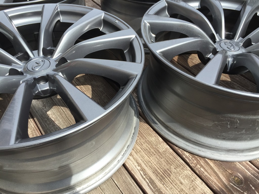

so i found another rear coupe wheel yesterday locally... i was soo happy until i picked up the wheels today...
what has been seen cannot be unseen!!! i love how the vert wheels look!
front on top rear vert bottom left
coupe on the left vert on the right
so now i dont know what to do... what spacer i need to get the vert wheel flush? thinking about looking for another rear vert wheel....
what you guys recommend?

Old Mar 21, 2015 | 08:02 PM
  #487
Likes: 4,952
The verts are more aggressive offset so you shouldn't need much of a spacer, if any at all.

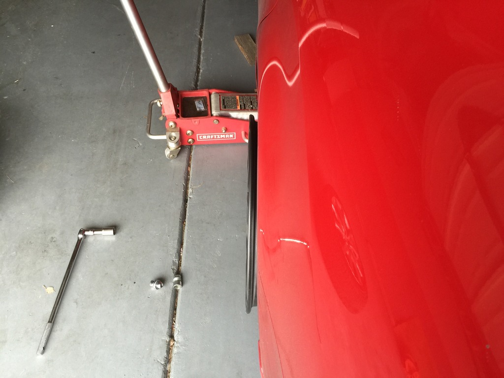

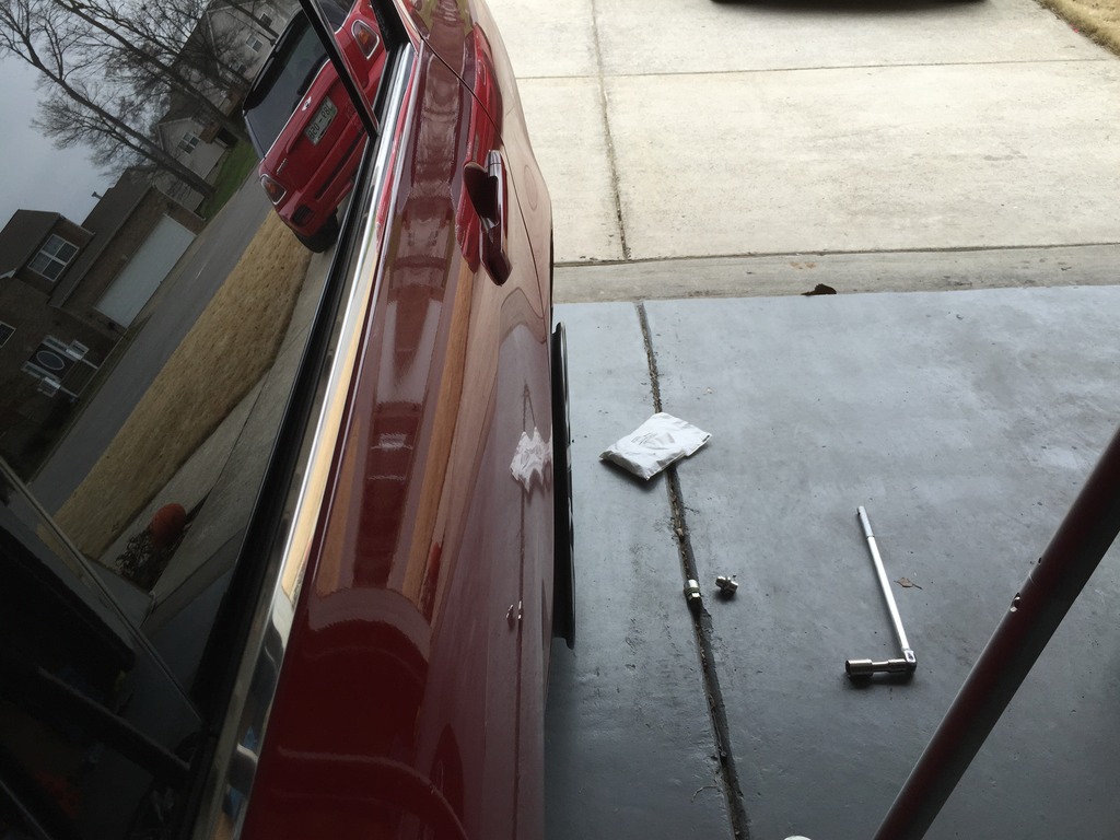

so here it is.. no spacer.. what you guys think? too aggressive? do you think i'll have to get the fenders rolled?

Old Mar 22, 2015 | 04:44 PM
  #490
Likes: 4,952
Should be fine, they'll camber in quite a bit when you load them up.

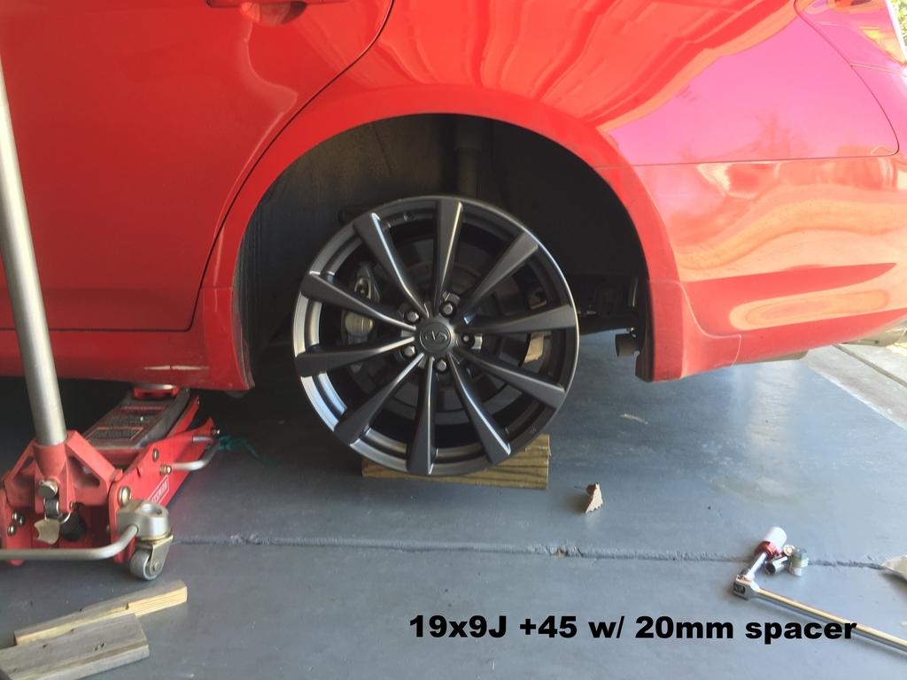

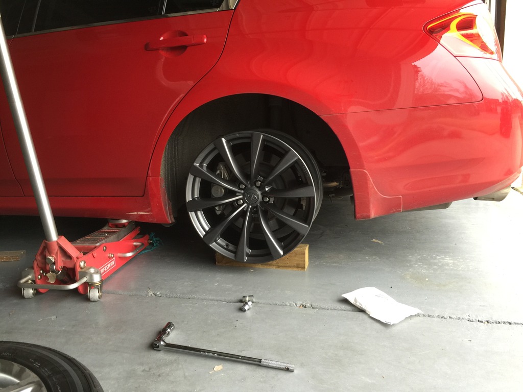

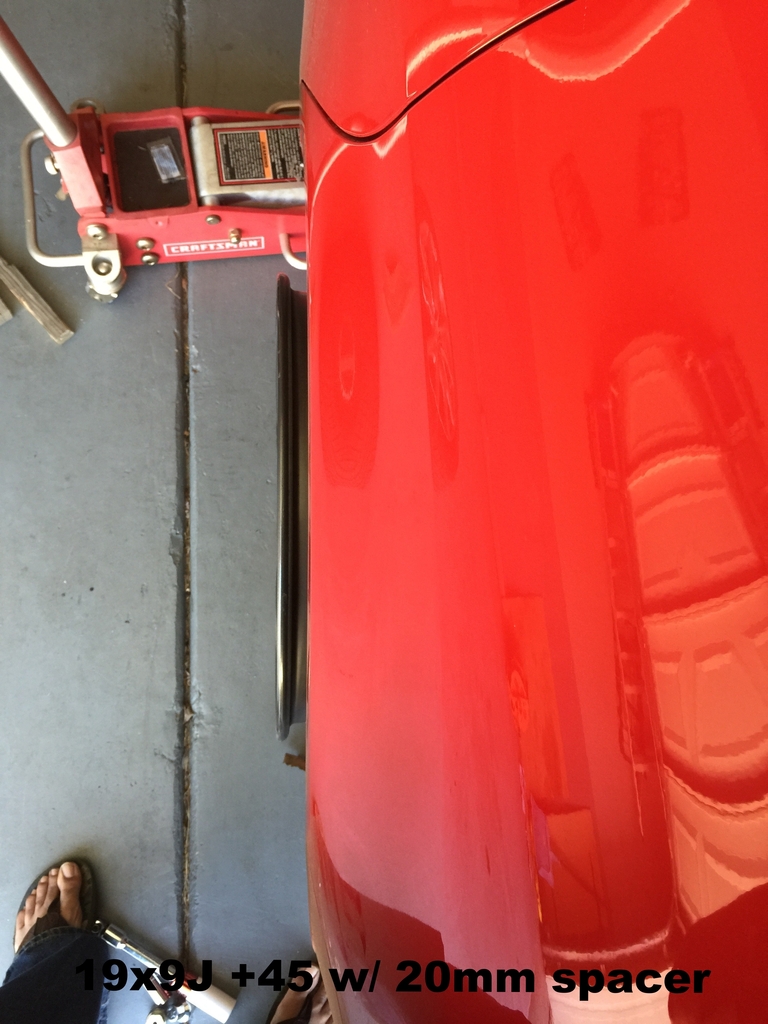

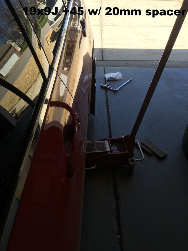

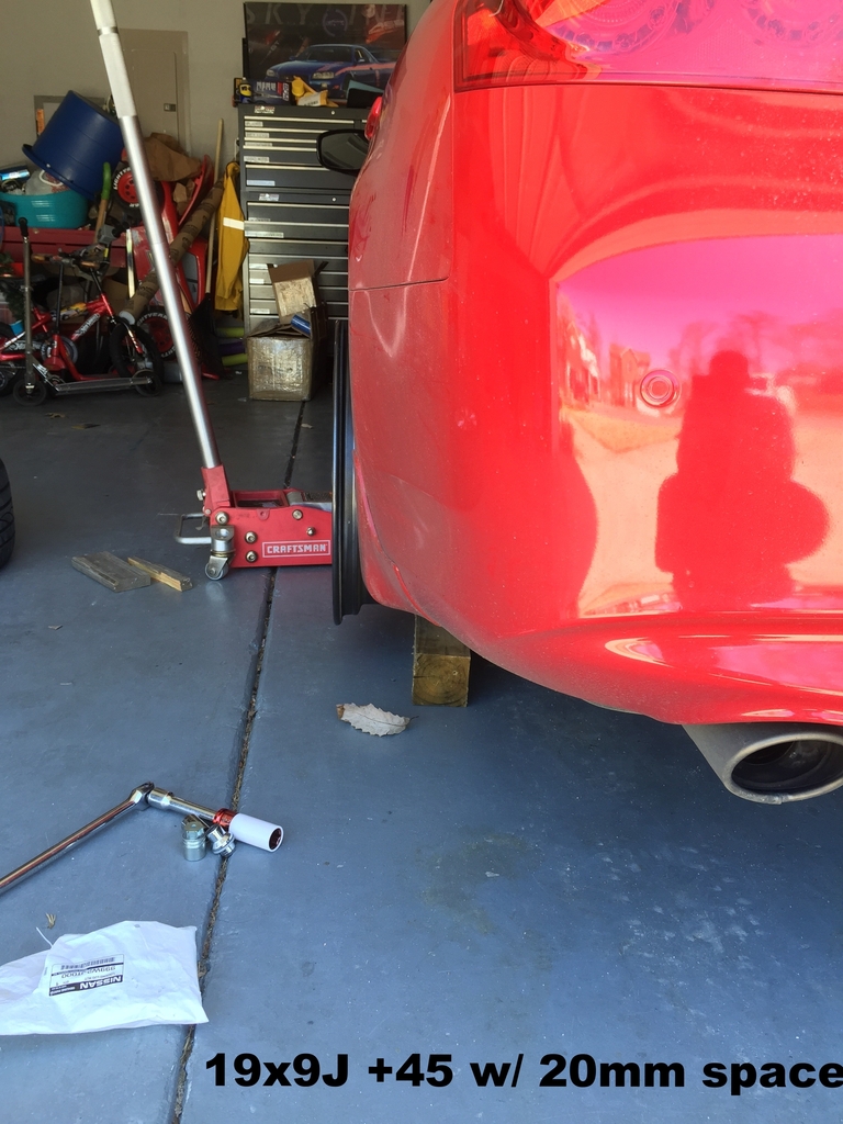

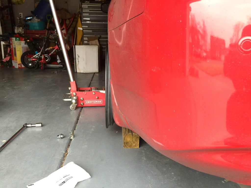

so here's the coupe wheel with the popular 20mm spacer..
it actually sticks out more than the vert...
at 1st i was worried about running the 275 but looks like it will work what do you all think?

Old Mar 23, 2015 | 03:19 PM
  #495
Likes: 4,952
I'd stick w/ the vert rears without any spacers, should be OK for your 275s, the standard coupe 19s w/ a 20mm spacer (and that extra 5mm poke) might be too tight for the 275s, at least w/ in-spec camber.
