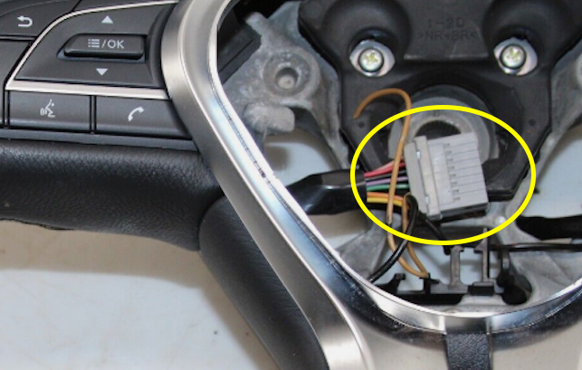

This post shows how the final Q60 Red Sport steering wheel is setup. Everything works as it should except for one (1) button. A standard Q wheel will be "plug-and-play," however, any of the Red Sport, heated, or "tech package" wheels WILL NOT as these have different connectors and require different circuits.
I did not nor will I post a DIY on this swap. It is a very technical, detail-oriented project that requires a lot of attention to detail. Due to the complexity and the systems that are involved there are just too many potential liability issues. I can answer any questions on what I did but that is as far as I go.

I appreciate the reply i understand that this thread is really old,
I just want to prepare myself for whats to come since i do plan on just going with the base wheel
not get too technical with the heated and tech pkg wheel, though it would be nice.
also does the standard cruise control work properly?
my last concern is that since my oem wheel does come with the power adjusted tilt telescope,
will that still function properly with the wheel swap or is that feature not affected in the swap?
thanks

No worries. Any standard (ie. "base") Q50/60 wheel that has the standard 8-pin gray connector will be plug-and-play to your existing wheel. The only difference is that the SOURCE button is now the (2018) BACK button. Doesn't affect me as I never use the NAV anyway. Again, look for this connector:
Red Sports and "Tech" wheels will have two (2) entirely different white connectors which will NOT work without modifications.
No issues at all wth the "standard" cruise control. It has NOT been determined if this will work on cars that have the fancy ICC (Intelligent Cruise Control) and I have no way of testing. I have the regular cruise and it works just fine.
ADP (ie. tilt, telescope, etc.) is not affected in any way.
You can find these wheels on eBay and probably some local pull-a-part yards for reasonable prices- eBay has several <$150. Keep in mind you will also need to get a Q50/60 AIRBAG which will be expensive- deals can be found if you're patient and good with searching. The airbag module is also also plug-and-play.
