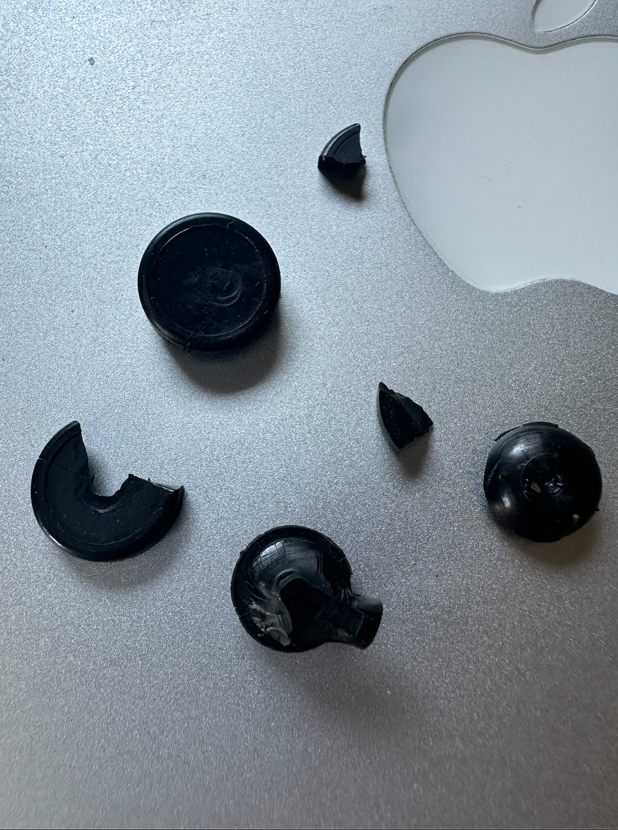

This past Saturday night while driving home I noticed the cruise control would not SET. It would turn ON but I could not SET the speed. Ugh, here we go, I thought. It was 2am so I didn't care to delve into it until the next day. I knew it was not the Q60 steering switch(es) as they are next to new and all other functions work, as intended.
Anyway, next morning I found these pieces on the floor mat:
Long story short, the little "pad" that actuates the cruise switch "plunger" broke into pieces. We have plenty of threads on these pads affecting the brake pedal switch causing limp mode, brake lights constantly on, etc. So, I went ahead and ordered three (3) replacements: one for cruise, one for brake (it was very loose and would have eventually broke anyway), plus one spare. All three (3) + expedited FedEx shipping for $18.
Parts arrived this morning and went to install only to be greeted by this SOB sitting right under the driver door:
Welcome to the country, "y'all." Sorry, I can deal with NYC wharf rats better than these go**amn things...
Parts installed in less than 5min., cruise is up and running as is everything else. Now to other maintenance items on both the G and the Zed/4...
As my car is now 17-years-old it was only a matter of time before those pads failed. For anyone with these older cars, stay on top of these items. These pads, the infamous heater hose connector, windshield cowl seal, sunroof drains, etc. are all easy fixes IF tackled PRIOR to their failure but can be a costly and painful lesson if you habitually "kick the can."
