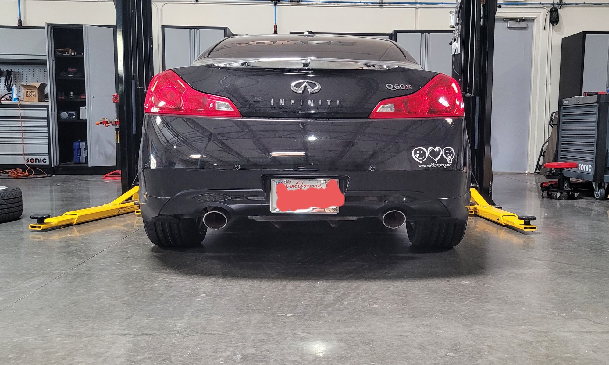

Originally Posted by heedtheninja67
Installed the SS OEM Sport Muffler. Sorry for the bad pic. Sounds great and not too loud. I may try to get some clips for my specific setup.
looks awesome! Where did you get it and was it hard to put on? I would love to hear how it sounds!

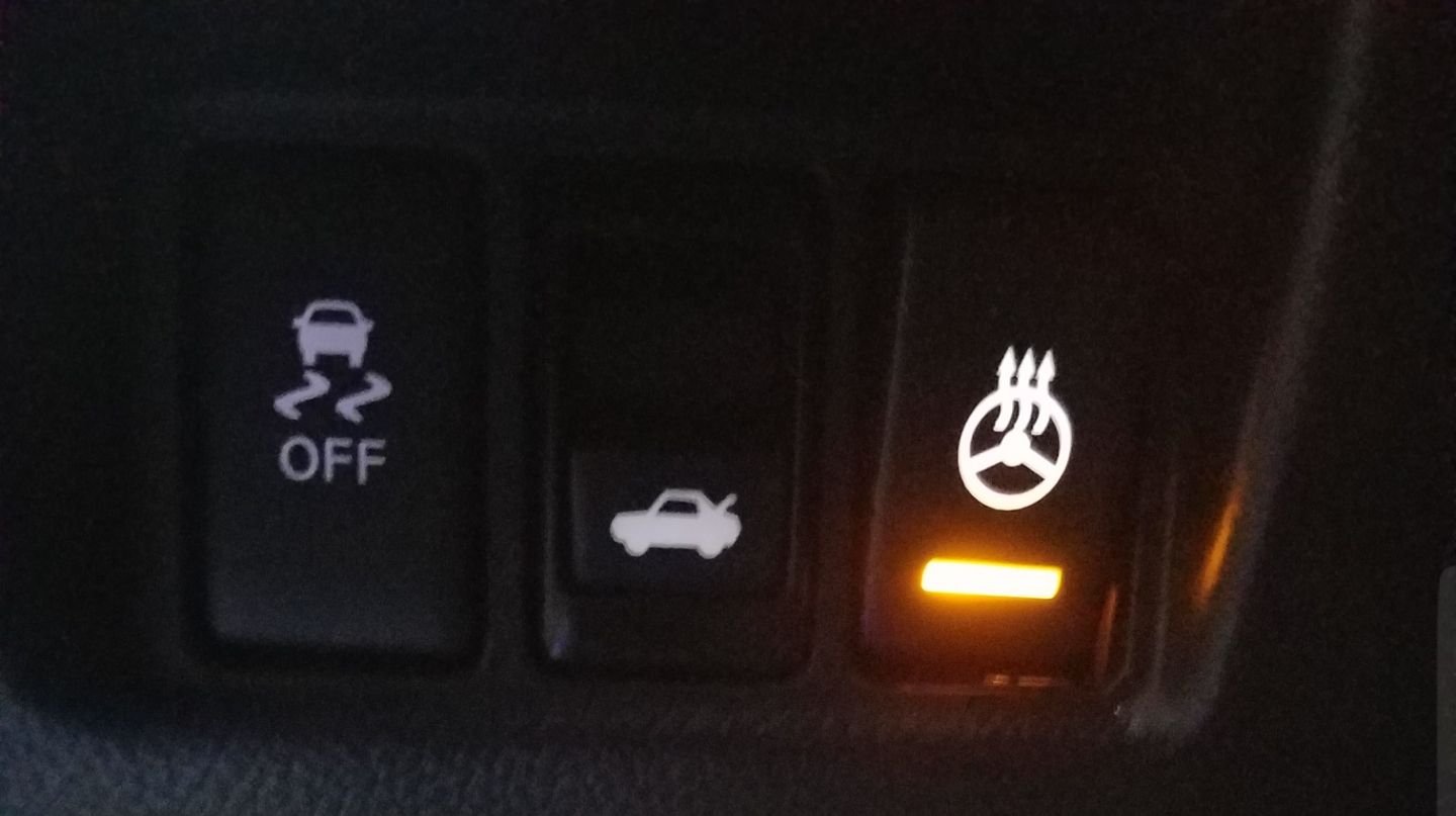

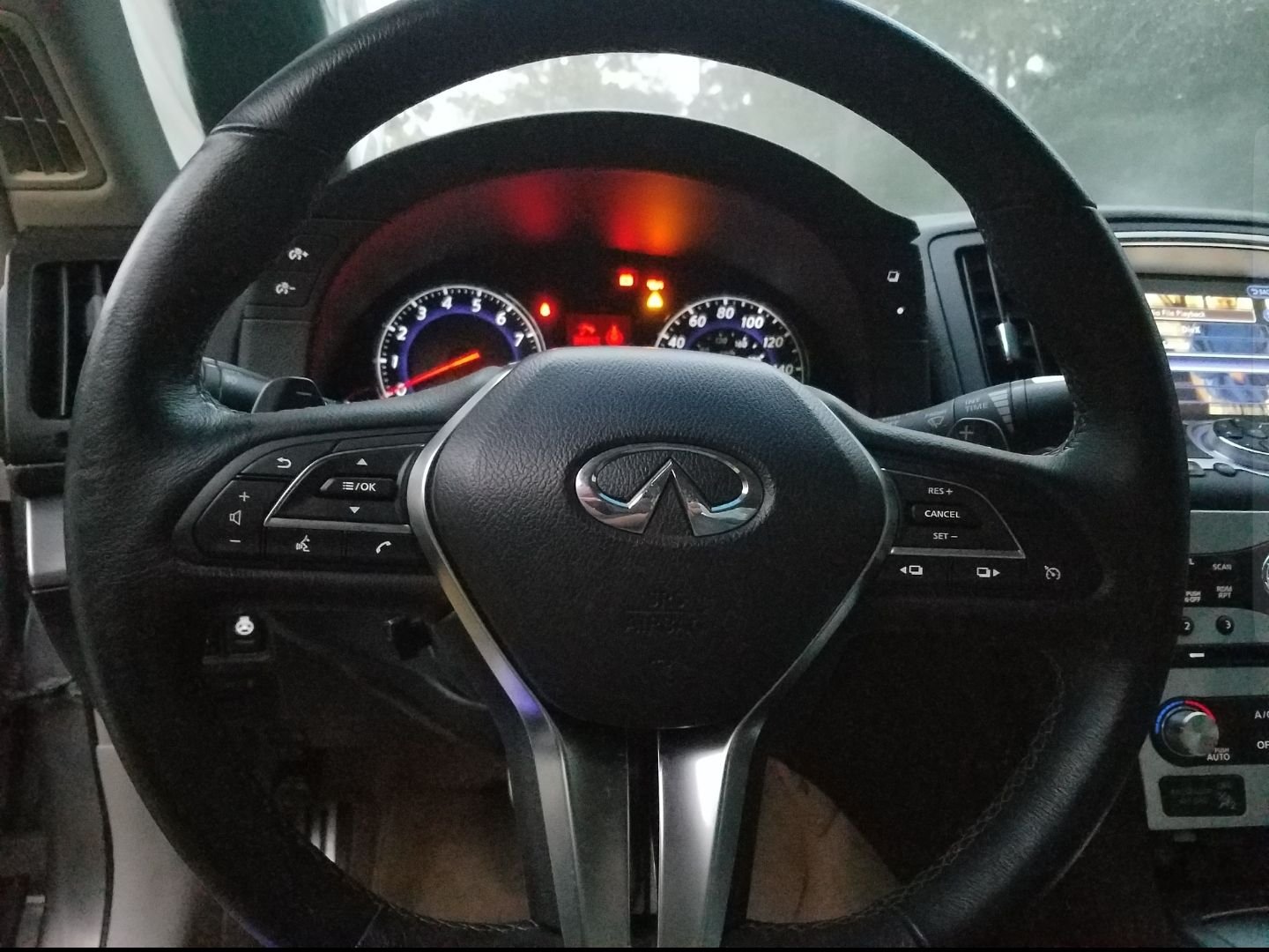

To answer questions (as I had forgotten to update)...
As some may recall, I swapped to a 2018 Q60 steering wheel in June 2019. At the time, I was unable to hookup the heated part nor the built-in paddle shifters.
Fast forward to this past summer, I was finally able to remove the column paddles (which I never used/liked), wire up the steering heater circuits and the built-in paddles. The result is a fully functional Q60 steering wheel.
For the record, the wheel and steering switches are 99% plug and play. The rest of the install is NOT. I needed a different clock spring (spiral cable), had to extend 3 wires at the clockspring (for the paddles), and run a full, switched, relay circuit for the heater.
I like it, especially the heated steering wheel part. I drive my AWD coupe in freezing weather all the time, heated steering wheel is very compelling.
Can the Q60 shift paddles be removed from the wheel? I have the column mounted paddles and much prefer them. My GTI had steering wheel paddles and I found them toobuku when trying to shift gears on windy roads. I'd like to keep my column paddles.
Did the Q60 clock spring fit perfectly? Would I need to get the harness leading into the clock spring from a donor Q60? Did the heated steering wheel switch from a Q60 fit perfectly in your dash? I'll have to go check, but I think I don't have any dash blanks, I think where you put your steering wheel heater switch I have park sensor switch...I think

Most of the newer Q50/Q60 steering wheels do not come with paddles. It was a route I wanted to take because, why not? Keep in mind that it is not just the steering wheel. You would need the airbag as well, and finding them reasonably priced, used, is rare right now.
I could not use the Q60 clock spring because the donor car had the tech package and the wiring connectors/pinouts were entirely different. I ended up using a M37 clockspring as the pinouts were identical to the G37 and also had the heated steering circuits built-in (plus the extra 3-pin circuits I needed for the paddles).
There are a lot of little bits and pieces to this swap that I had to work out on order to get it to work fully. Too many to go into here in this thread. It is a bit of a Frankenstein mod, but it works damn well.

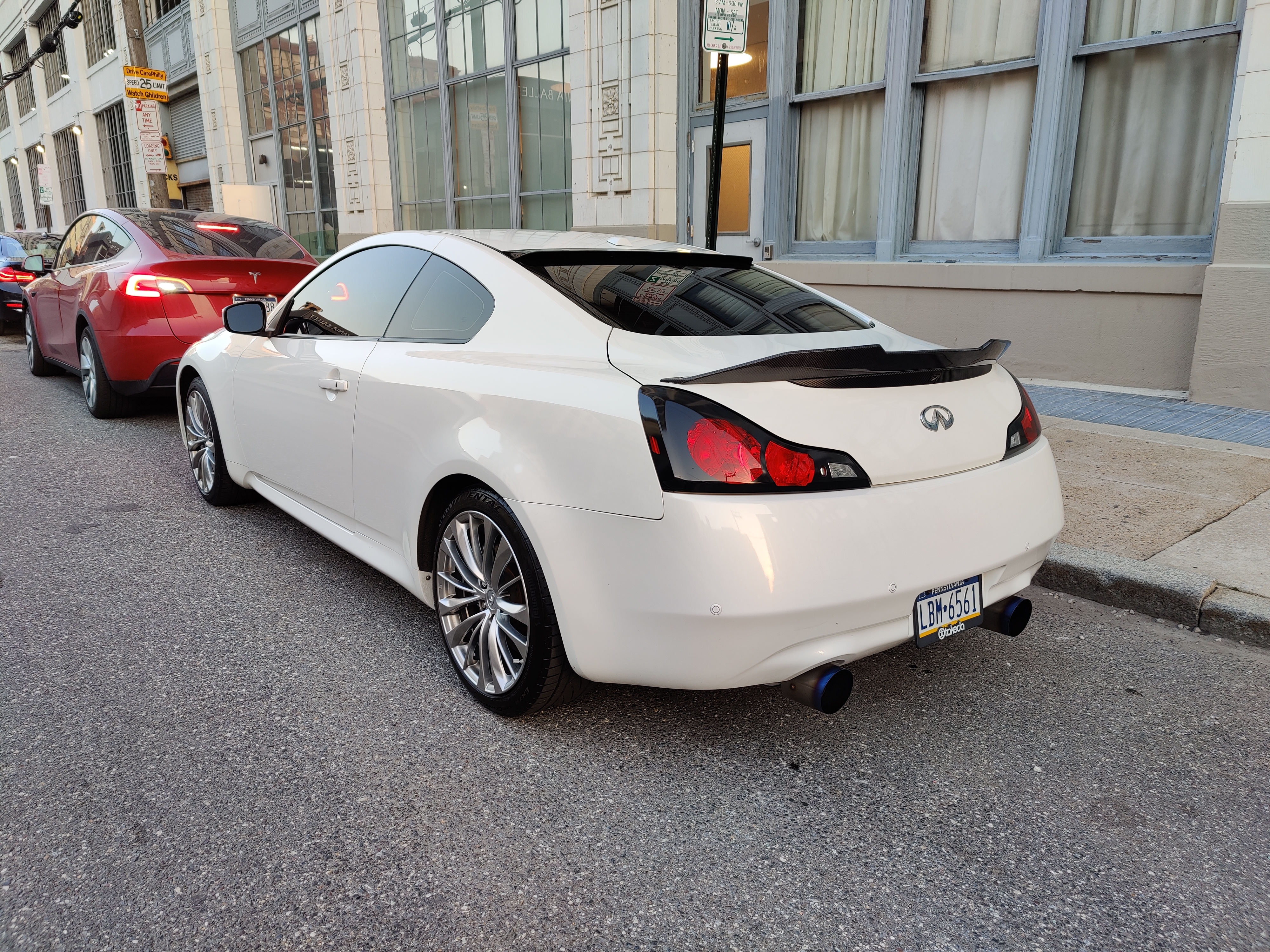

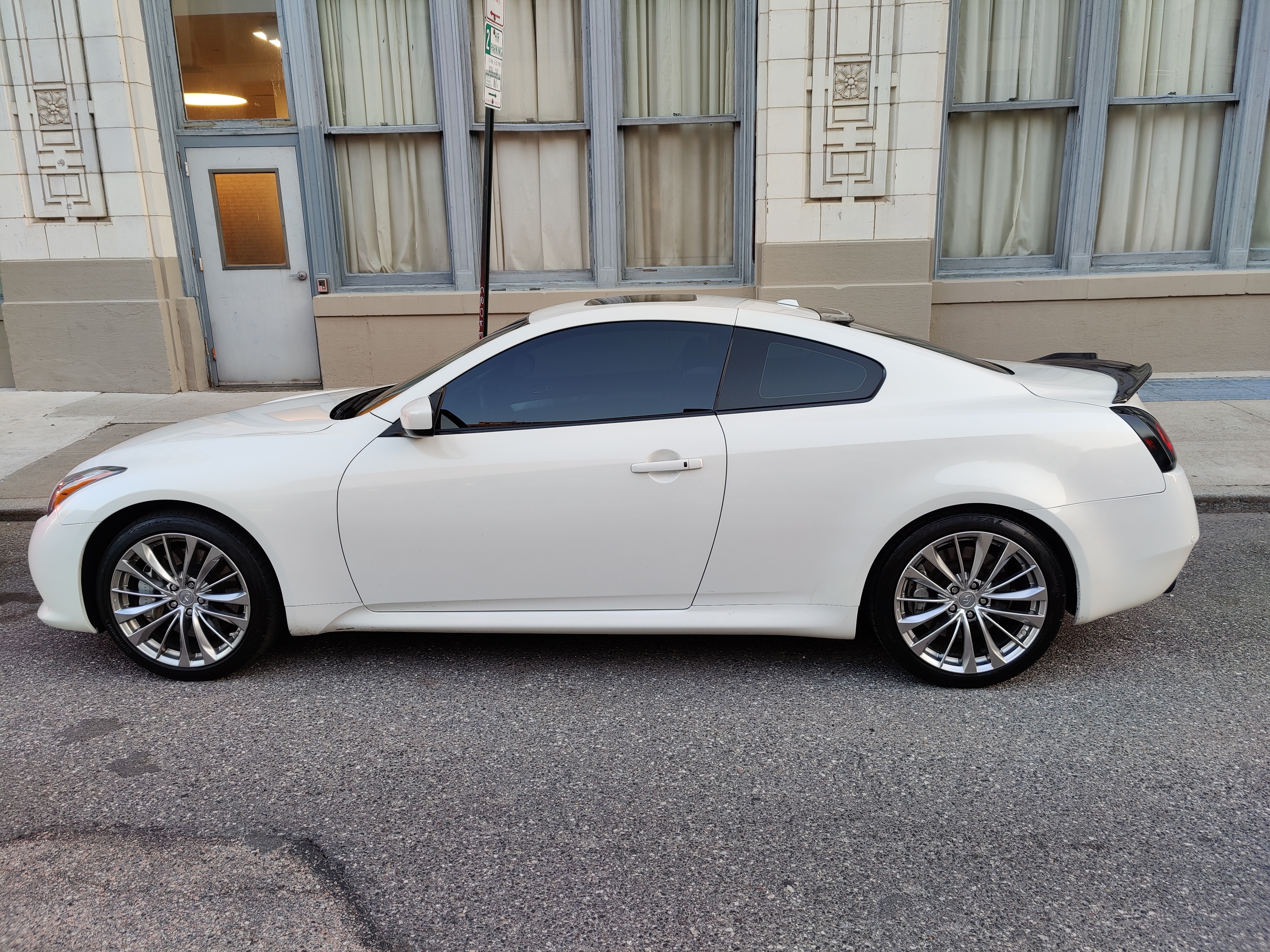

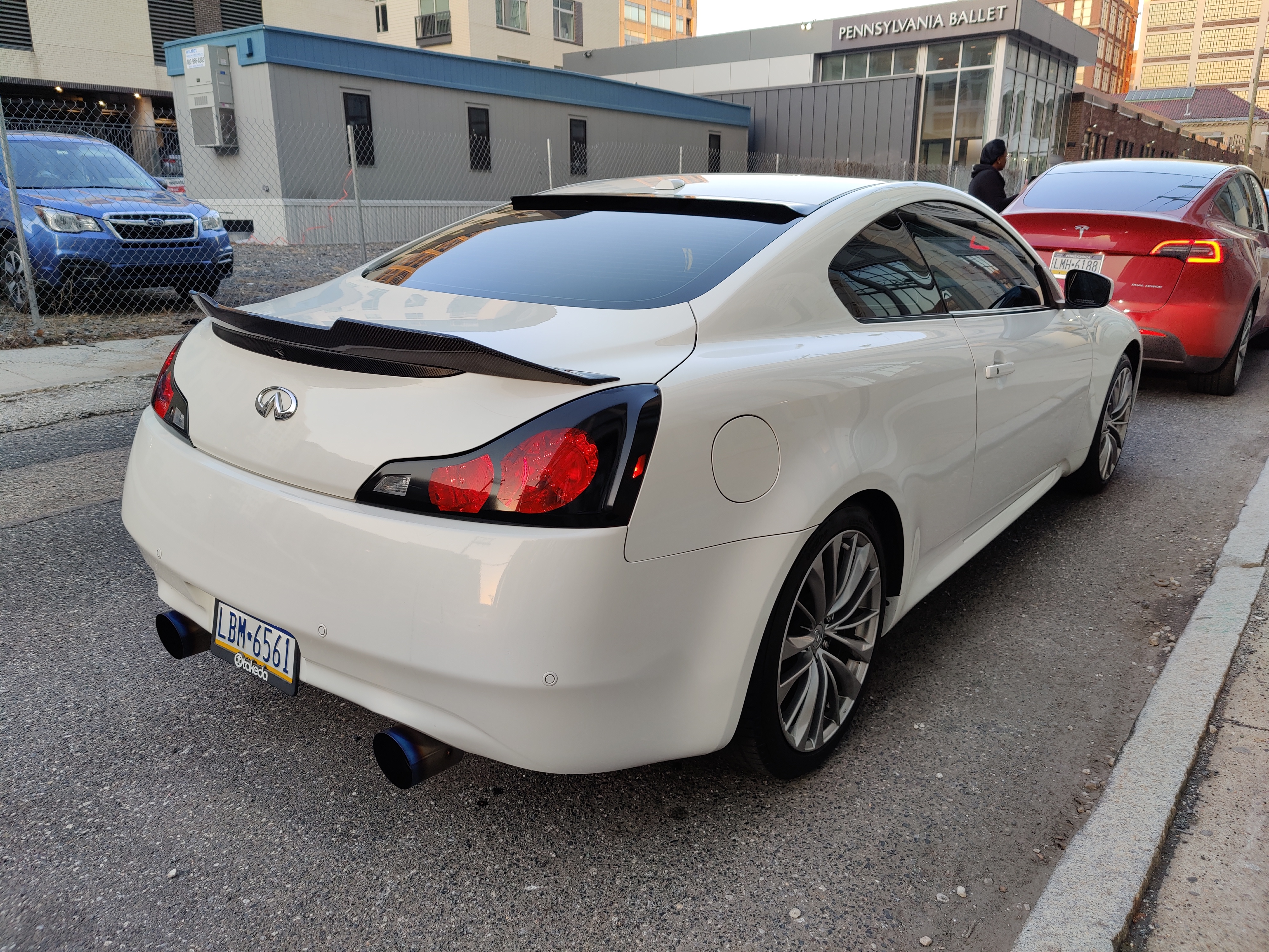

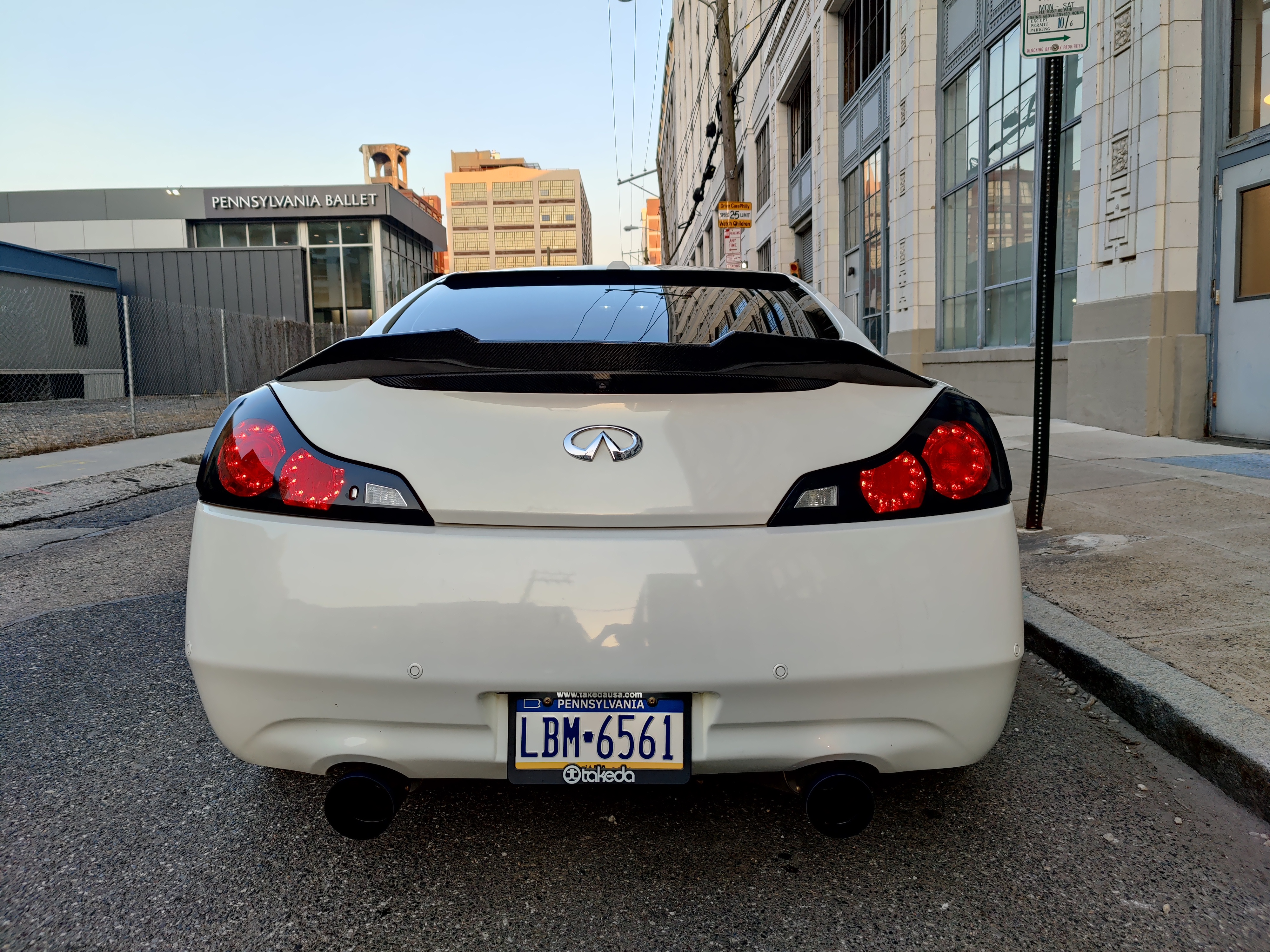

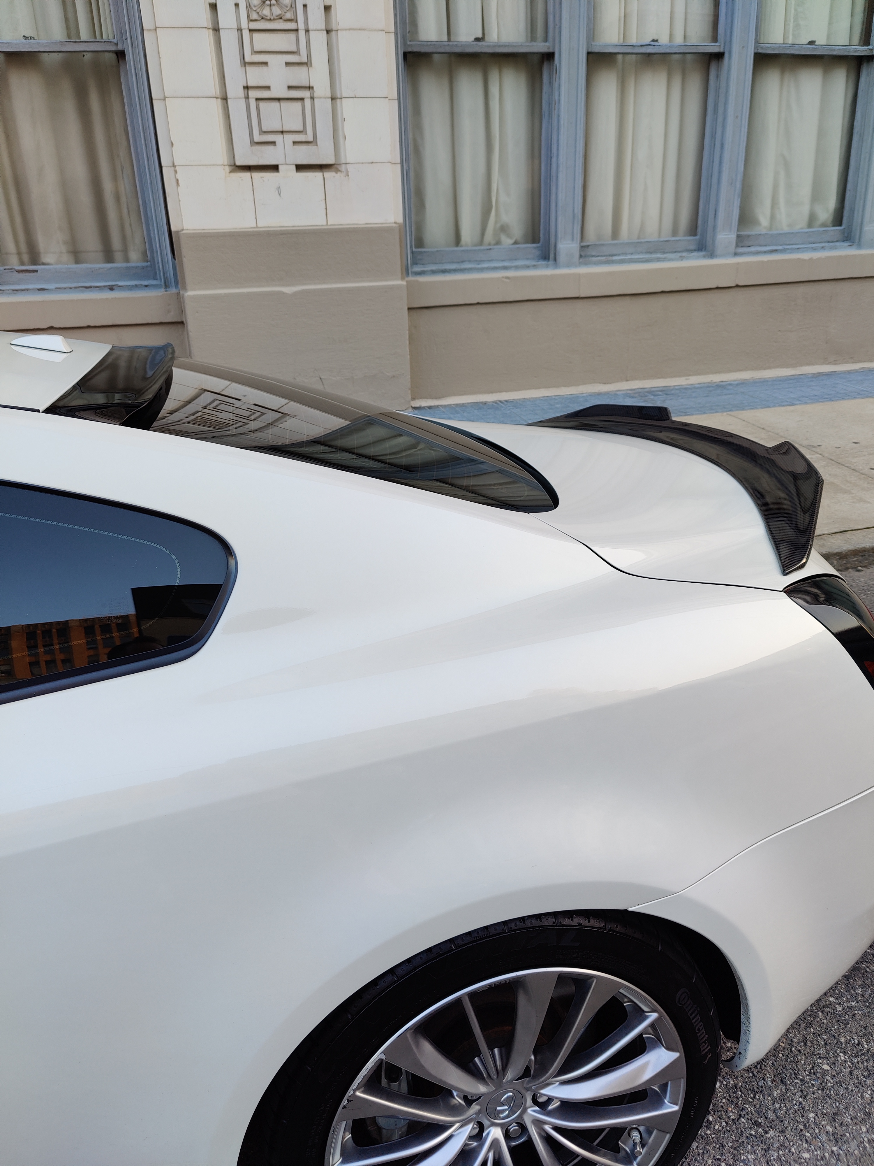

New roof wing and trunk spoiler!
Attached Thumbnails What did you do to your coupe today?-img_20210322_185151.jpg   What did you do to your coupe today?-img_20210322_185156.jpg   What did you do to your coupe today?-img_20210322_185229.jpg   What did you do to your coupe today?-img_20210322_185340.jpg   What did you do to your coupe today?-img_20210322_185327.jpg

@jrocka312 the split duckbill nascar-esqe wing looks nice! Where'd you find that at?
They are available throgh a few vendors right now... Jalisco's Carbon Fiber, Aerobon, and Amazon believe it or not! The roof wing is H.I.C. and is really nice!

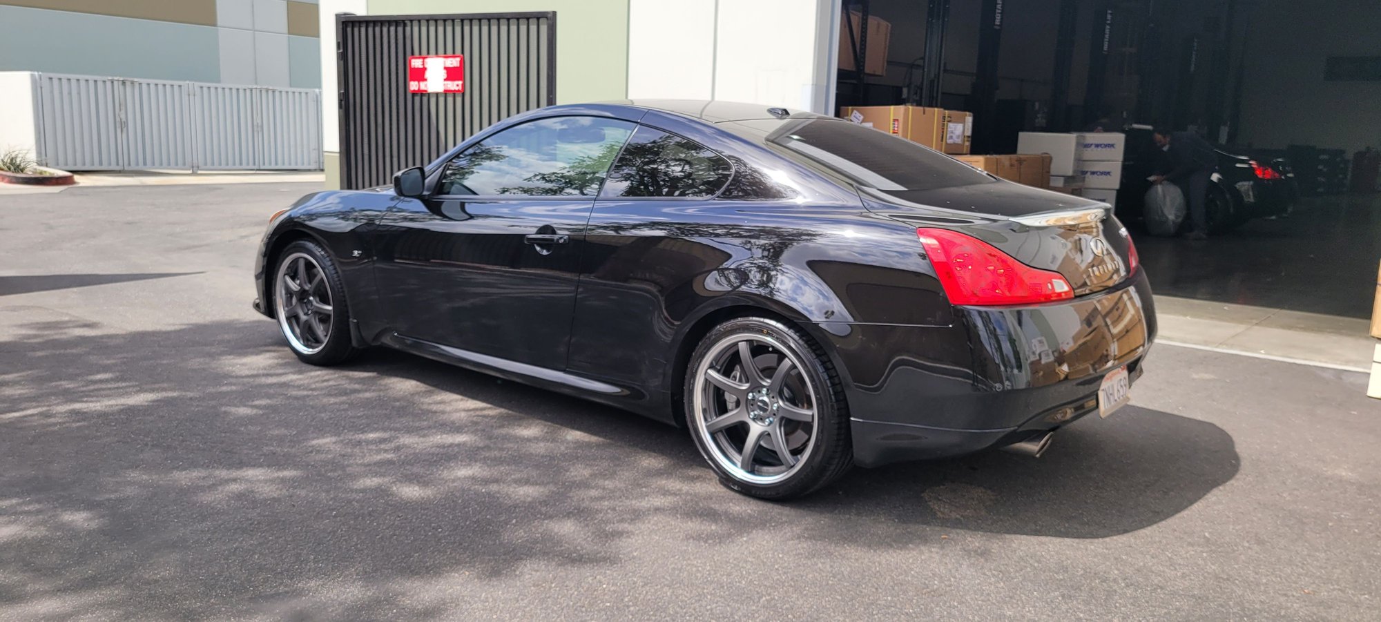

Got some Work wheels in Graphite. Just need some lug nuts and wheel locks. Stock suspension.
Those look clean! Lower that car a tad and its perfect
