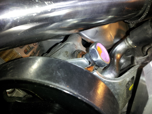

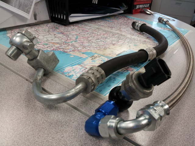

UPDATE........ I have not had a lot of time to work on my project and because of a few fitment issues that are unique to the AWD I have been running into a few road blocks. Nothing that can't be fixed and I enjoy the challenge. Here is an example when it came to the P/S line from the pump to the rack. The intake piping does not leave any room for the stock P/S line so I had to make a new one. The picture on the left is a close up of the P/S pump with the line removed and you can see the banjo bolt. Not too much room!! The next picture you can see the comparison on the OEM and the new. I drilled and tapped the new banjo bolt so I could screw in the pressure sensor to keep everything tight. I will post some pictures once installed.

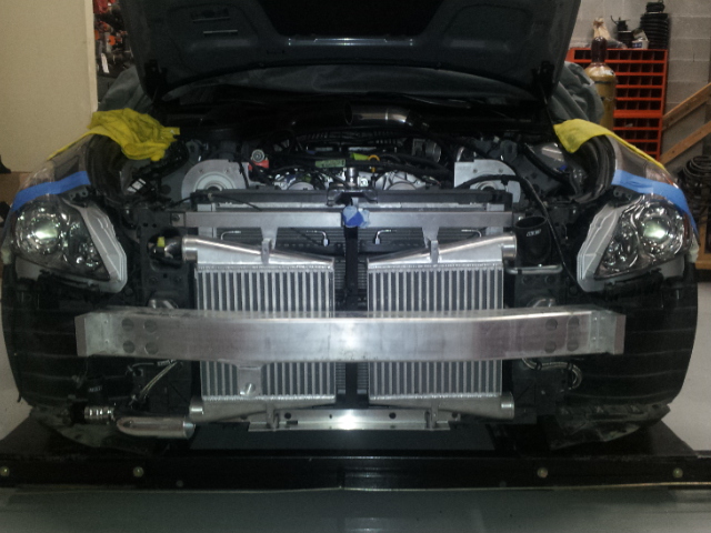

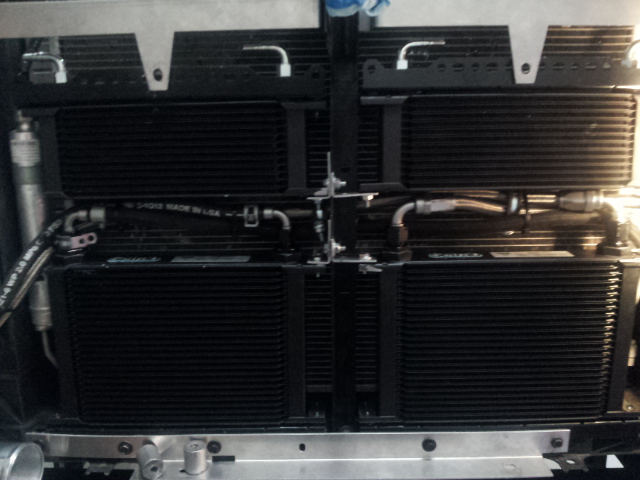

More progress........ all the coolers mounted and the bumper beam fits like a glove. Next all the piping and S/C oil lines. Stay tuned
