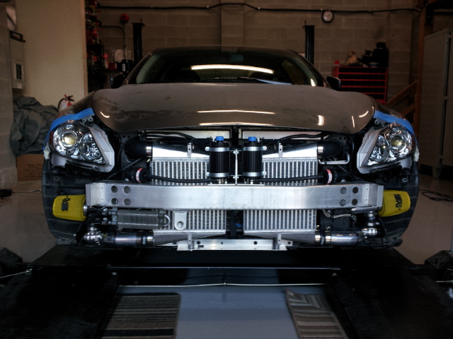

Took the car out for a shakedown run before putting the front clip back on. Engine runs beautiful, sounds awesome like it wants to go. Went to the local gas station to fill up on 94 octane. Lots of looks with the twin intercoolers hanging out. I also invested in some waterproof K&N filter covers just for insurance. Taking it easy for the first little while and want to be sure everything is good before ramping it up a bit.
Oh man, the symmetry in this engine build *really* appeals to my inner OCD monsters.

Including the VB upgrade and SC kit and all the little extras close to $14,000. It was a lot of fun installing the kit and was quite the learning curve but GTM helped out with any questions. About 400 miles on so far and the car drives fantastic. Still keeping it easy not going past 5000 RPM at about 6psi boost. No issues so far. Power comes on smooth and predictable. Took it to the local Infiniti dealer to get the A/C recharged and all the techs drooled over the install. Congrats to GTM for putting together an amazing product. Looks and runs great. Later on when the weather warms up going for some dyno time and our local 1/4 mile track to see how thing go.
