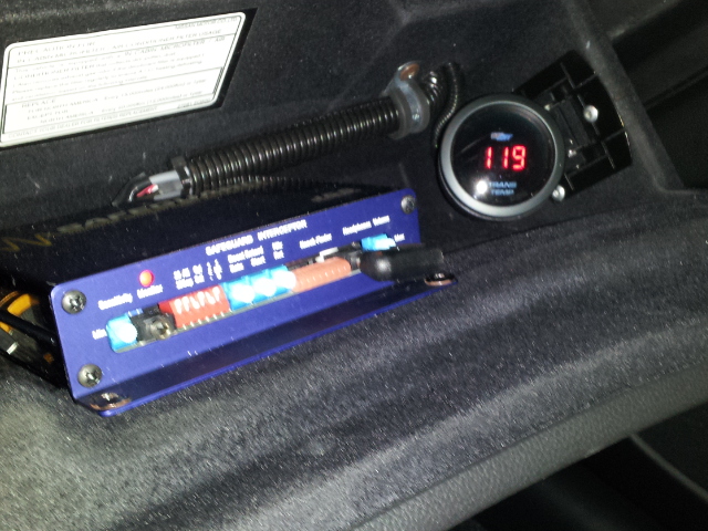

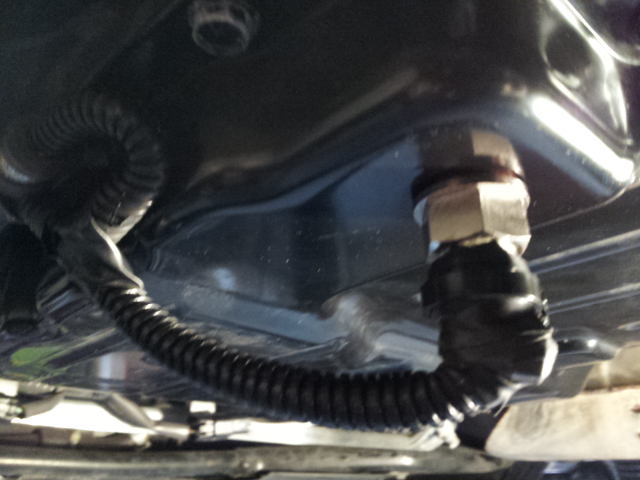

The next upgrade I wanted to install was a transmission temperature gauge. The 7AT already has a trans temp sender but can only be accessed by the Consult 3 diagnostic scanner. Cipher or any other OBD2 scanner that I know of can not read the trans temp. Solution? Install a simple temp sender. But where? So much information out there as to where to install the sensor. I figured that since the OEM sensor is in the valve body put the aftermarket sensor in the oil pan. Simple solution is to get a NPT to 12MM adapter and change out to drain plug. I swapped out the plug and only lost a teaspoon of trans oil. The sensor looks like it is hanging down but unless you are going off road there there won't be any problems. The exhaust pipes are lower. I didn't want a lot of gauges all over the palce that's why I picked the glove box.
