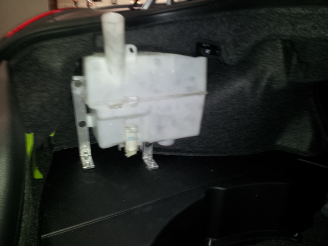

@Timp. How did you route the OEM windshield washer to the trunk?

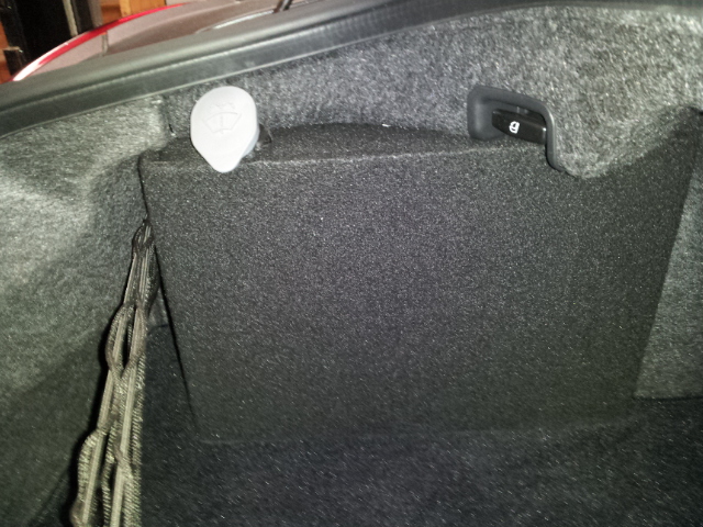

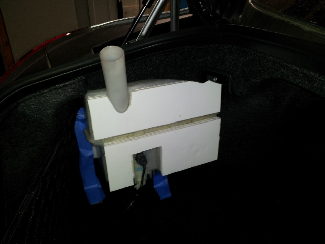

I re-routed the OEM washer hose and power/sensor wires from the location in the front along the passenger side of the car to the rear truck. There is a grommet into the trunk with wires going into the truck already I made a small hole and pushed the bundle through. After I sprayed a rubber under coating to seal every thing up. Inside the trunk I routed everything to the driver side where the OEM washer bottle is installed.
Attached Thumbnails Getting Ready GTM 2SC-windshield1.jpg   Getting Ready GTM 2SC-windshield2.jpg   Getting Ready GTM 2SC-windshield3.jpg

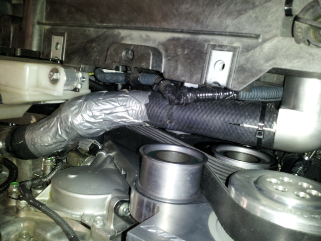

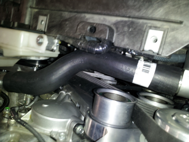

Upper rad hose had to be changed as well as the OEM rad hose would not fit. I mocked up a rad hose using the parts from the OEM lower and upper hoses, duct taped everything and went to a local auto store and matched up a perfect fit. Good Year # 60932 Getting so close to start up.
Attached Thumbnails Getting Ready GTM 2SC-20131213_094328.jpg   Getting Ready GTM 2SC-20131213_105911.jpg

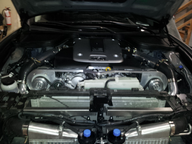

Engine cover fitted .......... front clip next.
