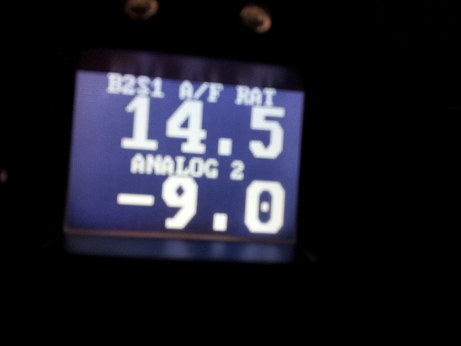

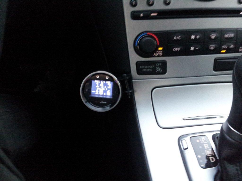

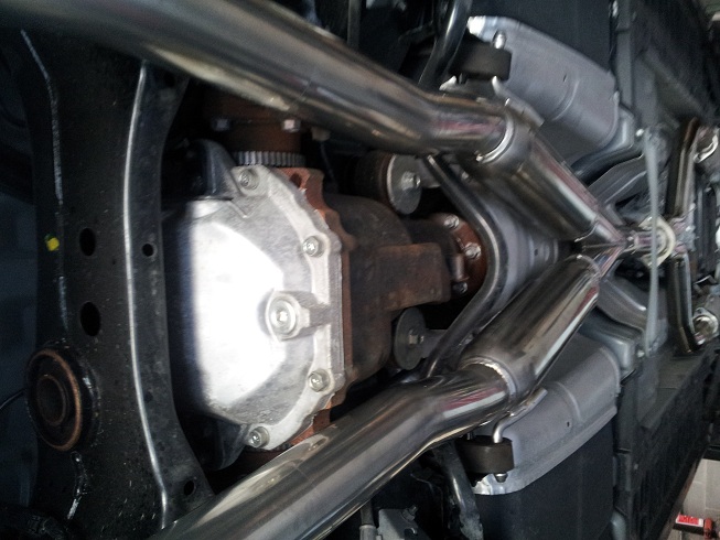

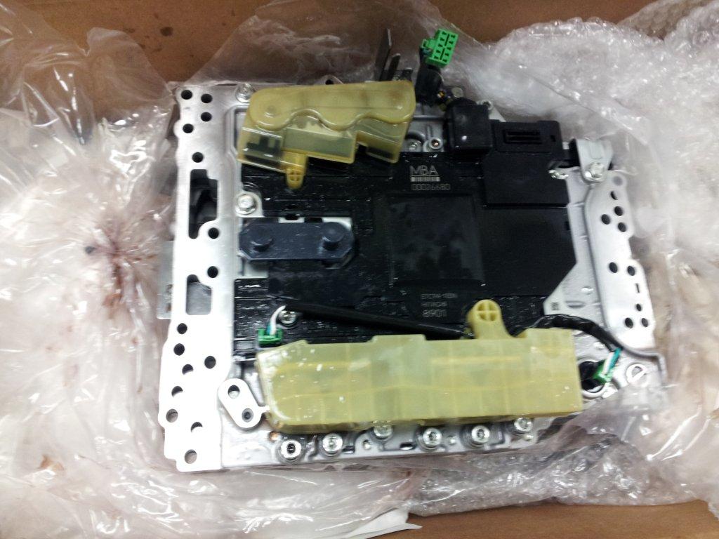

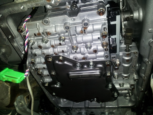

Ever since I purchased my 09 G37x I have been looking into FI. When GTM announced the twin SC for the G37x I starting getting the car ready. First thing was to open up the exhaust with the Megan Y pipe and Tanabe midpipe both installed NP. Next was to install a guage to monitor A/F, oil pressure, fuel pressure, oil temp, etc etc. The areoforce guage works perfectly, 1 guage does it all set it to scan and the dual display changes at preset intervals. GTM recomended the valve body upgrade. Turn around time less than a week and after an easy r&r what a difference in shifting .... quick and crisp. Next is the twin SC kit.... updates later.

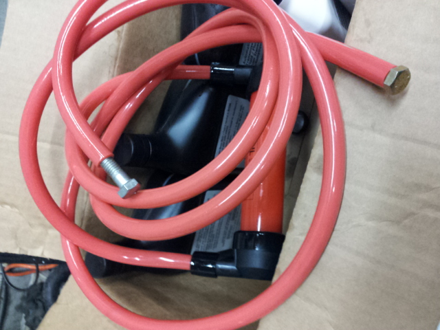

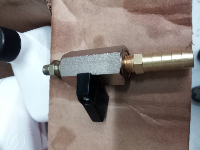

Just a quick update on the the GTM valve body upgrade. Love the way it shifts especially is DS/Manuel mode. Instantly shifts from gear to gear no lag at all. For those that like to DIY you will need these 2 items (pump $13 and a valve attachment $12) to pump the trans oil back into the transmission once the pan is back on. New gasket of course.

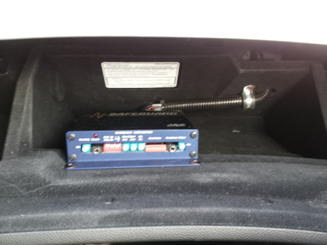

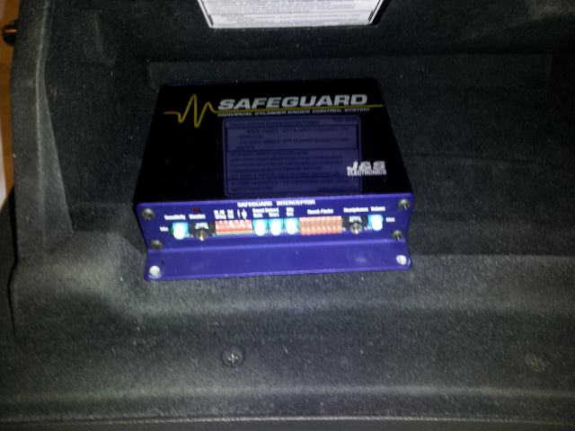

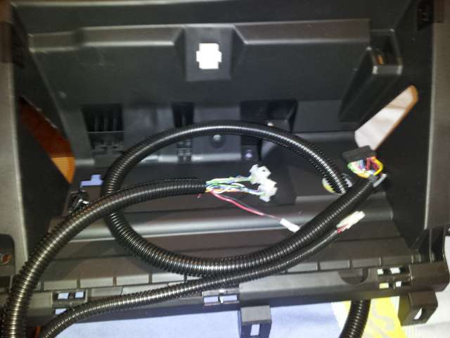

To install the J&S Safeguard I wanted to have it accessible yet out of the way so I picked the glove box as it is close the the ECU as well.
Then I wanted to have the wiring harness plug and play so that I could remove and go back to stock in a matter of minutes.
Here it is all installed. Close the glove box and everything is out of the way.
