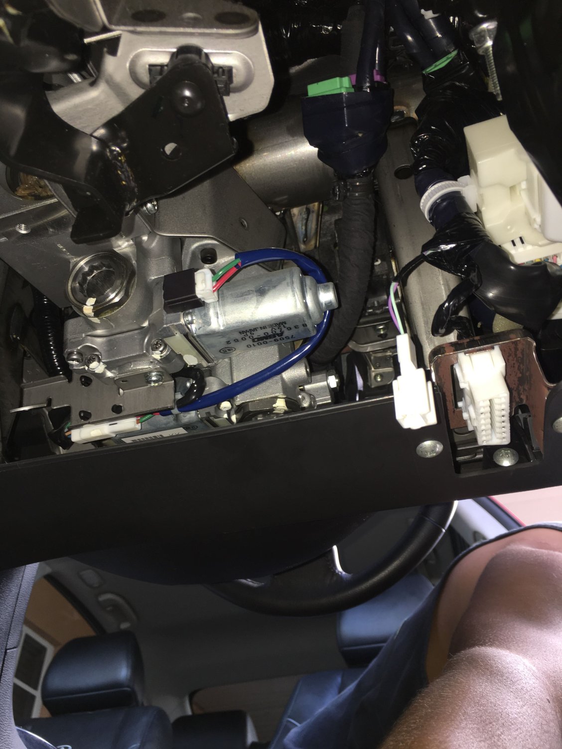

I just bought a 2013 G37x sedan - traded in my 2003 G35 coupe MT. The dealer put new tires on and the TPMS has been on. Thought this reset would work but I cant find the interface with the white wire, looks like I have a different connector. Did they change the interface for the 2013 or am I looking at the wrong thing? Thanks!
Connector

My 2013 has the same looking connector to the one you show, which is different than the one described in the beginning of the thread. There's no way I found to either reset the light or force the car into "relearn" mode.
I've got a set of winter tires and grew tired of the TPMS light glowing. I recently purchased a ATEQ QuickSet to program the car and it worked fine. It took a little futzing around with the computer to figure it out (load the newest drivers after installing the software). You'll have to make a visit or two to a tire place and if you politely ask them to read the TPMS id's on each wheel they'll do it. Have your cell phone handy to take a picture of the TPMS id's as they're scanning each one.
Brian

Thanks Brian, I was going nuts trying to find the connector. I see it at Tire Rack for $120, maybe I will do the same.
